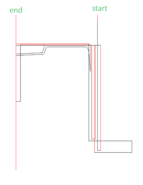

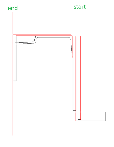

For my 2D CAD, I use a program called VersaCAD (first used DOS version in 1989 and currently using VCAD2004 for Windows). Many years ago I wrote a macro to convert hand-drawn lathe toolpaths to gcode. Red lines are rapids and black lines are cutting moves. An example is
which produces the gcode

M30
[edit: that lathe had manual spindle control–it was a CNC-converted Feeler 2d-op) so no M3/M5 commands.]
I’m between lathes now, so I actually haven’t used it for several years, but when I have my Taig ballscrew CNC lathe up and running I will be using it again.
I also wrote a corresponding macro for 2.5D milling (mostly for facing odd shapes, cutting out blanks, etc.) that uses the same conventions, except there the rapid moves have a retract and re-engage move. I used that with my Nomad.
