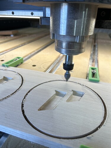

Ok my pocket cut good and my contour was good. I posted pics of my vcarve and stock set up
So I got it to work but I had to set the starting height to .05" with a final cut depth of .2" not sure what is going on but i did post pic of my stock set up and vbit set up. I am using a bitsetter and bit zero. I zeroed the work piece and not the waist board
