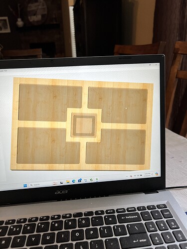

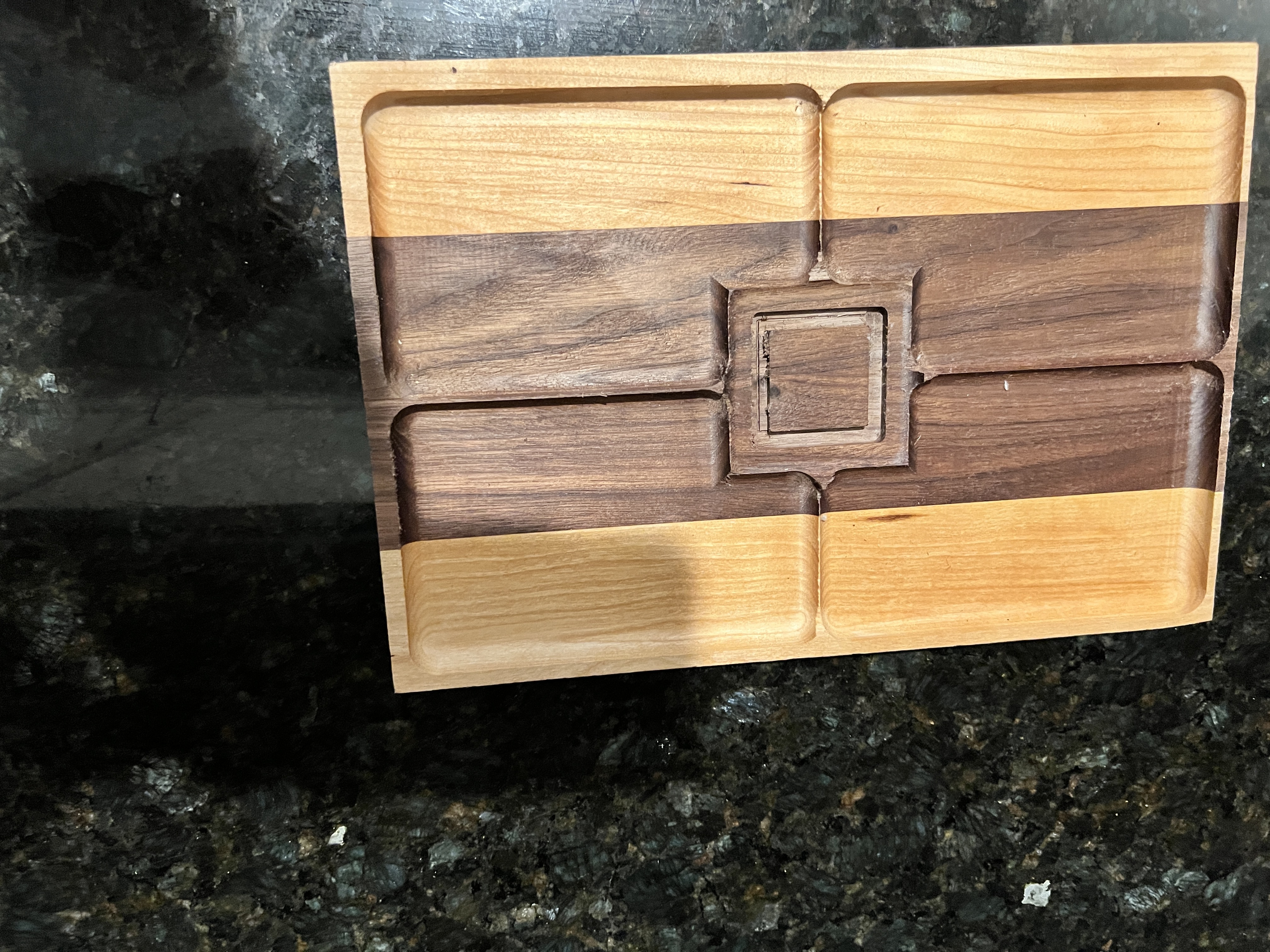

Anyone know why my bowl bit cuts out a bigger pocket than I created in my design? There is suppose to be 1/2” between pockets.
Can you send the C2D file so we can check it out for you?
Also post a screen grab showing how you defined the tool?
Could you have mixed up radius and diameter when defining it?
How as the 3/4" Bowl Bit defined?
Post a screen-grab of the Tool Edit window.
That was it. It was set at 1/4" instead of 3/4". So that makes sense. I appreciate it.
