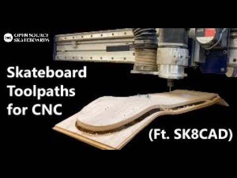

Here is the YT video of what I am trying to accomplish. You can jump to about the 15min mark. I would like to cut out the shape of skateboards. I have been able to cut them with 2d contour, but 95% of the job is just cutting through air.
You will need to map/probe the 3D surface to do this in Carbide Create. The alternative would be probing the surface and distorting the file to match. See auto-leveling in bCNC
