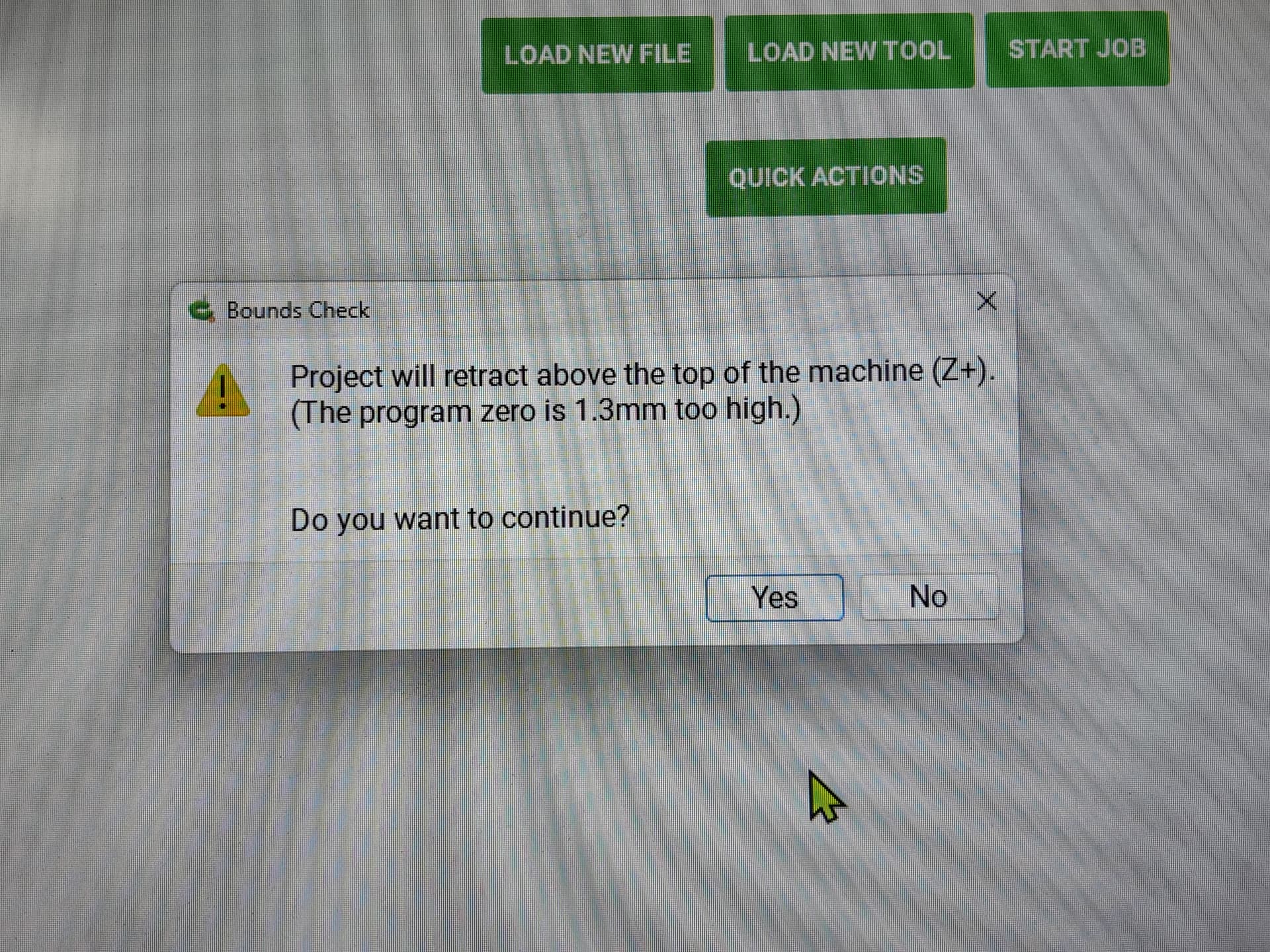

Project will retract above the top of the machine (Z+). ( The program zero is 1.3 mm too high)

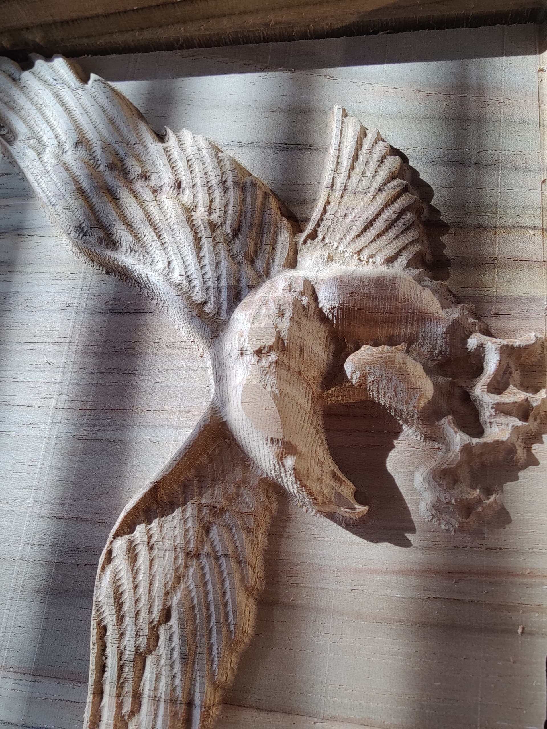

I have Pro 5 and I downloaded the Eagle from Cut-Rocket. I’m getting this message and a small flat spot on top of the eagle. any ideas would be greatly appreciated on how to fix this issue.
Is your material the same thickness as the material in the file? ie 1.033" or 26.24mm
no it is not is that why I am getting a flat spot?
This is a warning as noted at:
Usually it is caused by a mismatch between job setup:
and how origin is set relative to the stock:
I find that opening the .c2d file up and drawing a box which matches the specified dimensions (draw up the cut in profile if need be) or moving the machine to the origin and then using a tape measure to measure out the dimension(s) in question will make clear where things aren’t lining up.

The flat areas are caused by the design being raised above the surface of the material and therefor not being cut. 3D preview should show those areas in red. If your material is less than the 1" material called out in the file then you will get flat spots.
Got it thank you Jeff I will try running it at the set depth and not do the outline cut here.
