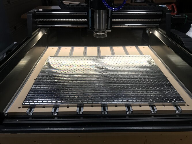

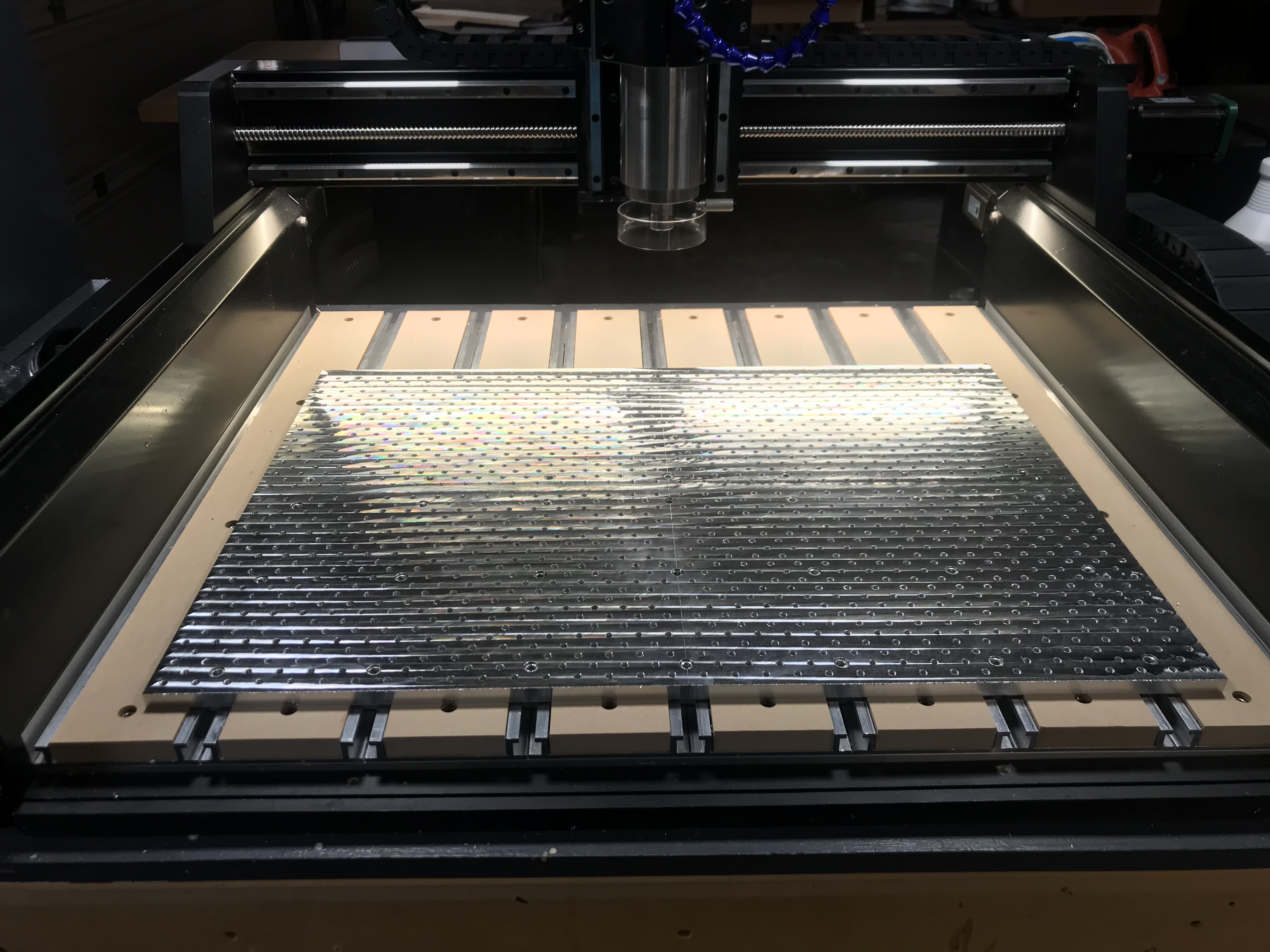

Keep going with the aluminum and bill it as a cribbage board that doubles and a personal defense weapon.
At least finish it… But yeah, you could do a V2 that was lighter as well. Or (I know this is crazy, but…) you could do one that is half & half. I’ld do the playing surface (with the holes) wood, and the bottom (storage part) out of aluminum (but that is just me, keep the CG low with the heavier pc on the bottom).
milling all those 1/8" holes in aluminum scares me haha
I’m 100% behind over-building projects just for the sake of it. I say continue with the aluminum one, but take a page from @wmoy and ISO grid the heck out of it.
To change a saying I like by Colin Chapman to fit my uses here: “Complexify and then add lightness”
Don’t fear the unknown, embrace it!
About 1400 holes as I recall.
