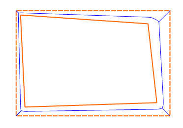

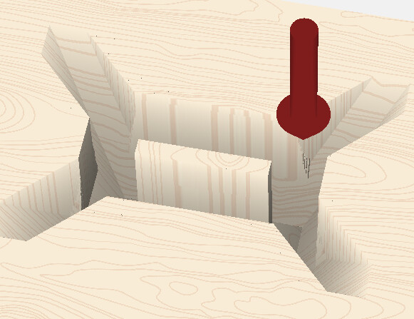

To clarify, if the tool can fit, it will cut as deep as you ask. Here’s a larger rectangle V-carved with no clearing bit to 1.5" deep. It calculates it as if you had a 2" diameter tool, but simulates it with the 1/2" dia tool.
So you would want to limit it in this case to the depth you want.
If the vectors are narrow enough, the tool will cut to the depth needed to fit between the vectors.

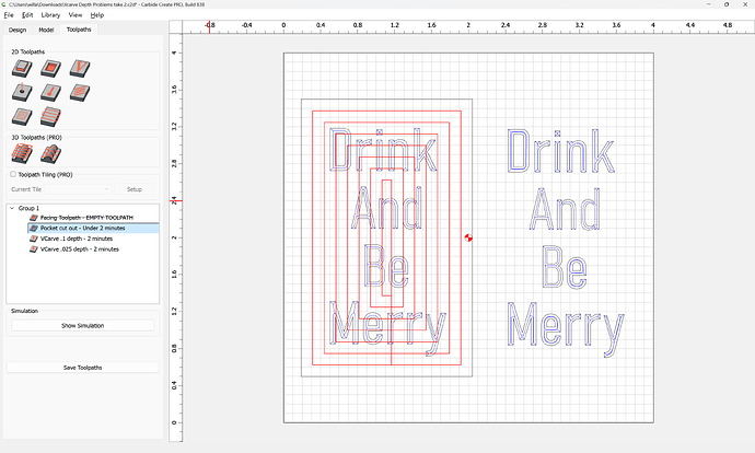

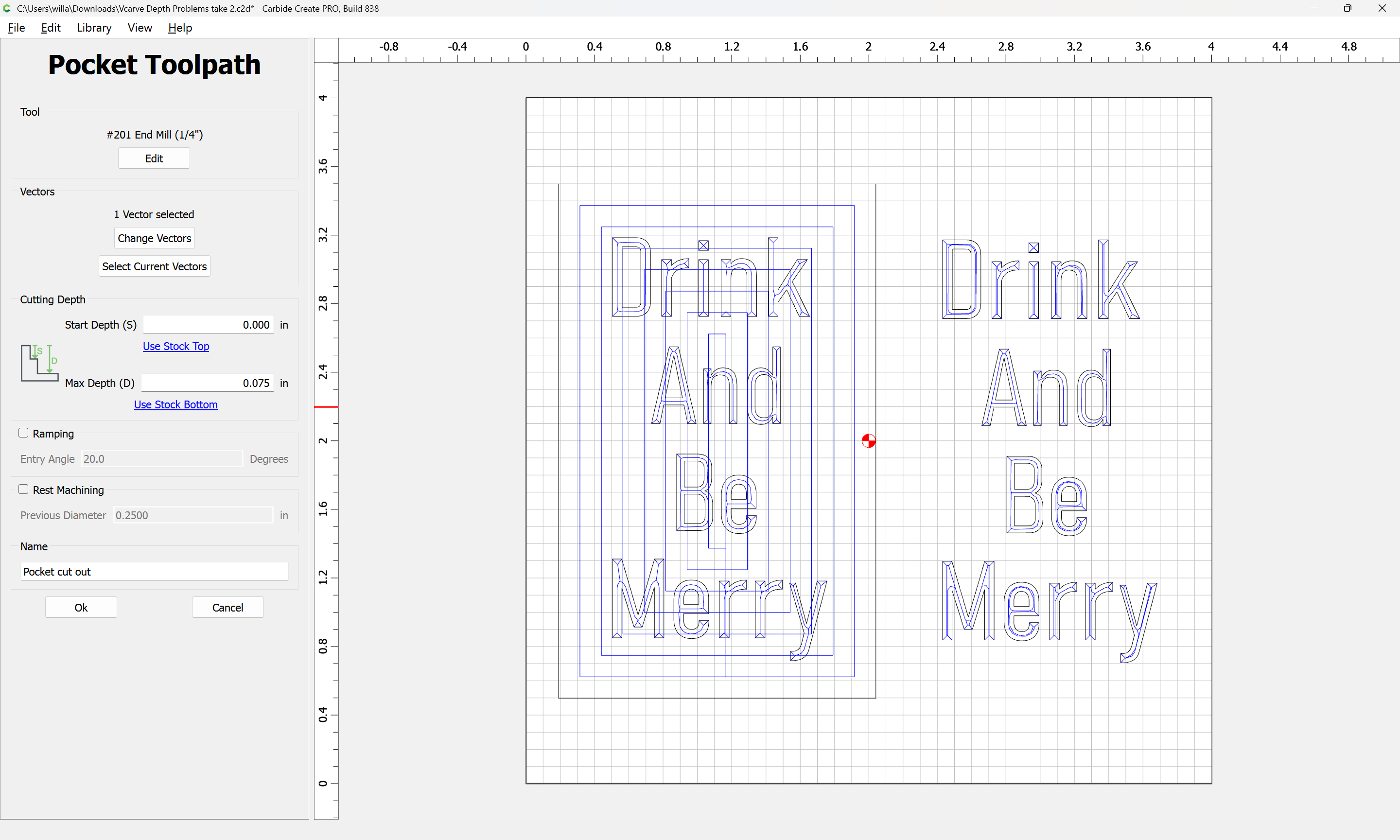

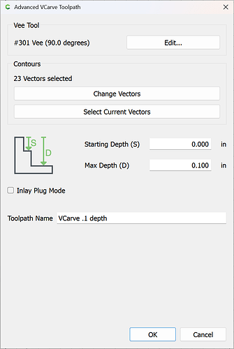

For the file you posted:

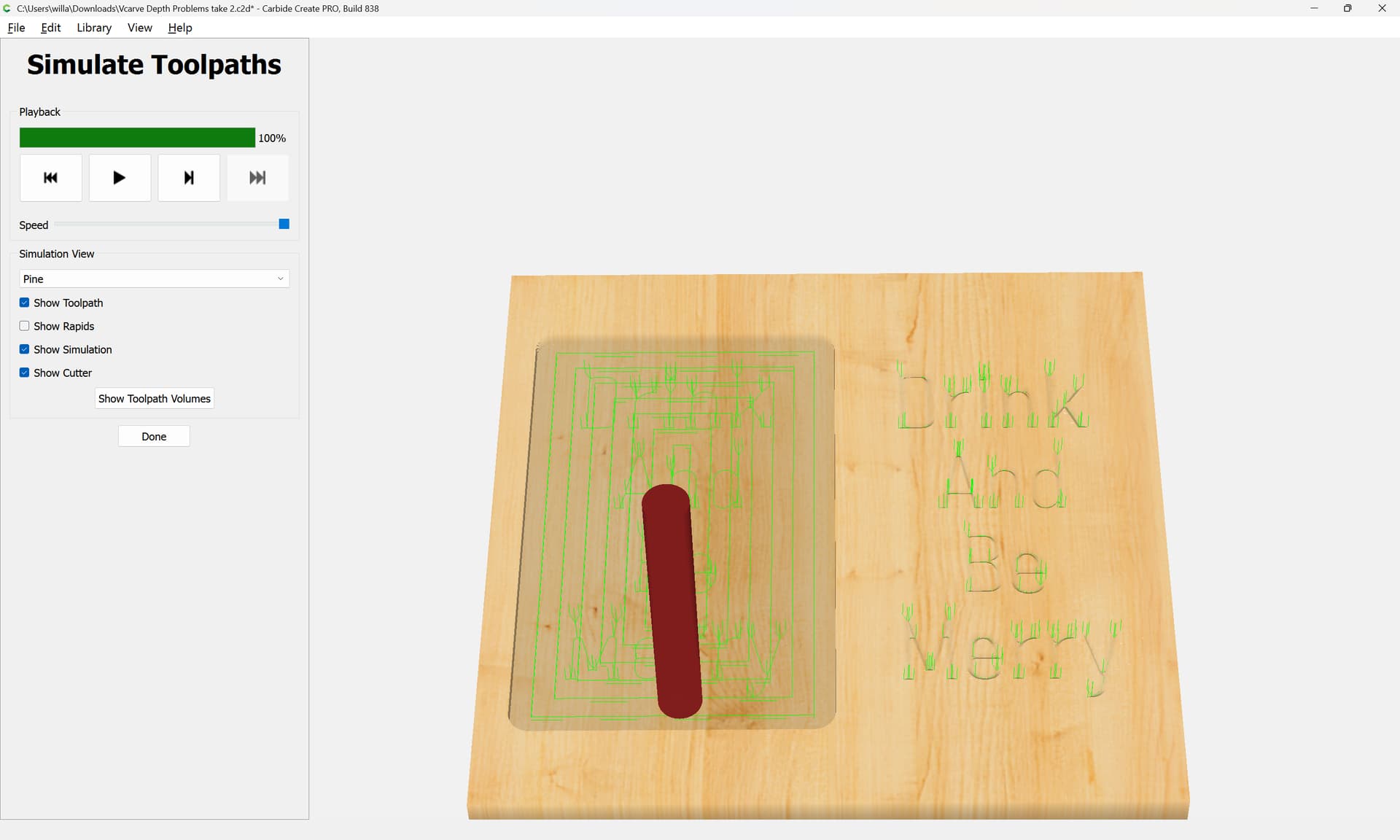

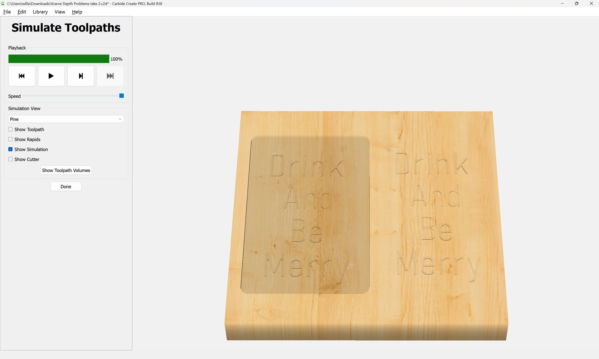

The V carve toolpath on the left only cuts to a depth of 0.1":

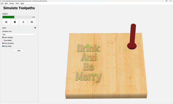

so it is cut:

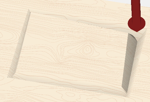

and then removed by the pocket

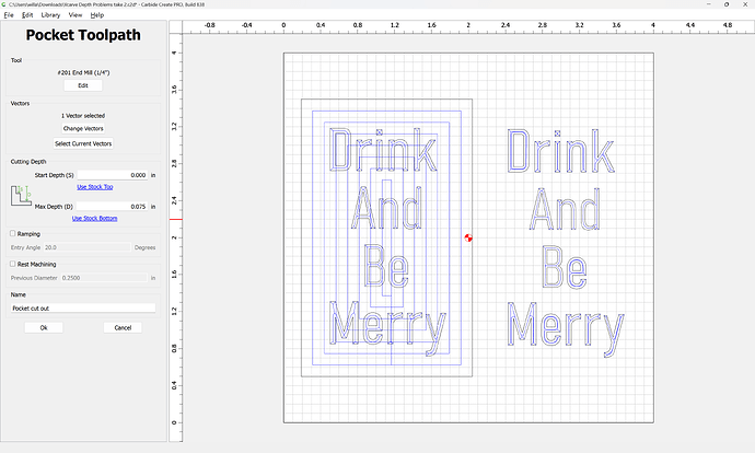

which cuts to a depth of 0.075":

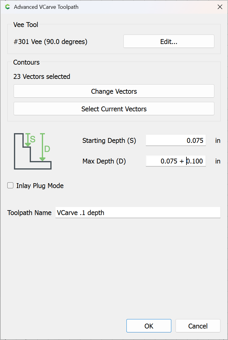

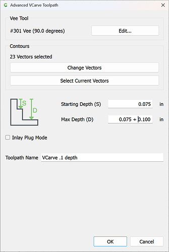

If you instead start that V carving at the bottom of that pocket:

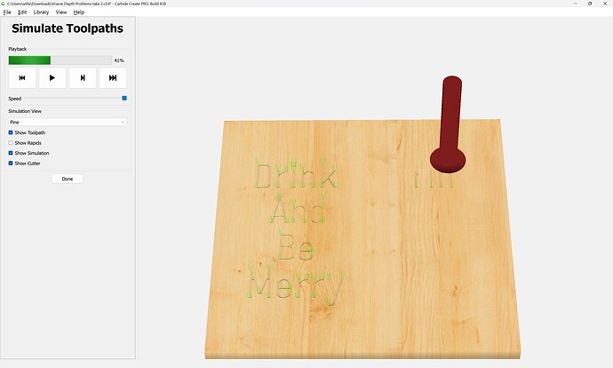

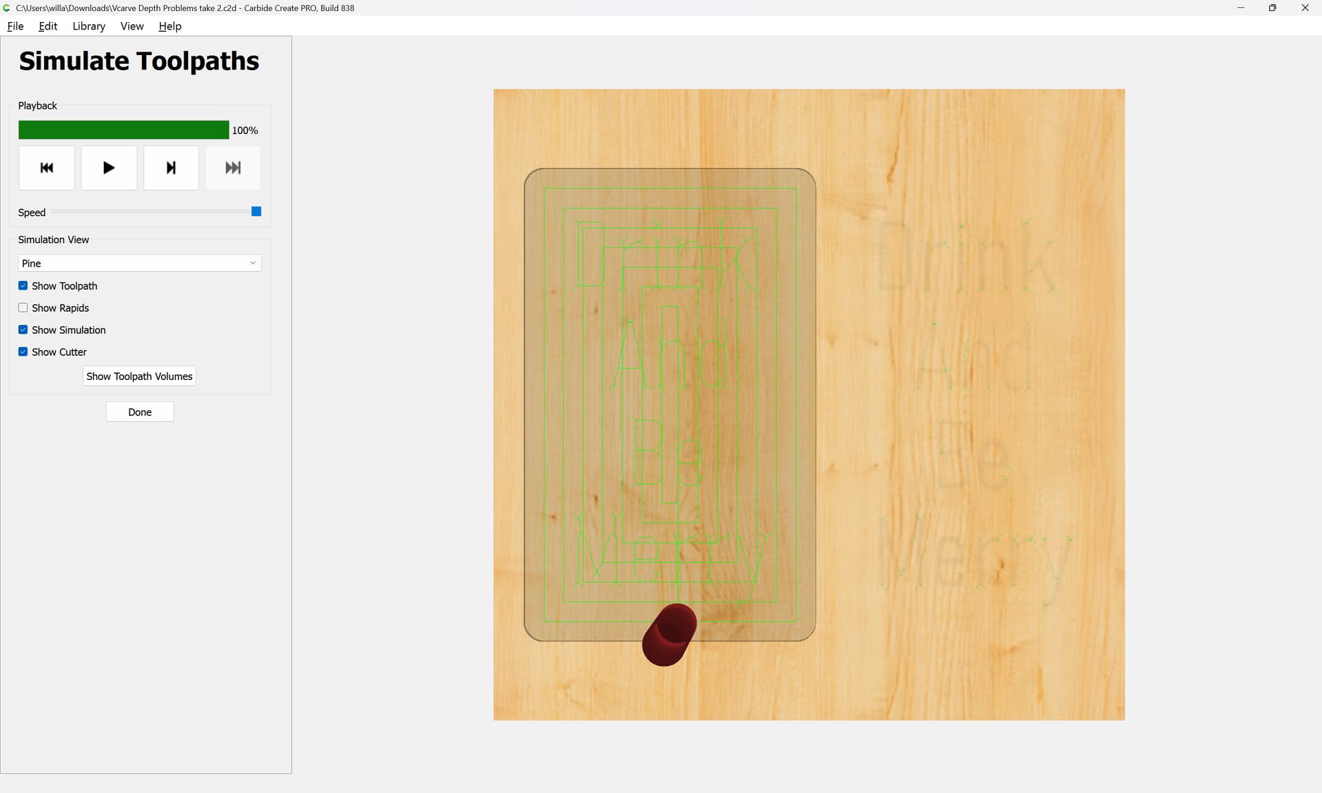

while the cutting will initially seem wrong:
at the end, it is as-expected:

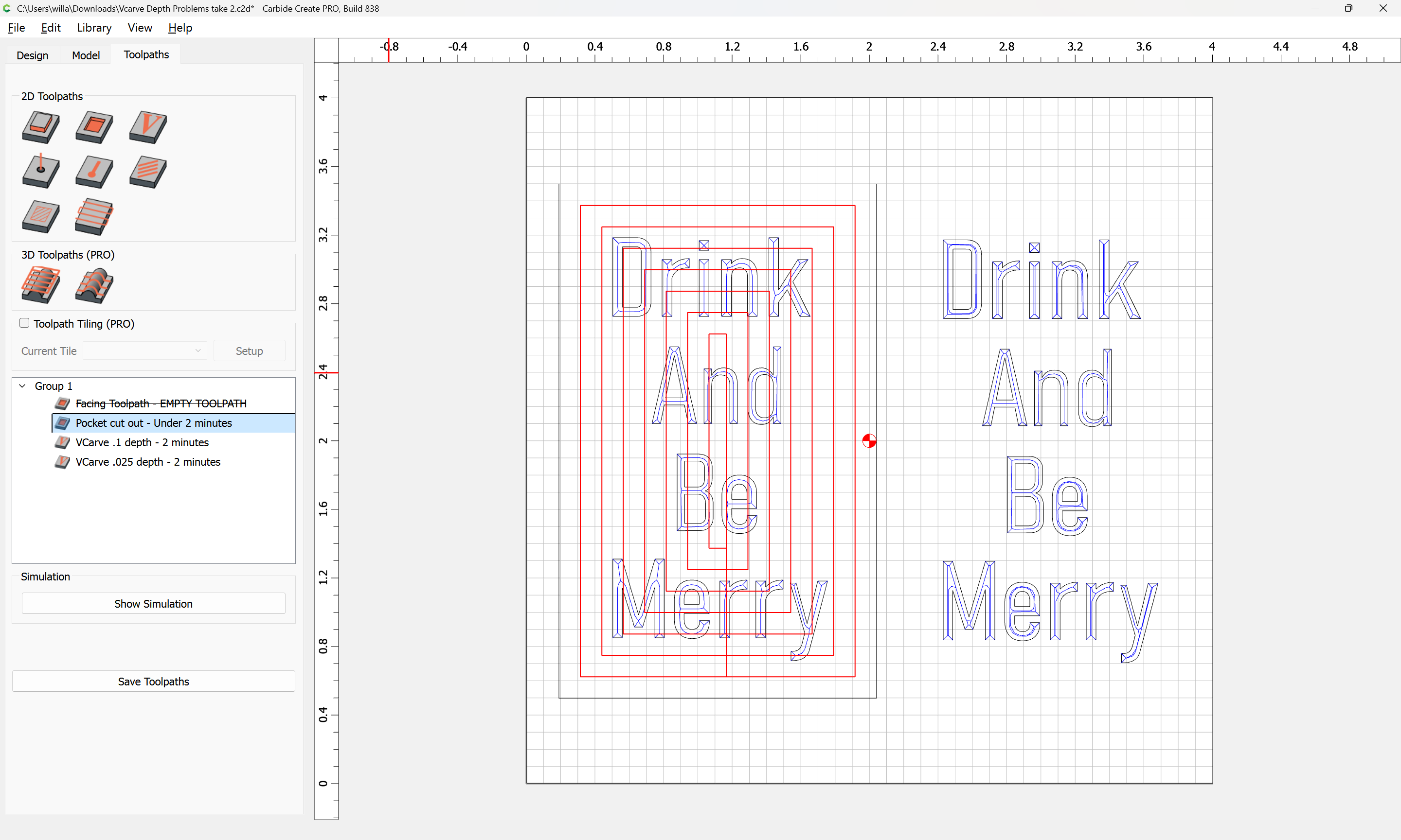

Naturally, the toolpath ordering should be:
