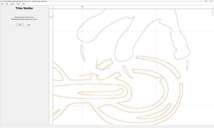

New User here so I’m sure this is an easy fix…Not for me. I want to make it look like the eagle is clutching the chain. When I “trim vectors” I get the look I want. However, the line then turns purple which I believe means there is an open vector. I can’t seem to figure out how to fix that. Hoping for some help. Thanks
Right now the magenta vector is grouped with a bunch of closed vectors. Ungroup them, select ONLY the magenta, and it will now close (using the ‘Join Vectors’ command).

Select the overlapping geometry and decide what will be in front (middle claw), and what will be in back (left/right claw):

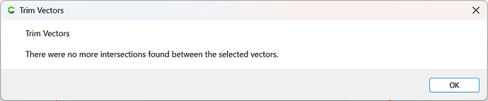

and use Trim Vectors to remove what is not wanted:
Repeating until one arrives at:
OK

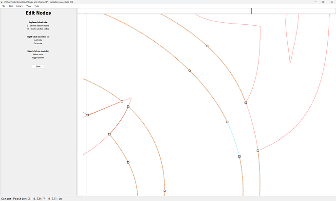

Do so using the Curve tool:
Use Node Editing to remove what is not wanted:
Then join things together:
Repeat until one arrives at:
