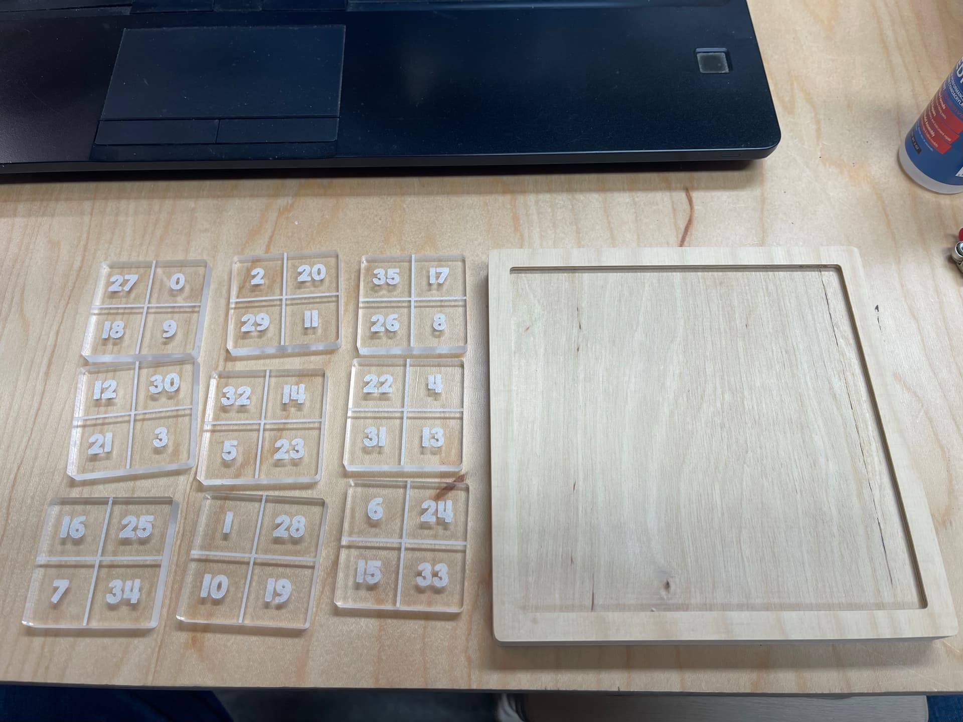

Inspired by @StephenCox here, I decided to try my hand at a few little puzzles. I thought they came out rather nicely, and they’re fun to make.
I have some ideas for a few more - and might just continue it as a series, all using the same size base.

Very well done nice adaptation to the new design Six numbers instead of four it’s gonna be a bugger to solve
I love the hexagon puzzle simple but that will keep you busy for hours
Thank you! I’m rather proud of how it turned out.
In actuality, the number combinations that happen when you lay them out eliminate a lot of possibilities as you go. It’s important to have a process. If you just match numbers at random, you’ll have a random amount of success, and I can imagine it taking a long time.
If you run through a method - such as starting every tile in the top spot with a specific number consistently facing the center tile, you’ll eliminate some layouts right away as you work towards the solution.
I too was worried that it would be impossible. And while it’s definitely not easy, it’s not as hard as you’d think. Solved it several times now in under ten minutes.
Making sets right now. Great Idea. Thanks for passing it along.
I’ve made another one based on a magic square. There are 9 tiles, and they have to be arranged in a way such that all rows and columns add up to the same number.
Wow and I am crying to finish the hexagon. My 3 year old grandson finish the shapes for me.
Yeah there’s a bit of a learning curve between the three so far. I think this one is slightly easier than the hexes, but both number puzzles are on the harder side. I find this one to be a bit harder than medium.
I think I’m done with numbers for now, and the next one will be a “parking lot style” sliding puzzle.

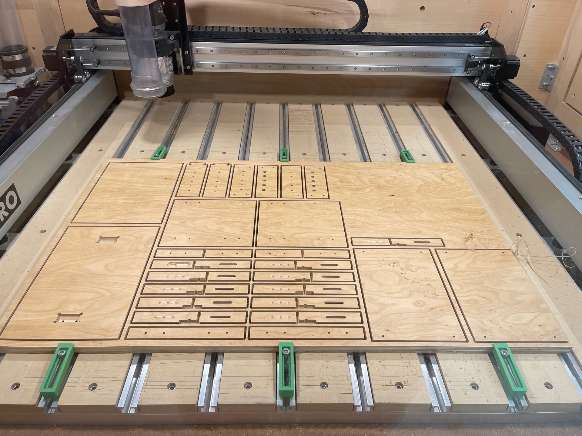

This style of puzzle box has been floating around on the internet for a while, but I drew one out that I could cut with the shapeoko. When I have time I’ll smooth it out a bit, and sink the screws, and add some clues. Came out ok.

Finished the puzzle box. Eased all the edges, made a ton of mechanical and tolerance adjustments, redid the ball-bearing detent, and redid the lid entirely. Finished except for waxing the edges, but very happy with how the keys feel, they click into place in a satisfying way. Thrilled with the final puzzle.
Not great with making video but here’s the solve.
Follow this link because the embedded player on the forum seems to be broken
Some finished photos plus what the initial cutout looked like (not including the two plexi pieces, and the lid and handle assemblies that were recut later)
