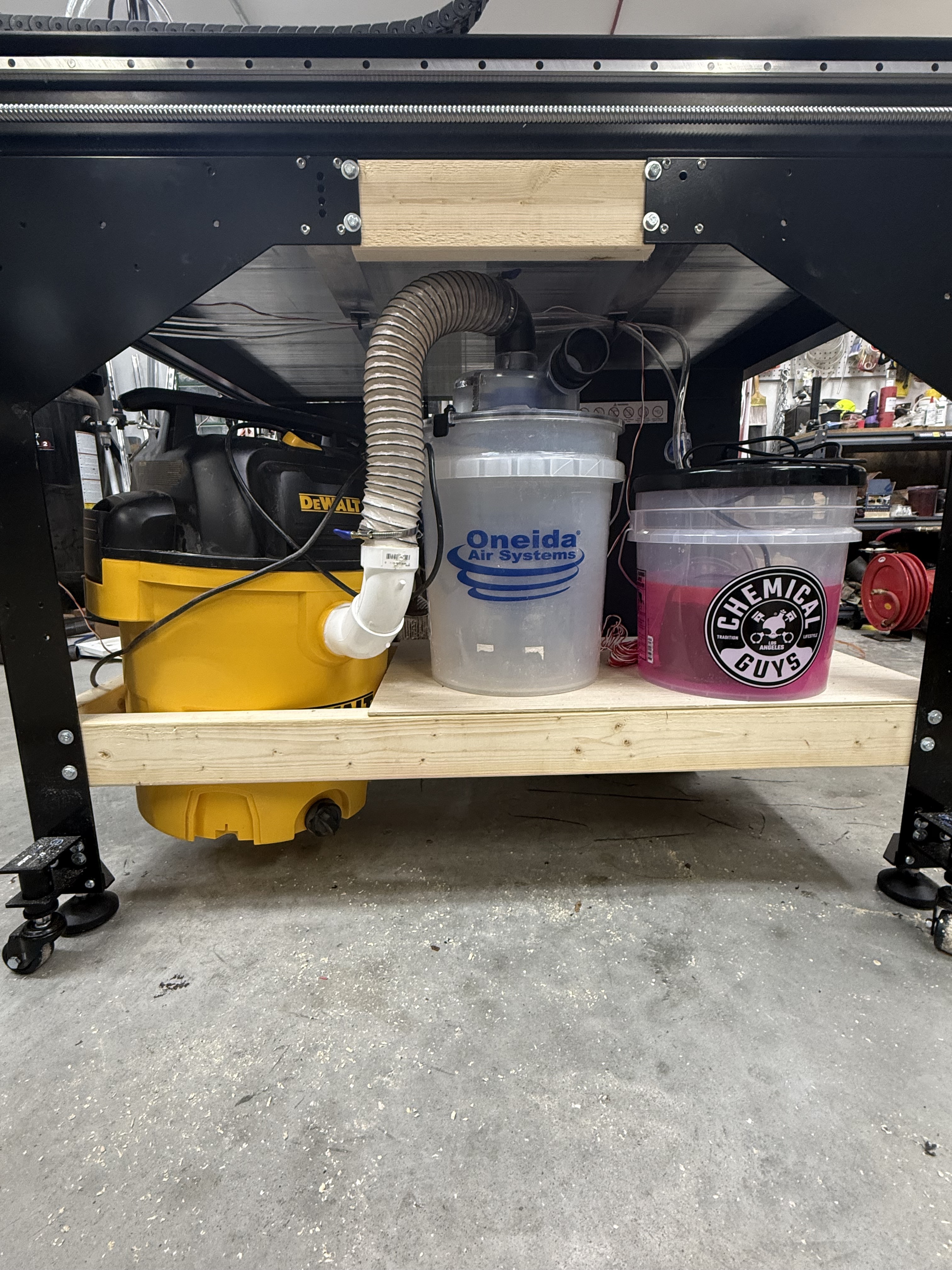

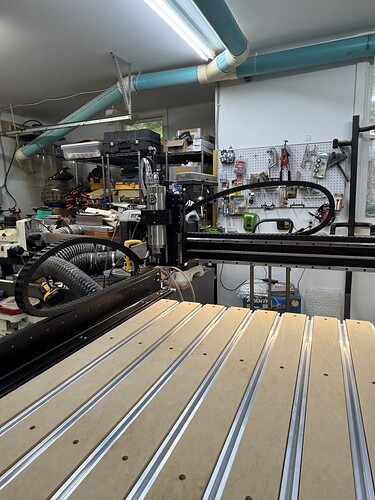

    I had mine for a year or so and didn’t run it hard. It’s beefy. I am sure equivalent to the one from C3D. I would recommend the water cooled one though. It’s not really much more. I use a bucket filled with RV antifreeze and a pond pump rather than a chiller. My shop is climate controlled and that is really enough. I got their Superthane tubing and Koolance connectors. The tubing is quite a challenge to get into the drag chains. I will put a picture below showing the radius on the chains with the tubes installed. The water cooled ones are quieter and prevent any dust intrusion in the system.

This shows the drag chains
This shows my bucket setup for cooling. I have not fired this one up yet, still configuring things.

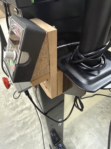

With their spindle the control panel is relocatable. You can pop it out and position it somewhere not convenient. You need to order a mount and cable from them. I rigged mine up like this:
The mount from them is the black piece surrounding the control. The MDF is my hack job.
