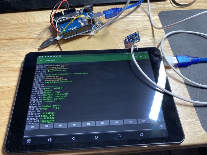

Life got in the way a little bit, but I made some headway in the vibration characterization department. Accelerometer seems to be working OK, but still working on the FFT analysis piece. Data capture even works out pretty spiffy on an android tablet with serial terminal, so I can go mobile.
Maybe I’ll get some time this weekend to work on the unbalanced motor exciter to characterize resonance sweeps. If that approach sucks, I’ll just look at frequency response as it cuts. So far I’m about $30 into the experiment with the ADXL345.
Immediate need is to 3D print or cut out a mounting plate for the accelerometer so that I can screw it into the threaded inserts on the table (and the threaded holes on the aluminum when the time comes). Unfortunately, my F360 startup subscription ended, so I need to wait 10 days(!!) for them to review and hopefully reinstate.

Wouldn’t you want to mount the accelerometer on the spindle since the excitation forces originate there and at the endmill? Wouldn’t varying the spindle speed and number of flutes on the endmill while cutting provide the required excitation frequency sweep range? Wouldn’t varying the MRR and workpiece vary the excitation forces?
There’s probably merit to both approaches.
I was more fixated on how astonishingly bad the bed resonance seems to be on the XXL. But wheels and linear rails would probably impact spindle resonance more. Extrusion fills strike me as more of a bed resonance impact, but that I can’t say immediately says…
FINE ILL MAKE ANOTHER MOUNT.
We’ll get through this together.
