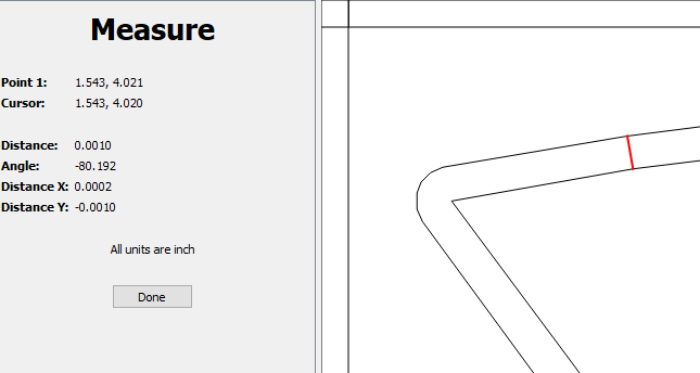

I have a file that I need to offset a vector by .001. I have no idea how to do this but would like to learn for future issues. I am new to all this and only have CCV7. Can it be done?
Sure it can.
Select the vector
Select “Offset Vector”
Enter the distance & direction
Apply
Zoom way in to see the offset
