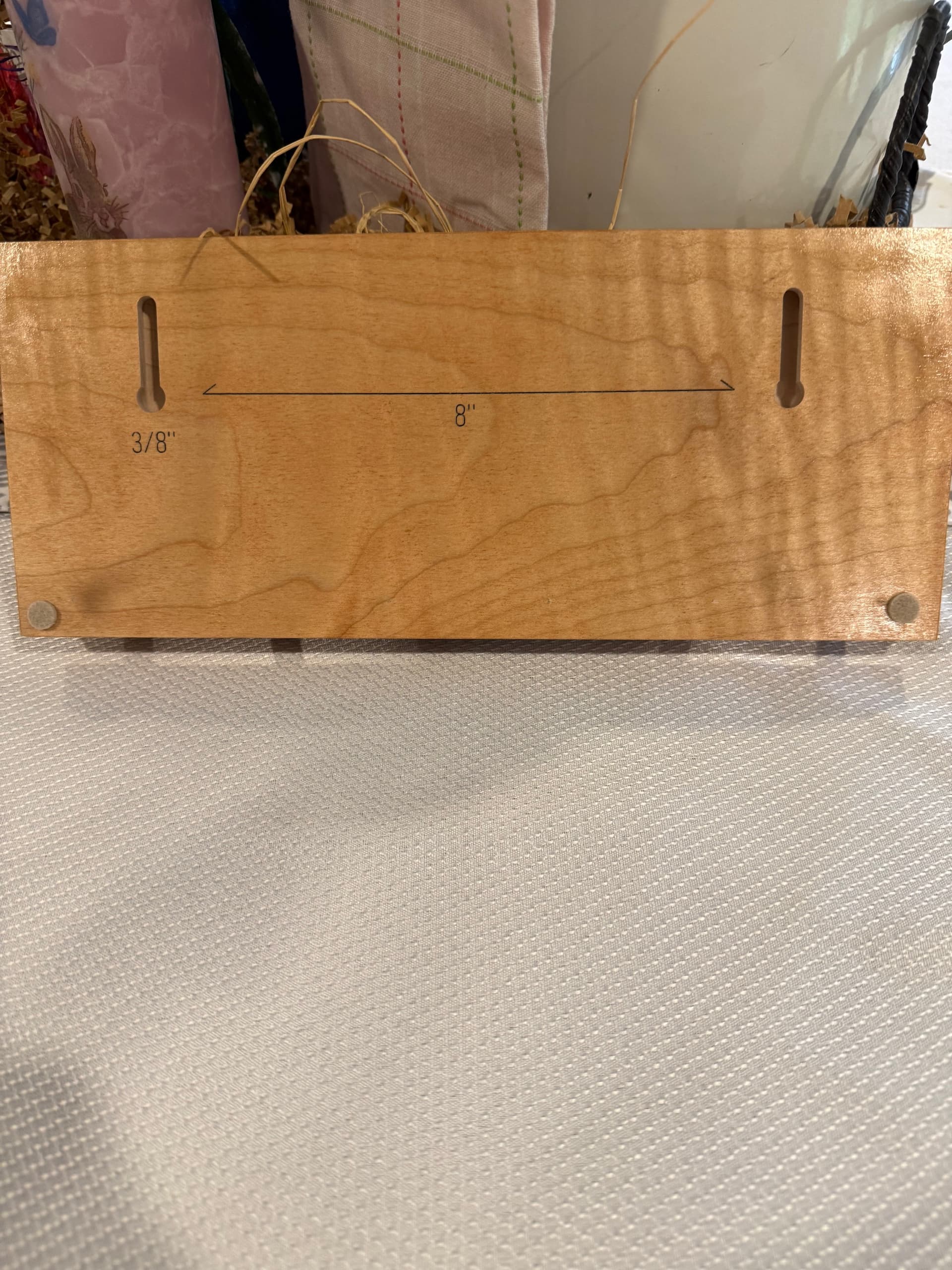

I’m in the process of designing a magnetic knife holder for a neighbor. I initially thought I would cut keyholes on the backside to use to anchor it to the wall, but since I can’t carve out the backside of the slot for the anchor/screw head to slide/lock-into I may need another solution. OR, does the whole piece need to be tapped down to force the screw heads to dig into the channel?
Does anyone have a recommendation on how to use keyholes for this purpose?
Another thought was to carve a horizontal channel that would fit to a reciprocal rail that could be more easily be mounted to the wall, but screws or dowels would be needed at the top and bottom to hold the pieces together.

As you said the keyhole may not be the best bet. Since you have sharp knives you dont want them pulling the mount off the wall while pulling a knife from the magnetic block. Knocking the mount down on top of the screw heads would not work because there is nothing to keep the block from wiggling and eventually loosening the knife block.
Your best bet would be a dovetail piece you can anchor to the wall and then slide the knife holder in from the side. A french cleat is similar to a dovetail but has the same danger of lifting off the wall as keyholes.
A female dovetail in back of the knife holder with the magnet imbeded in that piece.
Thanks @gdon_2003, that’s kind of what I was thinking with the channel and rail idea (without the angled notch to lock it in), but I don’t know how I would cut the dovetail in the back of the holder, unless I attempted it by hand. I probably have a dovetail router bit in my bag and never really thought about setting it up as a tool for the CNC (presumably unsupported, like the roundover etc).

I think if you use a wall anchor with the correct head size which I believe is 3/8" for the keyhole bit, the knife holder would hold just fine. Most of the ones you buy on the market use key holes and some even add double sided sticky tape to create extra holding power.
It does seem like the easier approach and something I should be able to do anyway, so looks like new tool time.

I recently made a ket chain holder for the neighbors and use the keyhole method. I engraved the dimensions on the back to help them with alignment.
I think you may have posted this or something else similar, because I remember seeing the dimensions carved on the back and thinking how clever and helpful that was. Really good idea! Thanks again!

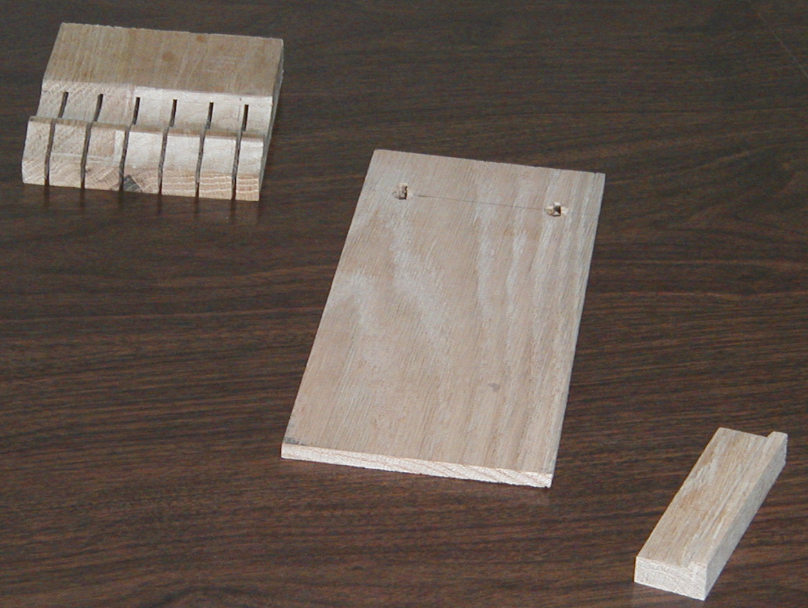

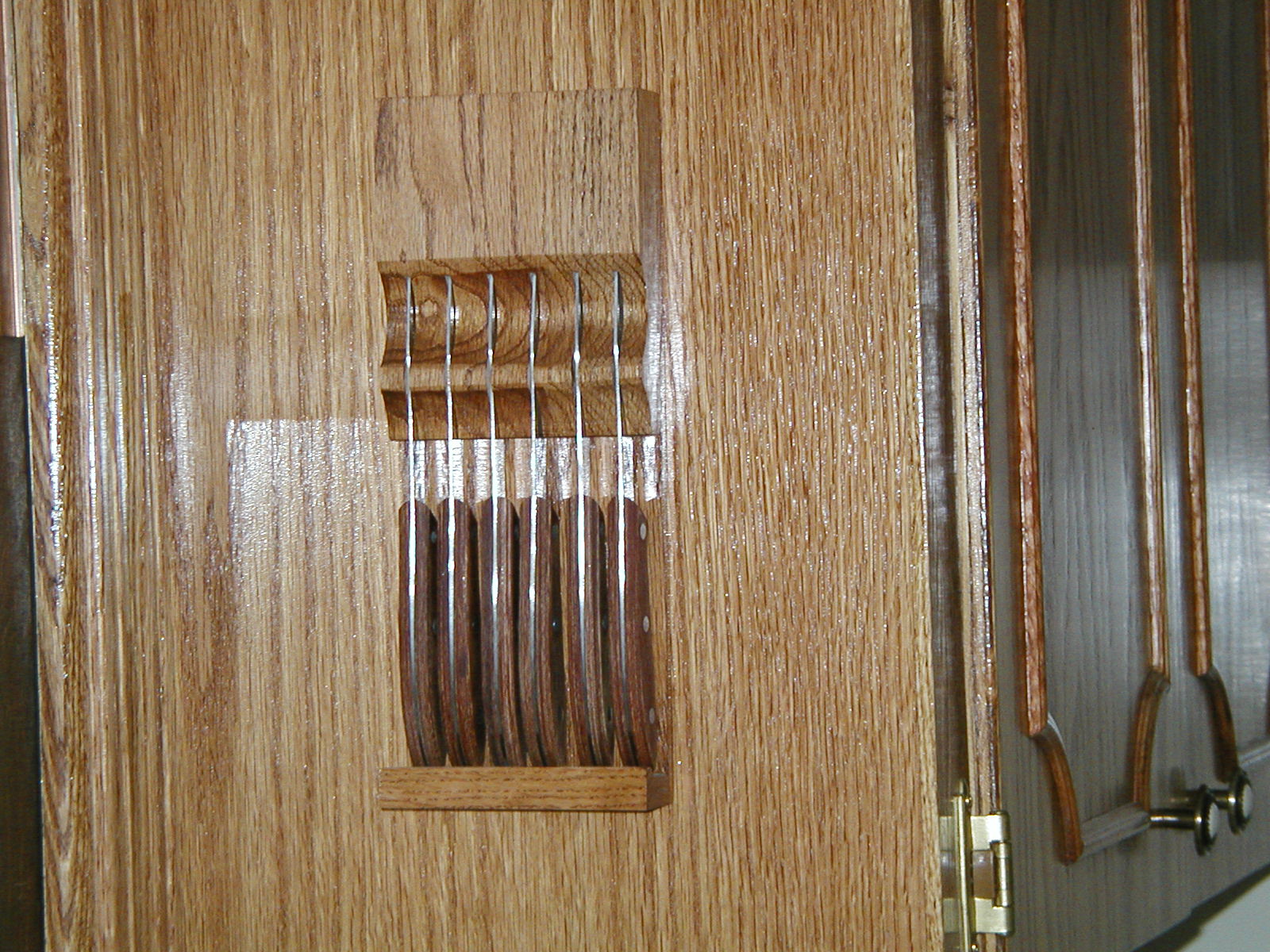

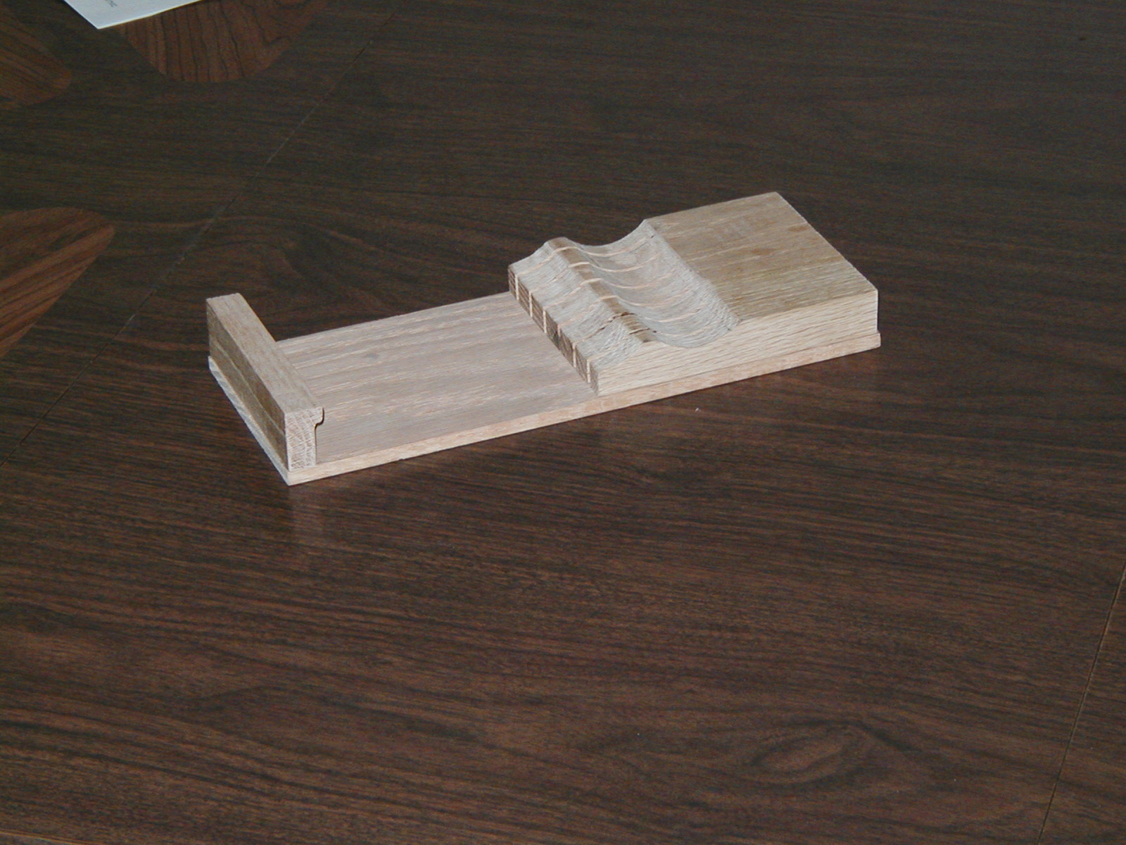

I used keyhole slots to make this three piece steak knife holder. Pre CNC :slight_smile:
It has been on the side of our kitchen cupboard for over 20 years and except for the couple of times when we applied a new finish to the cupboards or installed new curtains it has stayed put.

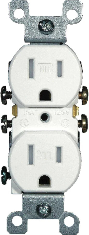

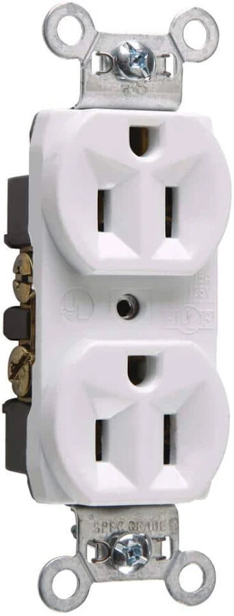

Electrical outlets can be oriented with the ground up or down. There is no NEC rule for either orientation. When I did my electrical in my house I have the ground pointed up. My thinking is if something slides down on something plugged up hopefully it will hit the ground and not short out the hot and neutral.

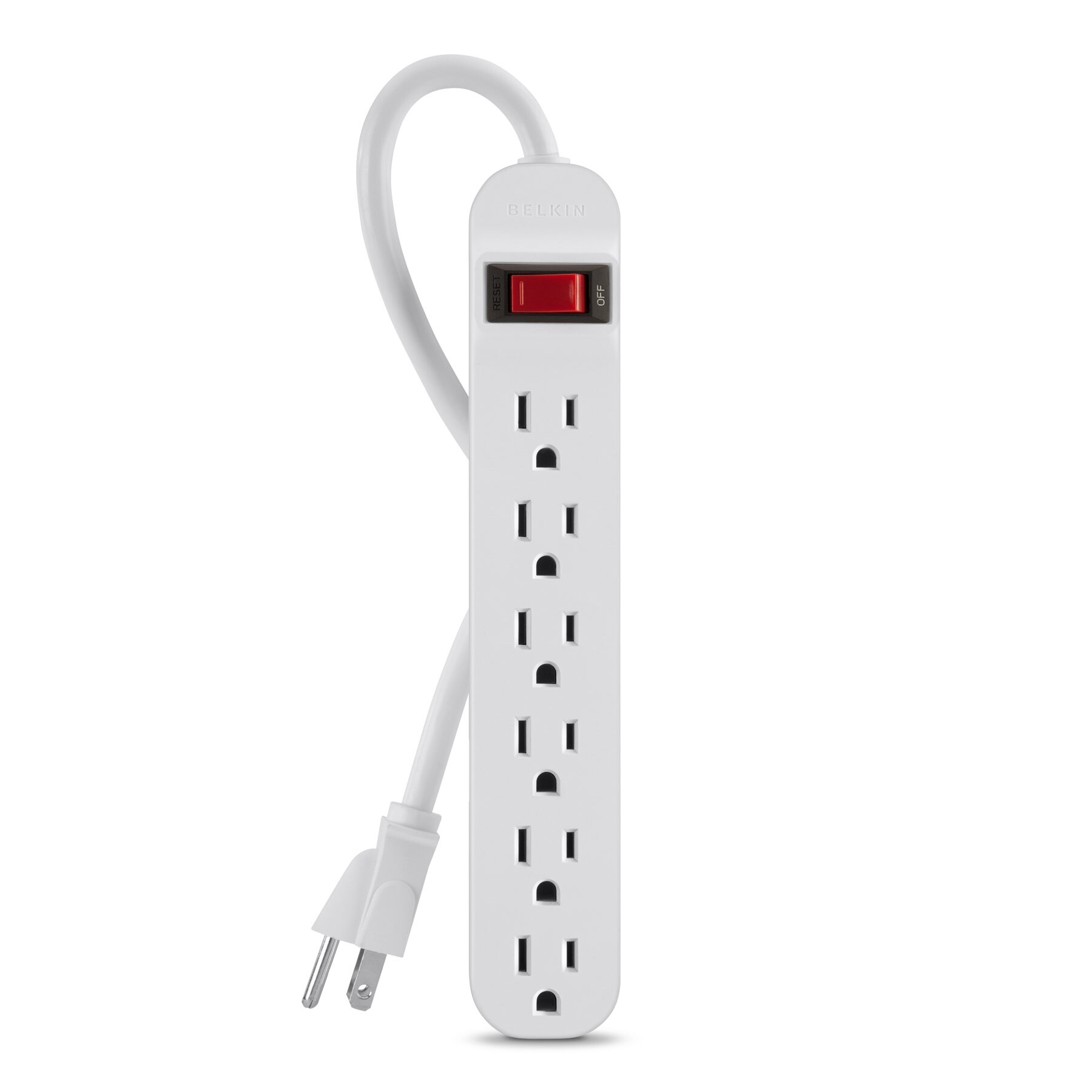

The last electrical power strip I bought I picked one that the electrical plugins were oriented so things plugged in were oriented up because some plugs or transformers dont fit well with the outlets in a horizontal orientation.
These orientations get crowded with little transformers.
An Electrician who did some work for us outside recommend the very same thing; ground connection at the top.
And, since we’ve drifted off topic a already…

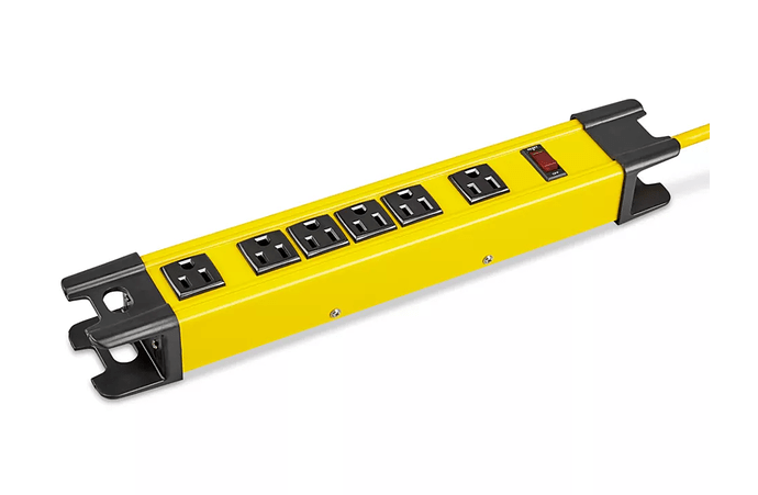

A pet peeve of mine is the orientation of the outlet on the white power strip you included or at least the size and shape of the transformer plugs. A 6-port strip effectively becomes a 3-port strip. < /ragemoment >
