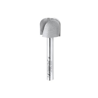

They do sell bowl making bits you could do by hand or in the cnc (if you remove the bearing or get one with no bearing)

The only straight-forward trick in Carbide Create would be to use a suitably-sized ball-nosed endmill — alternately, if the part geometry allows, @ItsDan’s suggestion of a bearing-guided bowl-making router bit is a good one for doing it by hand.
I’d probably rough out most of the shape with a 1/4" mill then do a final pass with something like this if I wanted to keep it all on the s3.
I have used a Freud 5/8" Round Nose Bit on my SO3 for making marble pockets for 5/8" Marbles from Moon Marble Company for Chinese checkers, Halatafl and “The Marble Game” boards as well as a finger groove for the peg pocket for my cribbage boards. I run it slow (like 10 IPM) and 18K RPM. I am sure I could run it faster, but I am a baby and I don’t want to find out what happens when I do.
