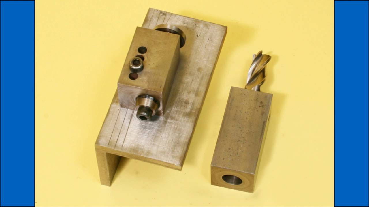

I too have had success with cheap end mills but I’ll be darned if I can sharpen them. Maybe a tutorial Rich?
I made/built this:
From this guy:
And mounted it to a Diamond wheel since I am using carbide endmills…added a Hex adapter, so I can also sharpen 3 Flute Carbide3D (style) 201 cutters.
HOWEVER… If I am cutting steel (Usually roughing out a part for the lathe) the tips of my $1.00 1/8 2-flute endmills will lightly dull the tips…and Since I am only roughing…I will sharpen them by hand…they are usually NOT very pretty, but for roughing steel…they just need to remove that tiny dull spot to be re-introduced into the roughing end mill queue. (Like touching up the tip of a dull drill bit). THIS is more an art than a science. Time, patience, a GOOD pair of 3.50 reading glasses…Like getting to Carnegie Hall…practice…practice…practice…
My end mill (only sharpens the bottom) sharpener.

I sharpen my V-Bits (as well as drills & end mills) freehand. I don’t have a cutter jig.
For a V-Bit, you can see (in good light with the right angle) that the backside of the cutting edge will get worn, almost like a really tiny fillet/round. I’ve swiped the back edge with a sharpie just to see it better. (sorry pic is a bit blurry, but you’ll see it in good light, with the appropriate vision correction as Rich mentions
align the cutting edge up with your stone, and roll forward until the edge touches the stone. You want to make sure you are riding the cutting edge on the stone. You can roll forward just a tiny bit more, but not much 0.5° - 1°.
Then just sharpen & check the edge until the tiny fillet/round is gone.
