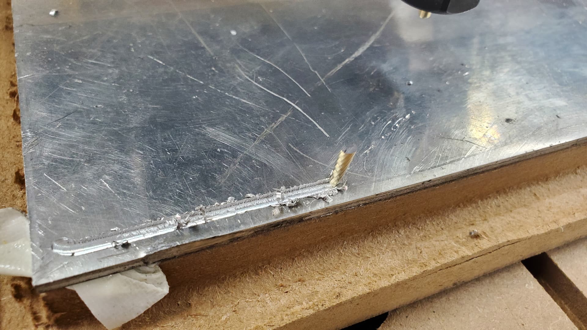

Well, my first cut didn’t start off too well. I used these settings for the 274 bit but seconds into it the bit snapped. Perhaps this material is too industrial for my application? I have no idea what type of aluminum this is. I’m using an 1/8" bit on 1/8" thick material.

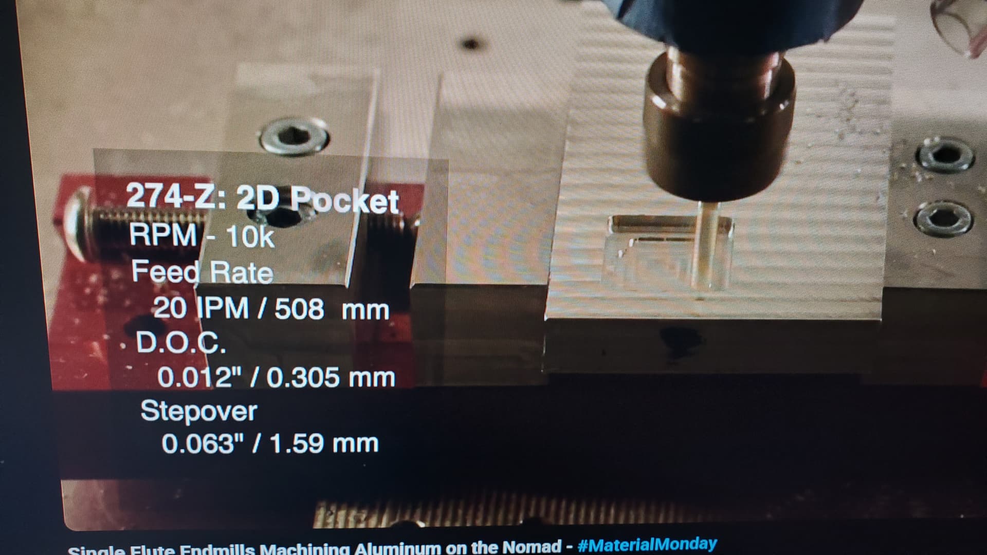

Our recommended feeds and speeds for aluminum w/ a #274 are:
Ramping in will help if you have Carbide Create Pro — check to make sure which alloy you are cutting.

Probably just the photo but it looks like much more than a 0.012 DOC?
If it were me not knowing the material source i would have halved the DOC you listed to start with. It’s always easier to increase F/S’s after you know what the cut looks like, the spindle sounds like, before you break a bit.
Material looks soft and not clearing the bit very well.

So it looks like, when I convert from mm to in, my cut was a little too deep (0.31mm) and and rpm was a lot lower (10,000) than the speeds and feeds shown above. For reference, I was using a Carbide video from 6 years ago for the Nomad. I think the combination of too deep and the material machining quality seems to be the problem (concluding this after I watched this video by Winston https://youtu.be/rm-qSytjFnI?si=sbQ9lgX5qnsL92RO). Looks like I’ll have to see if my coworker friend can get me some better material? I purchased two bits so hopefully I can make it work with a 2nd try. He’s willing to at least pay for supplies. I’m not sure I’ll charge him much in the end because I was wanting to help out his son (my son is in robotics as well, at a different school).

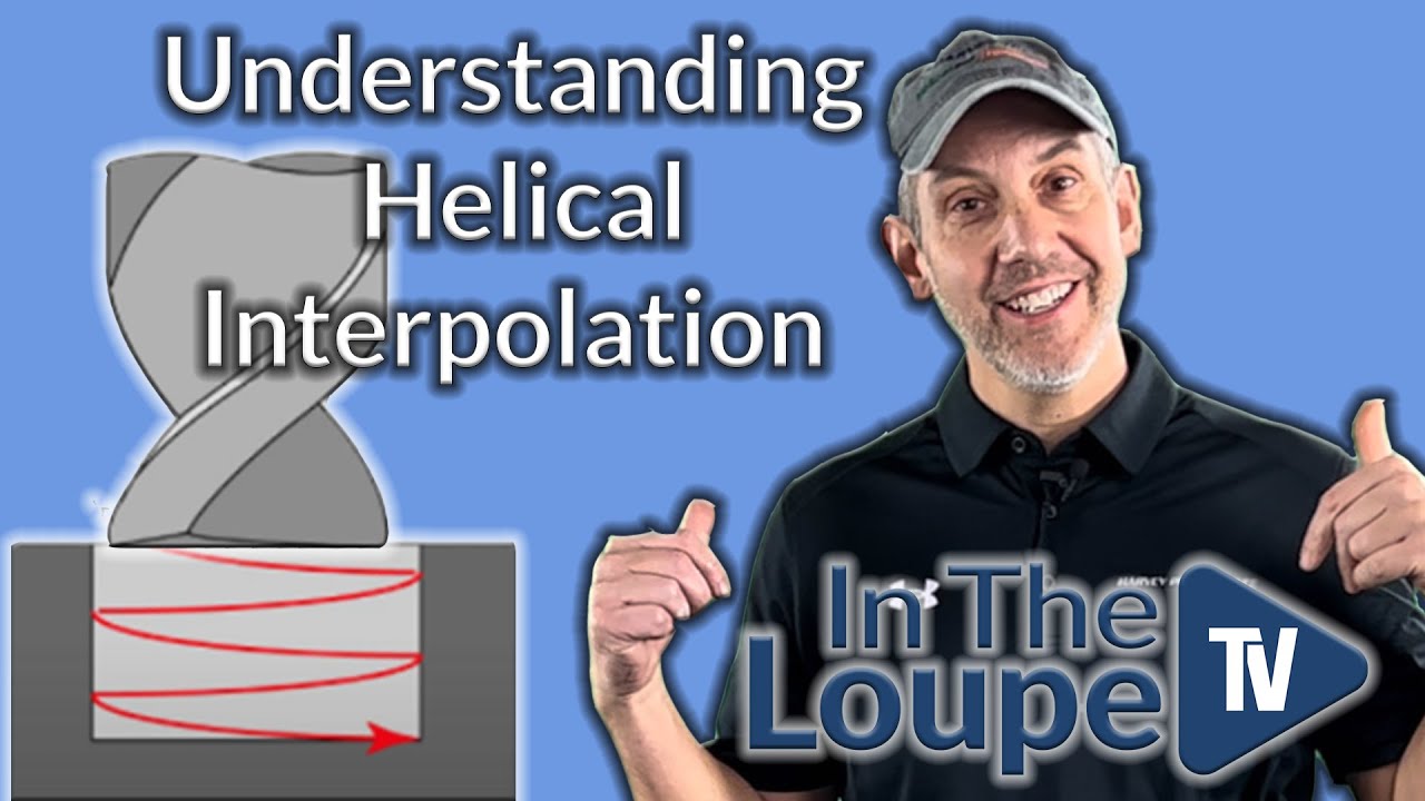

Here’s one of the better videos I’ve seen on the subject, can probably skip to 3:40 it’s about helical interpolation but a lot of is about linear ramp angle as well.
(The “In the loupe” series seems pretty solid all around)
looking at the photo, it looks like it was ploughing through or gumming up or rubbing. You mention the RPM was slower (10k) but what was your feed rate?
on a 5 pro 0.31mm DOC should be fine.
Feed rate was 20 IPM
0.05mm feed per tooth is quite hig for an 1/8" cutter especially when you are slotting and the DOC is high.
The ragged edges look like either the cutter was dull/damaged or the metal is particularly gummy.

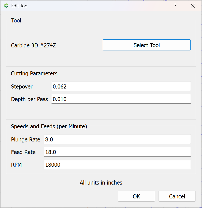

I set the values based on the Carbide screen capture above. I think poor material is half the problem though. I’ve notified my coworker and he’s going to try to get some better material.

I used 36 ipm, .015 DOC, .025 stepover, 2 degrees of ramping 10 ipm
