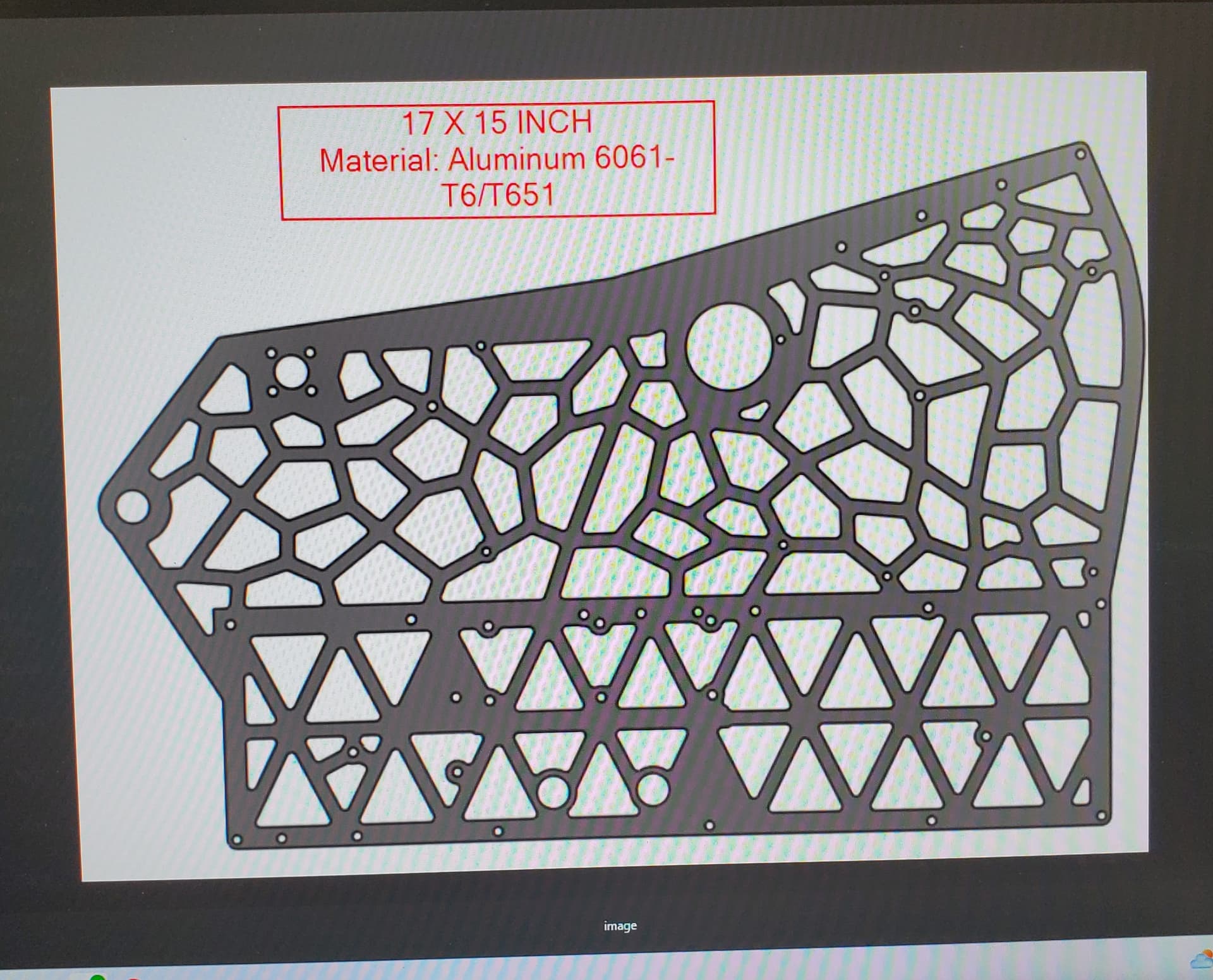

A guy I work with is in need of some machining for his child’s school robotics robot they are building. He’s asking if I can cut out something similar to what is shown here. I’m barely familiar with machining wood as I’ve only had mine for about a month. I’m much less familiar with machining metals. Would this be possible with the correct bit? The material is T6 aluminum, thickness is 1/8".

Yes it’s totally doable. The speeds and feeds in Carbide Create are decent to start with, but if you want to be extra cautious just reduce the depth of cut by like 30-50% - keep the feedrate the same though.
But one thing to consider: That’s a decent sized sheet of metal, and you should think about how you’re going to clamp it, or maybe if you want to use adhesive workholding. It may start vibrating in the middle if it’s not supported well. Cutting out the holes in the middle first and working your way outwards may help.
If you don’t have compressed air available when you cut the small holes, you can also use a dust shoe. Anything you can do to get chips out of tight features will prolong the life of your endmill.

That part would likely be a good candidate to have laser cut versus milled. You may be able to find a local outfit that is willing to offer a discounted rate given that the part is used for an educational activity. Otherwise, there a handful of online outfits that are fairly competitive on pricing.

Finally, completely off topic design thoughts…if they’re cutting all those holes all the way through just for weight savings, they can keep a lot of additional strength by keeping just a bit of metal instead of cutting all the way through. It’ll also make work holding much easier for you as you’ll be able to use adhesive/blue tape across the entire piece.
