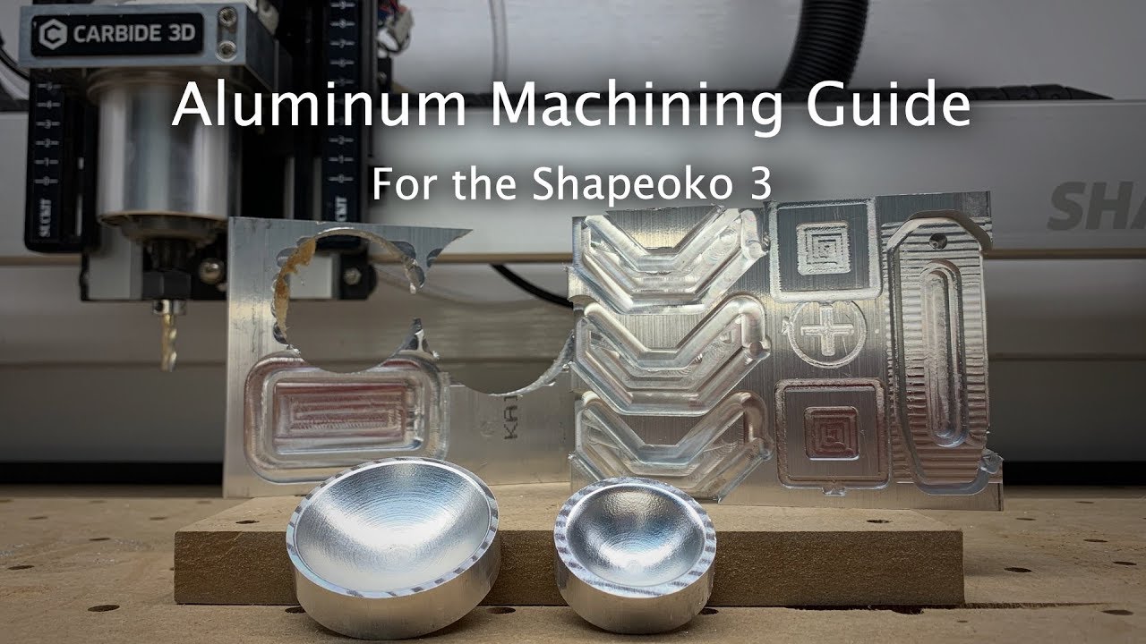

Aluminum:
Shapeoko 3:

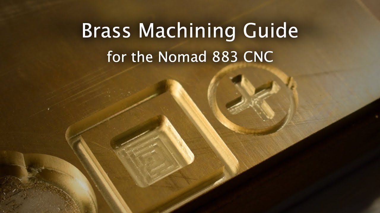

Brass:
Copper and brass:
sheets:
Nomad 883 Pro:
Brass Machining Guide

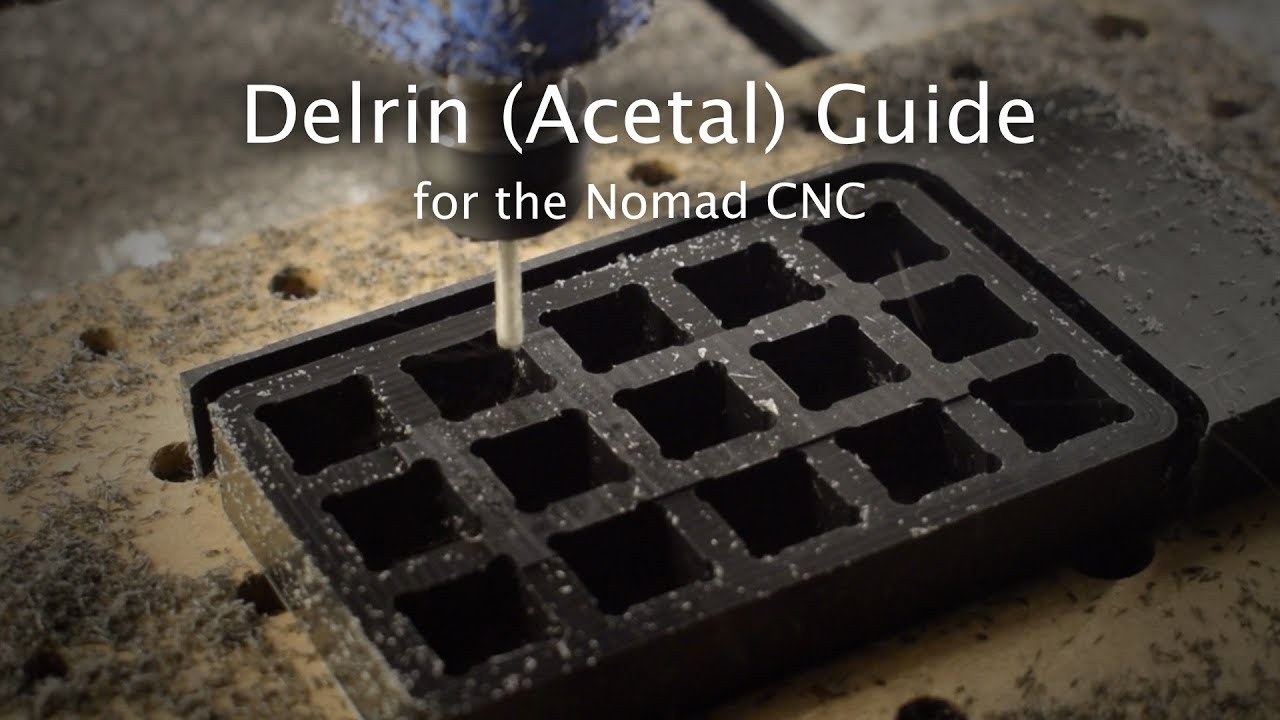

Delrin
Nomad 883 Pro:

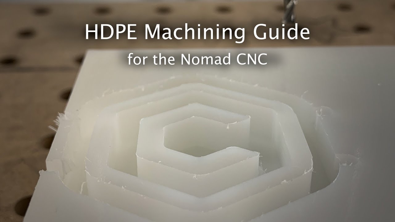

HDPE
Nomad 883 Pro:

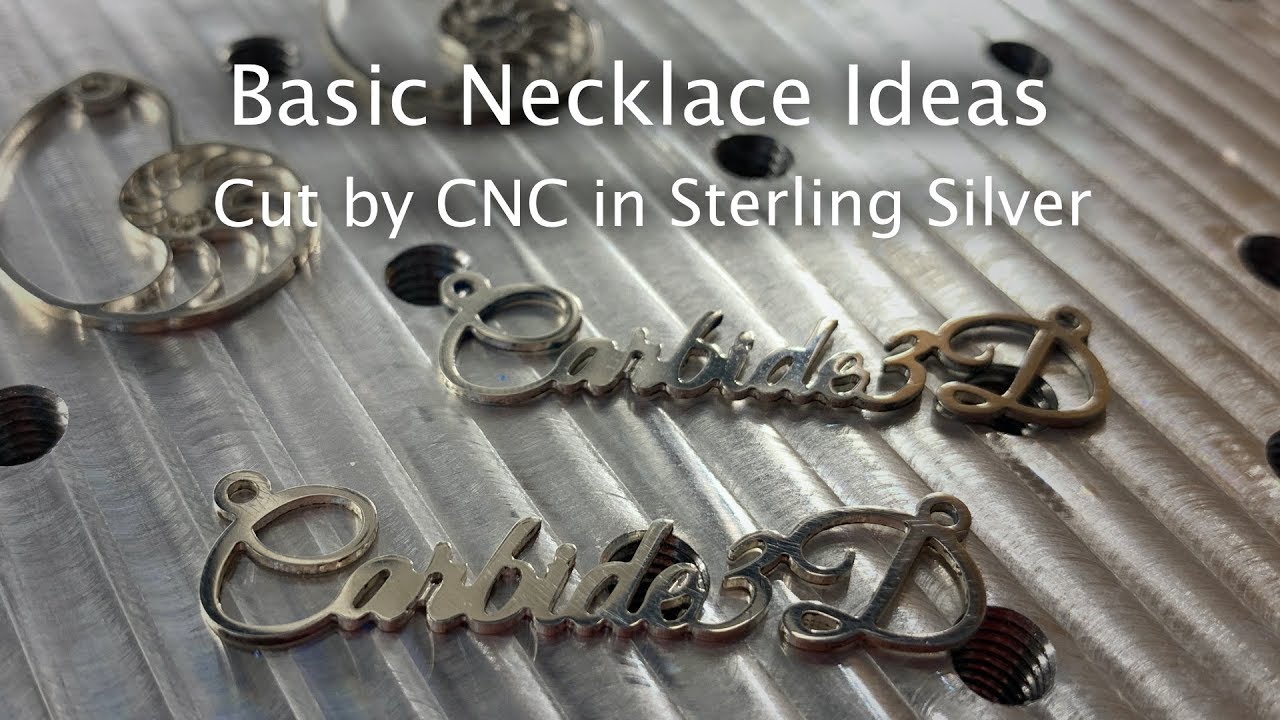

Sterling Silver
Nomad:

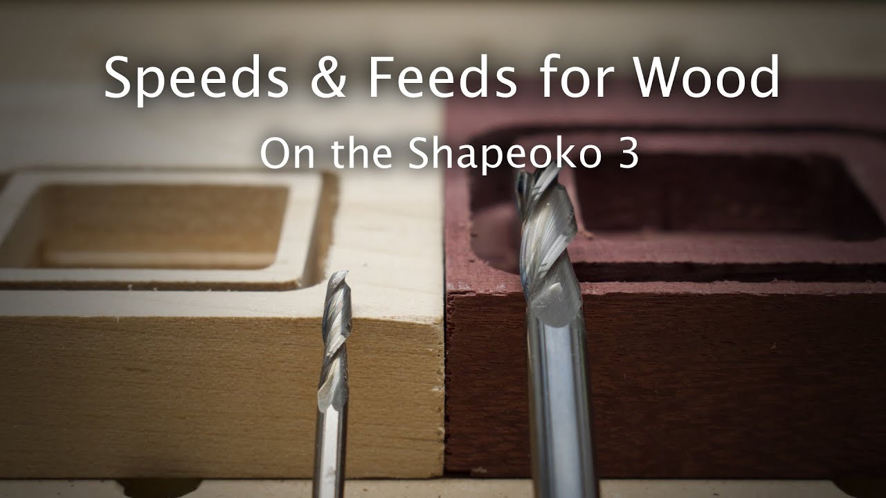

Wood
Shapeoko:
