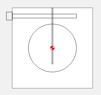

I did an MDF fixture to cut some Christmas ornaments. A pocket for the ornament, slip fit. A bandsaw slot to allow some movement. And a screw to clamp the part.
If you’re doing multiples, strategically placed slots & a long clamp could do the trick.

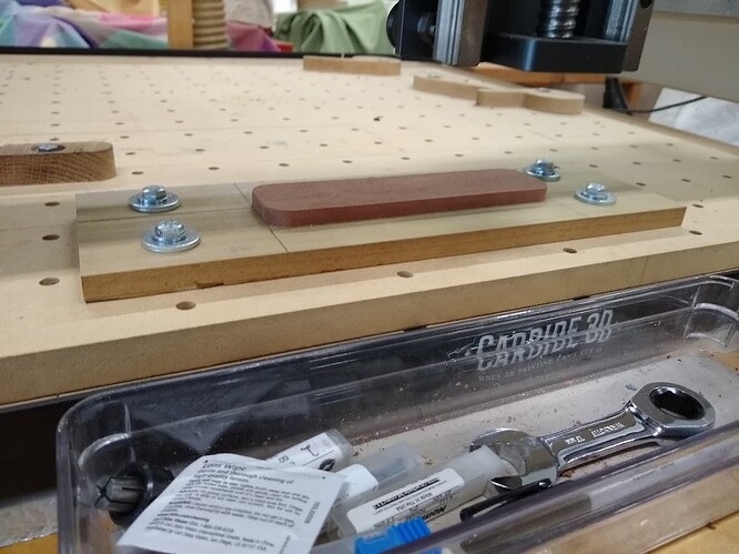

I have an SO3 with supplemental spoilboard with 2" spacing and Tee nuts with 1/420 bolts. I have done what Tod showed many times with the jig big enough to have 2-4 1/4" holes to bolt it down. I have also used the slot with a bolt to tighten around round objects or if it is a one of I will just add an F clamp to hole the round object while vcarving.
Here is an example of a rectangular box I clamped down to vcarve on the top.
On the newer hybrid tables the gator or tigerclaw clamps would also work as long as your object is long enough to span two tracks.
