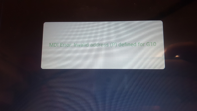

EDIT (ADD): Ran it on my Mac and Win Tablet. Runs great, but only G54 works (P1)
Attempt to store (P2) G55, (P3) G56 work offsets yields:
MDI Error: Invalid address § defined for G10
Many thanks.
Hey any solutions? I am having the same problem?
Yeah, quit. Work offsets are no longer supported. (and I ain’t happy about it)
O man y would they do that it there anoyher way i can set up to vices? Would g10 p1 l2 x0 y0 work for one vice and jus zero all in carbide motion on the other vice or is zer0 all in carbide motion the same as g10 l2 x0y0 ?
Thanks in advance
I put two vises on the table and then measure the distance between them. Then go into Fusion 360 and then do CAM Pattern (OR Model Pattern) with the distance being equal to the vise distance. It’s not as easy as work offsets, but I don’t see another way around it. See Photo for reference:
