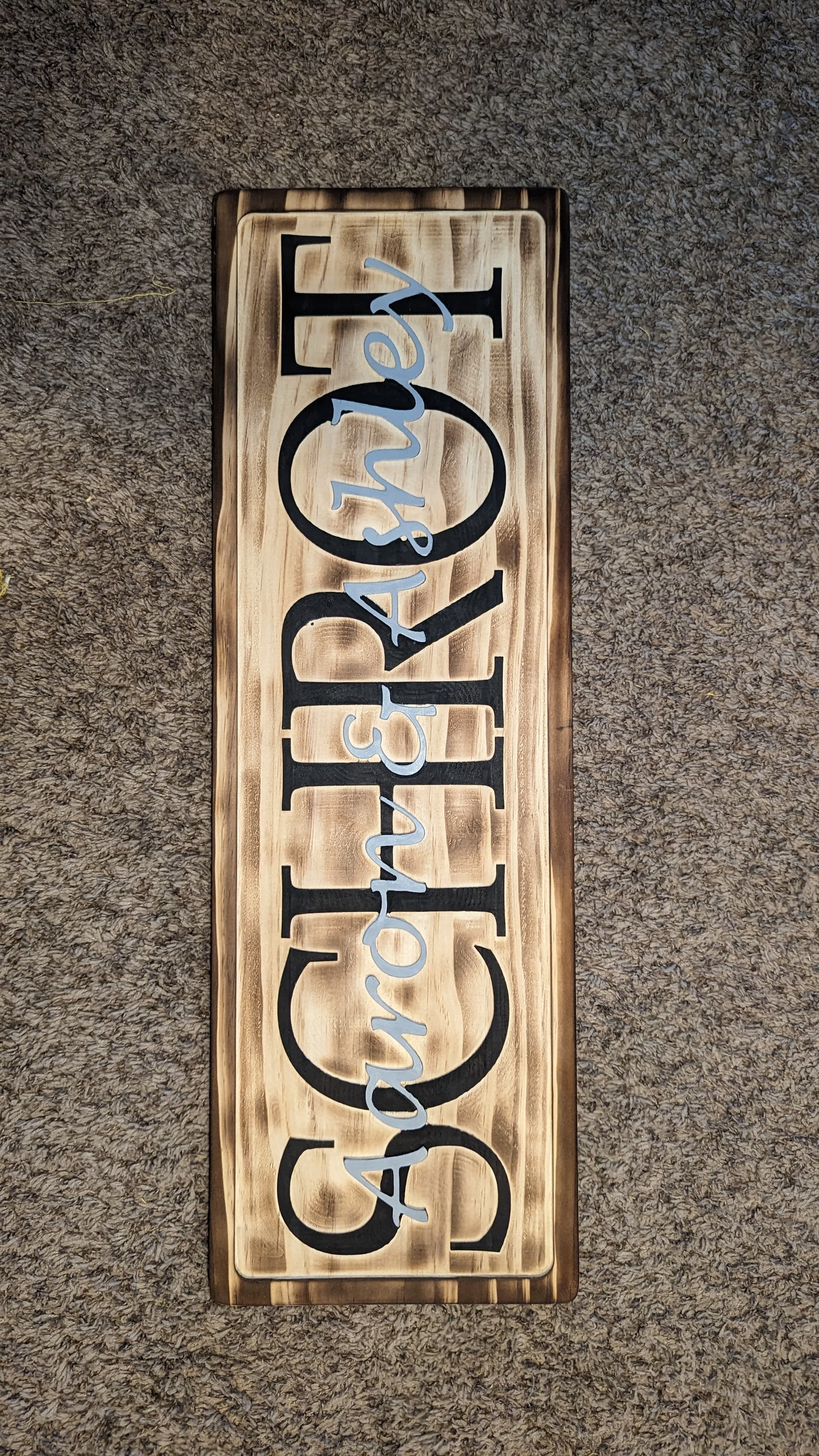

I like using rest machining personally I like being able to hog out a big surface area with the quarter and come back and do some smaller detailing.
I used a 1/4 for all the removal but in those inner spots on the letters my 1/4 never would have fit so going down to an 1/8 opens that up alot

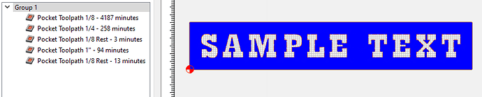

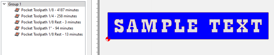

Depends on what you’re comparing. I just did a quick test for a guy on Facebook who was doing a 24" x 144" tiled sign. Just a (very large) string of letters. Pocketing the whole thing with an 1/8" was reporting something like 3 days. 1/4" then 1/8 rest milling was 2 1/2 hours.
So yes, it can save a lot of time.
