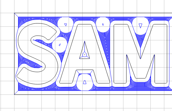

I made a pocket tool path with raised letters with 1/8” end mill 201
It cut all the letters out but there are several areas where the end mill didn’t go between the letters with the 1/8” end mill , I assume because the bit was too fat
Can I create a new pocket tool path just to clean up between the letters with a 112 or 122 end mill in a new tool path?
Welcome to the forum, you should be able to use the same toolpath but insert a 1/16” bit in the setup of the cut. Then run the simulation and it should show you if that’s small enough. Perhaps running the simulation the first would have revealed your results with the 1/8” bit?
If you have CC Pro, you can use the Rest function.
If you don’t, I suggest doing an offset Vector at .07 and using the pocket function. That will give you enough room for the .0625 (1/16) EM. If you only switch the Tool to a 1/16 EM, you will have to recarve the entire pocket with that tiny bit, and it will take a long time and mostly be just cutting the air.
You can also use the Advanced V-Carve function.
Here’s a sample of using just the 1/8 EM
Here, I added the .07 offset vector on the outside of the text.
Toolpath using the 1/16 EM, you can still see that the tooling is not cutting in some areas because the bit is still too big.
