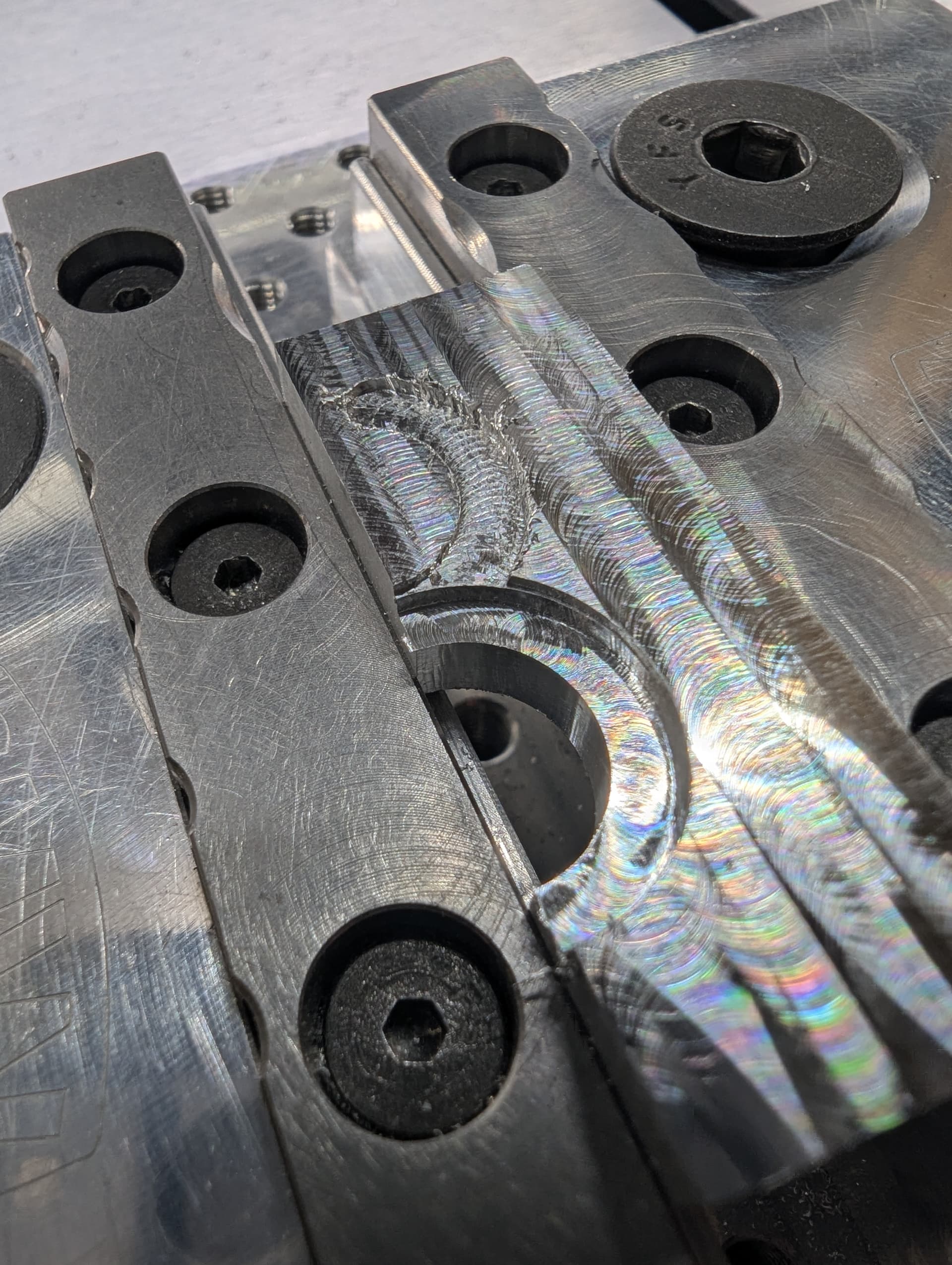

My Nomad3 is sometimes stalling, spindle still on, or even worse will sometimes go off course and wreck my project. I am suspecting some sort of issue with communication over the usb, like a disconnect. GRBL errors vary slightly, but usually gSender throws out ERROR 1. I can re-start the job and usually it will run with no error, so I am leaning away from a code problem.
I use HSMWorks (Fusion) inside Solidworks with the latest post processor from Autodesk to generate code. I then use gSender to run the file.

You can check the code by putting Grbl into Check mode where it will process all code (but not move) by sending $c to the machine. (Agree that the code likely doesn’t have a software error)
What sort of toolpaths are you using? Is adaptive/trochoidal an option?

I’m not using Carbide Motion, I am using gSender. I have used the verfiy feature to check the code with no errors…plus I stated that I re-started the job and it ran just fine.
