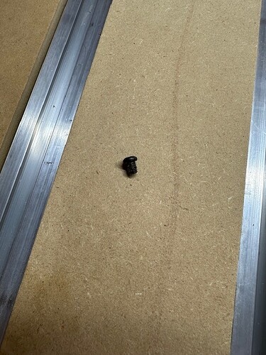

So I was doing a clean up on my new machine and found a random screw in the T track. Not sure where it goes to, but not one from my assembly. Looks to be about 5mm thread length with a 4mm diameter. Now I’m wary of running it again until I figure out where it came from.
Any help is greatly appreciated. Going to also send an email to support as well.
As was noted on Support, that is an oil port cover screw:
https://my.carbide3d.com/docs/maintenance/
I’ve had this for a week so haven’t done any maintenance. And when I did a search for loose screw it didn’t show anything for the 5. And those directions really don’t show anything about where these are, but I figured it out. I’ve found them, and found where it is missing, along with more then one loose screw. And it’s a major pain, but I’ve got it done. Thanks for the assistance. Some pictures in the maintenance guide would be helpful.
