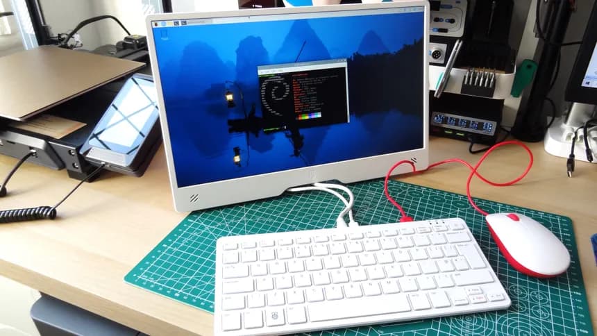

The new keyboard variant, has a more solid premium feel and 16 GB of Ram. If your in the market for a Raspberry Pi it’s a nice out of the box experience. You can read other reviews of it else whare on the internets for the basics of the product.

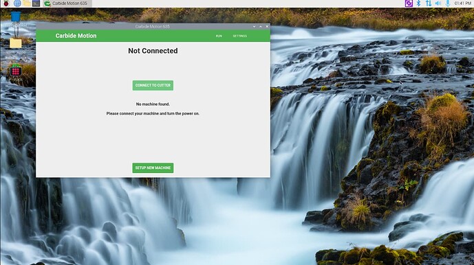

At the time of writing mine shopped with PI OS Bookworm 64 installed. With in hours of booting they release PI OS Trixie. Currently I would advise against loading Trixie it broke Carbide Motion for me.
Remote controlled with Pi Connect built into Pi OS Bookworm
My older post on EZ Raspberry Pi setup still applies, same steps work with Bookworm 32 bit. Mainly I set up a “pi” user with the Password of “raspberry”, the OS will tell you it’s a security risk, and it is. The instant you turn off Wifi it’s no longer an issue unless someone else is standing at the computer, and after you see it all works feel free to change the password.
With a few quick steps I had Carbide Motion running and connected to a Shapeoko, sent settings to the controller and “Bobs you uncle” as they say. Again the weight and feel of the mechanical keyboard make it feel less clanky, I’m sure there will be some sort of keyboard covers for it come out down the road.

Good to hear the issue is with Trixie. I was ready to make a post about my inability to get CM installed on my Pi 400. (apt couldn’t install the qt dependencies). I’ll try again with a card flashed with Bookworm.
I have the 500+, but it’s just too nice to put in the shop (replaceable mechanical keyswitches? What is this sorcery?? :wink: ).
[addendum] I can verify that flashing the Pi Bookworm 32 bit version works flawlessly to install CM-635. It launches fine. I haven’t tested it with my S5Pro-XXL yet.
