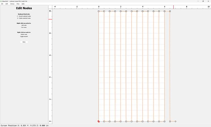

This has been discussed and although not a toolpath people simply draw up an S shape going up the material and then do a no offset contour and the router follows the snake up the board going back and forth. It is I guess the poor man’s raster.
I did not spend a lot of time but you would space the lines apart for the surfacing bit to overlap similar to step over.
If you have Carbide Create Pro, the Engrave toolpath can be used for this:
Or, as noted, such toolpaths are quickly drawn up using the polyline tool:
and if covering large areas, replicated using the Linear Array feature:
OK

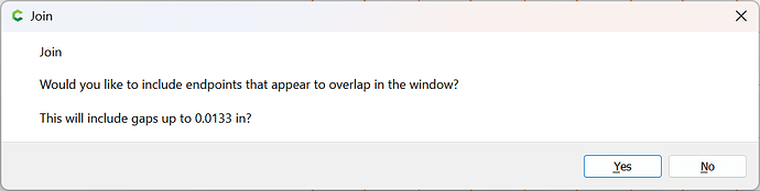

Joined together using “Join Vectors”
Yes

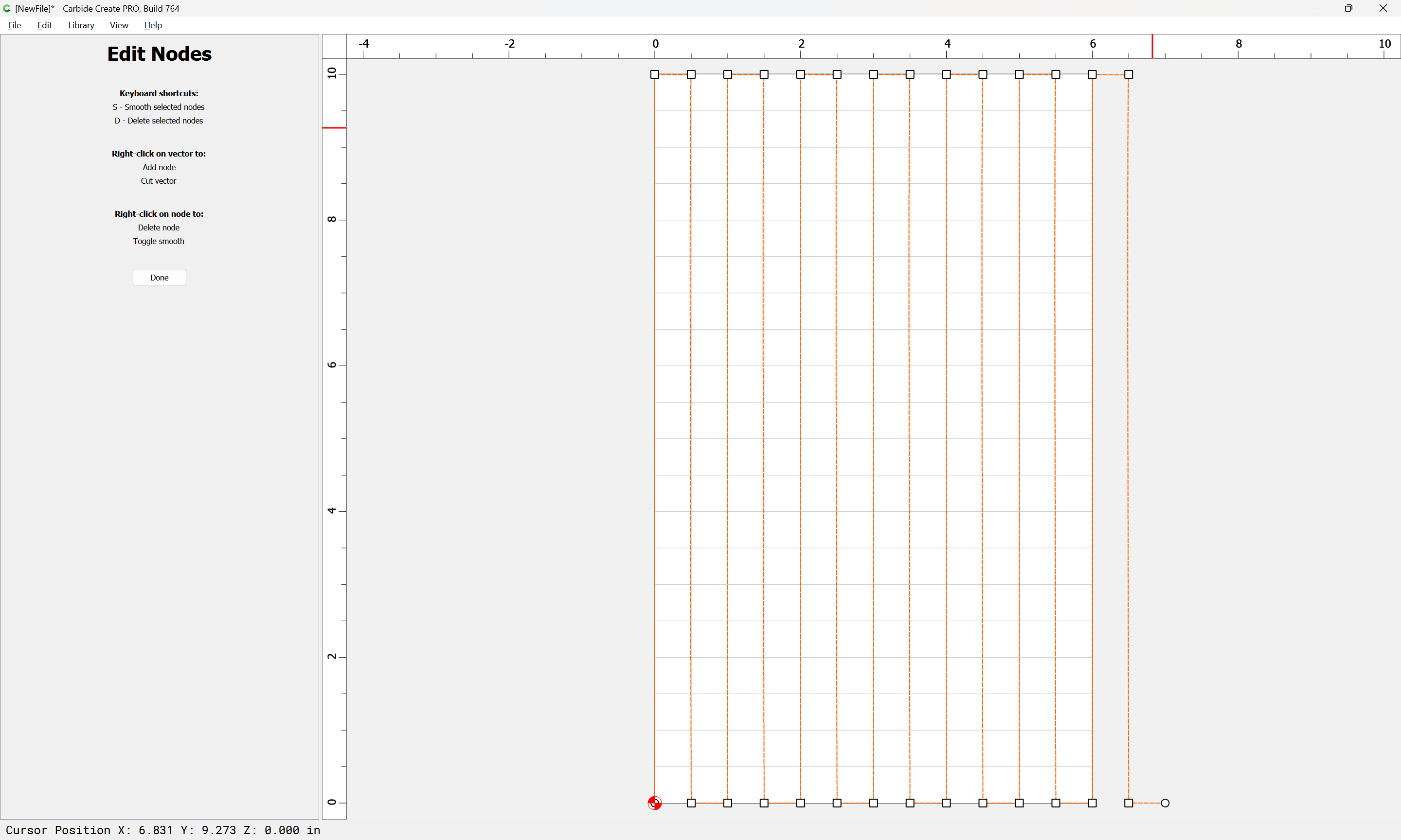

and then adjusted at need using Node Edit:
“D” (for delete)
Assing a Contour toolpath w/ No Offset:
