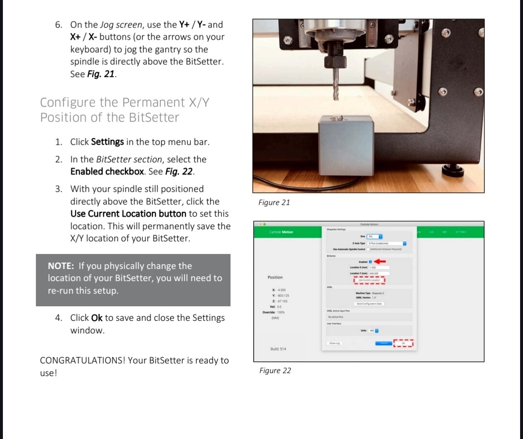

I’m trying to recalibrate the BitSetter in my Shapeoko 3XL, and I am following the instructions in the manual. However, according to this flow and the pictures attached, Carbide Motion has changed so drastically that the ‘Use current location’ button no longer exists inside the settings. I’m currently utilizing Carbide Motion version 6.51. Can someone direct me to the updated flow on how to do this? Thanks a ton.
Crisis averted. I was able to figure it out. Restarted carbide and ran the setup machine wizard.
