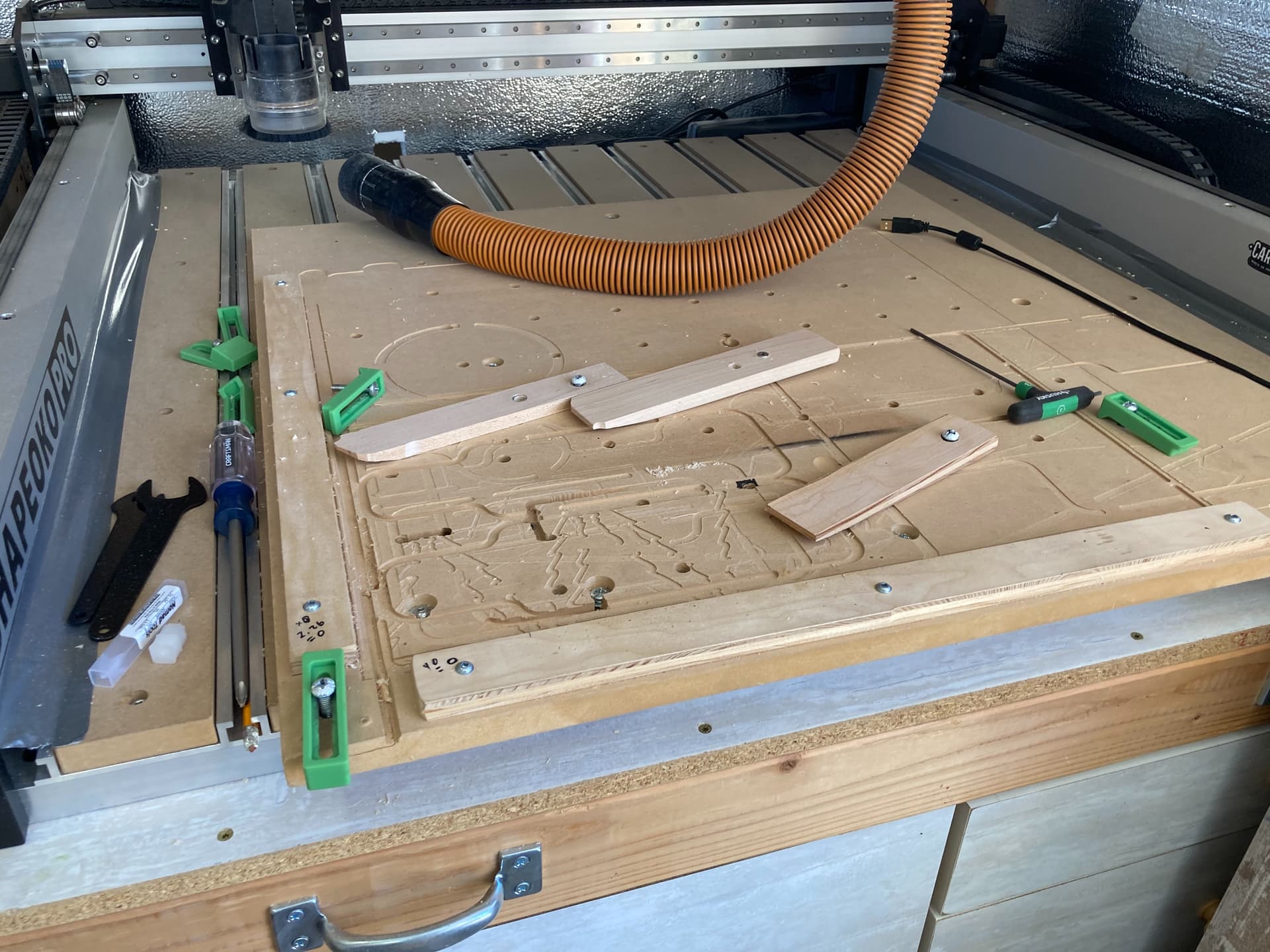

My XXL Pro has a 24x24 MDF piece on top of the stock MDF slats for no reason other than I wanted to. I placed a square 90 degree corner at front left and use strategically spaced threaded inserts (t-nuts) in the new top for hold downs. I hold the new piece down with screws that reach the stock aluminum pieces. Pretty straight forward and it makes me think I’ve done something smart, even though it was largely unneeded.
I squared my corner boards by screwing them down as close to square as I could, leaving a gap at the intersection. Then ran a 1/4-in end mill manually along the insides of each board, trimming off a very small amount of material on both X and Y axis. BINGO! Instant alignment.
