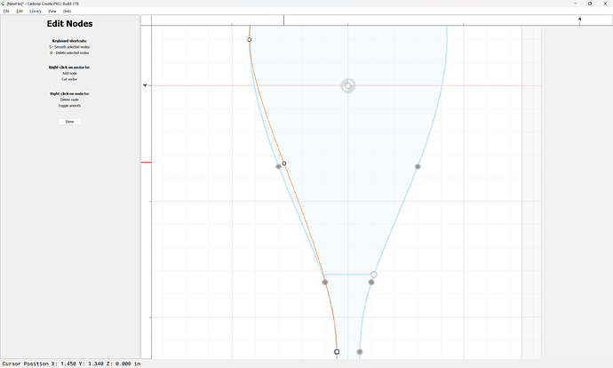

how could i best draw this to dimension in CC?
Import the file and scale it so that it is the right size:
Then re-draw it using the Curve tool:
Then use the Node Edit tool to adjust things:
Done

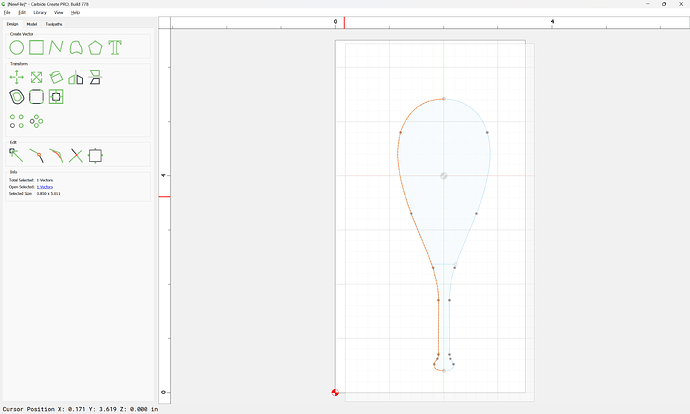

With one half drawn:
Duplicate:
and Mirror Horizontal:
Drag into alignment with the original:
Select both parts:
Join Vectors:
Yes
You can also export the sketch from Fusion and load it into Create. I believe you right click on the sketch and then you can export it as a DXF.
