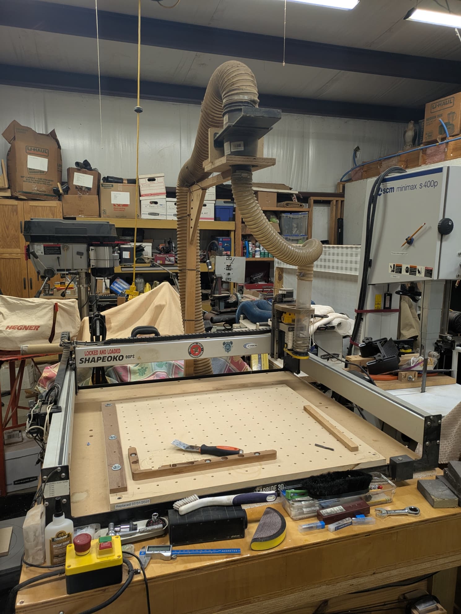

I use an L bracket on my Shapeoko to position most square work. That gives me a consistent place that my work will be positioned. I have had disconnects or mistakenly shut off my machine and simply re-initialized and loaded my file and it worked flawlessly. However I had not moved my work piece.
Here you can see my L bracket.
