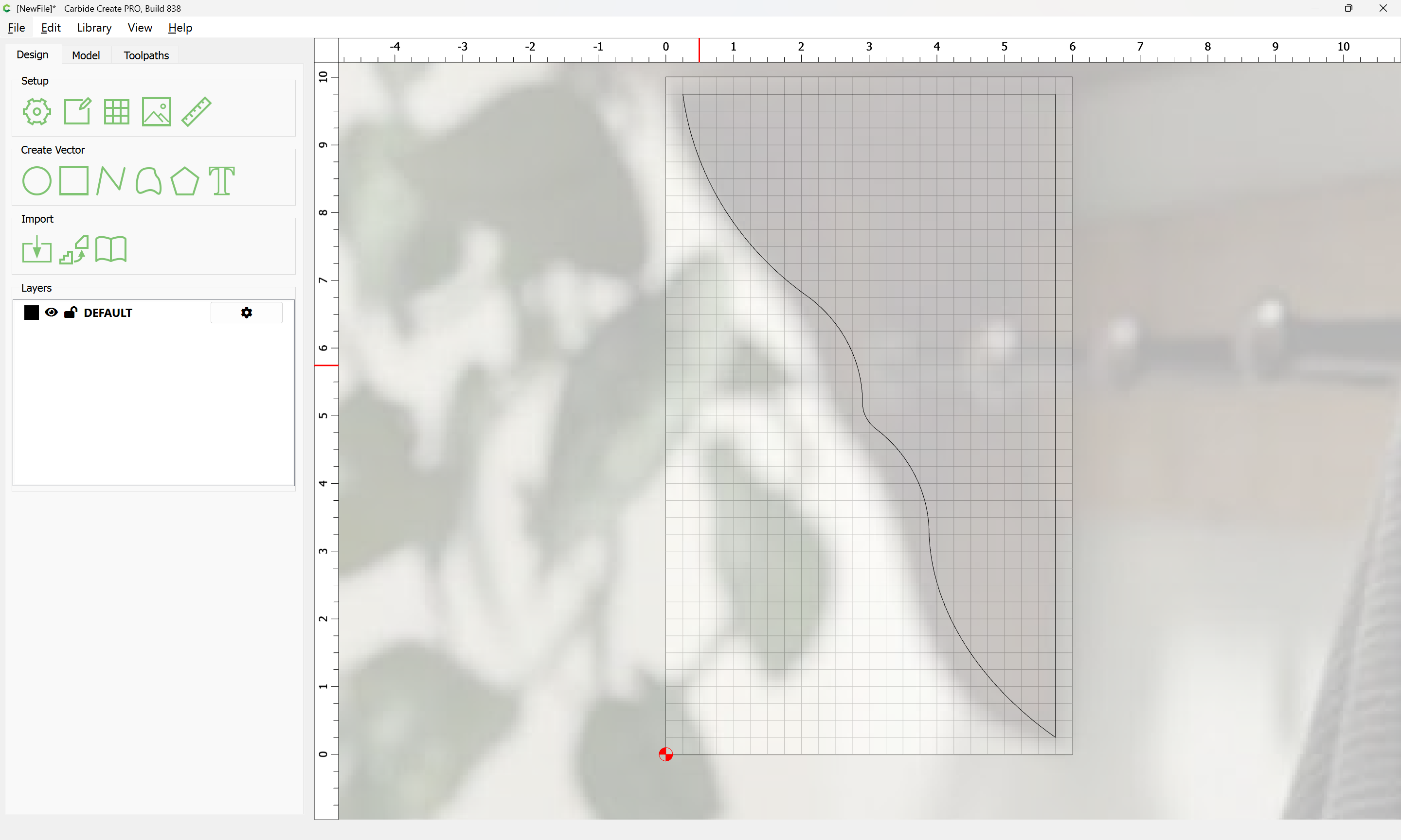

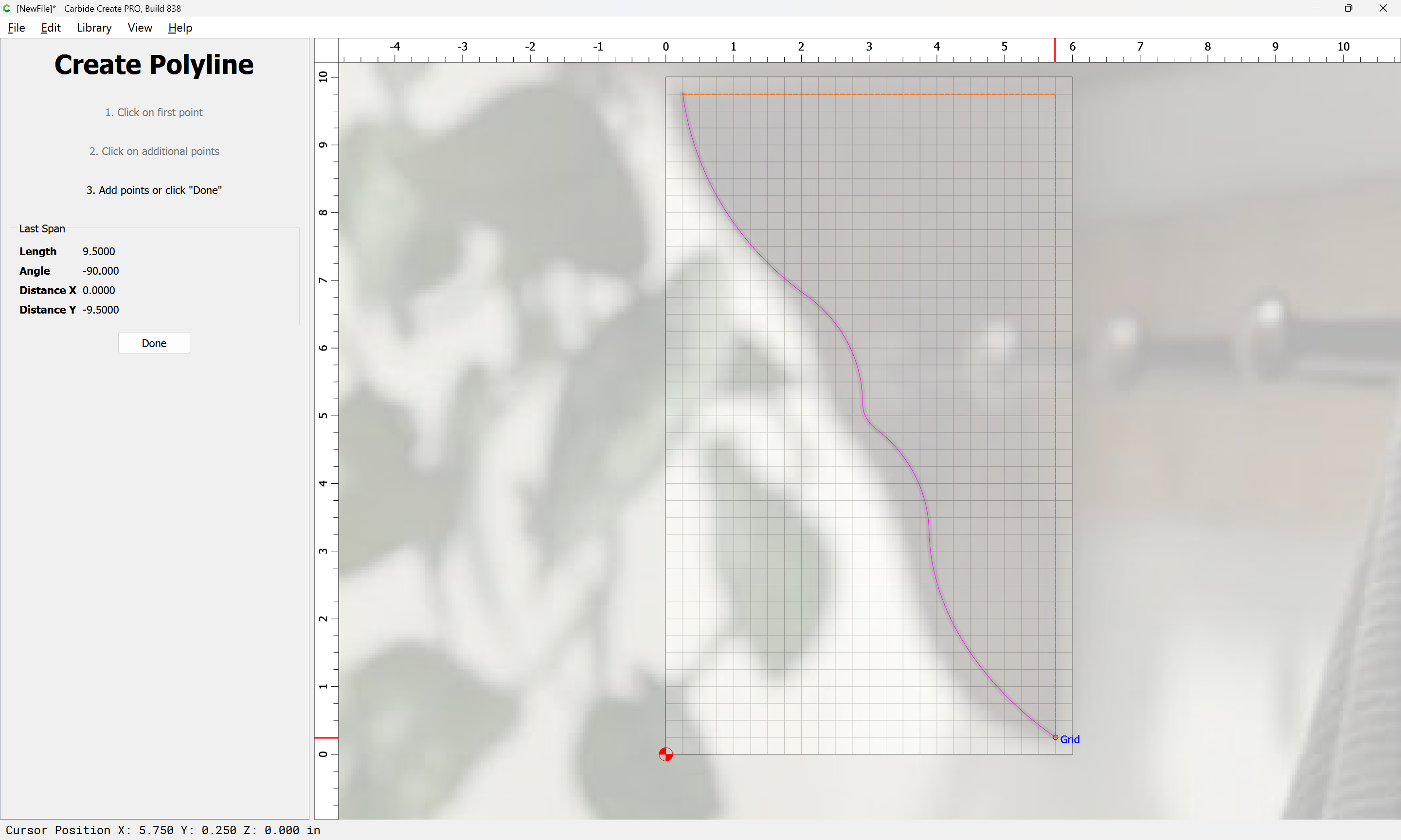

Hey guys,
I’m working on a signature coat rack and want to cut the end profiles on my CNC. One problem though
I’ve tried over and over to draw it out and even trace the photo, but I just can’t come up with a file I’m happy with.
Does anyone know where I might find vector art similar to this style?
Or, if anyone feels like being a hero, would you be willing to trace this photo and send me a vector file?
I’ll attach the photo here—let me know what you think. Appreciate any help :+1:
Thanks guys, and Peace Out
Bender

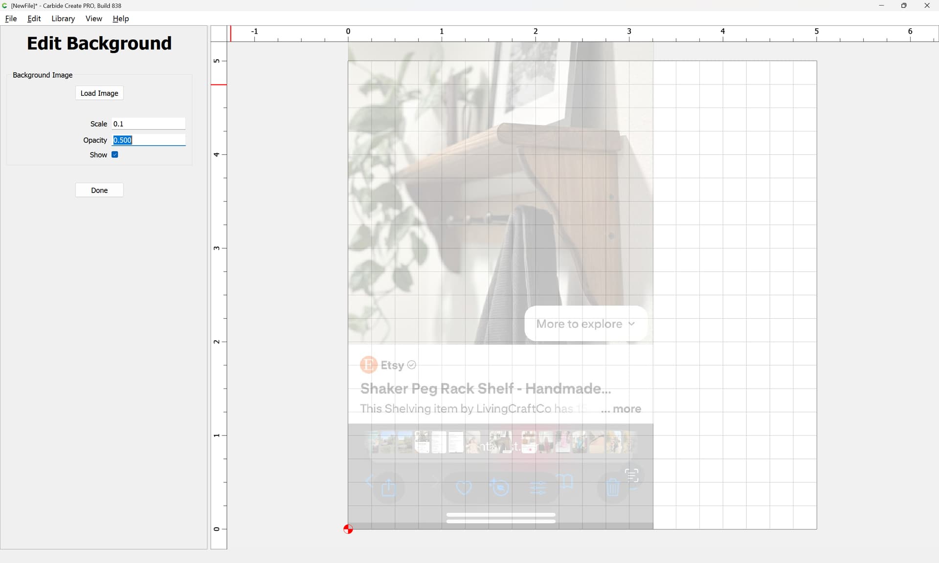

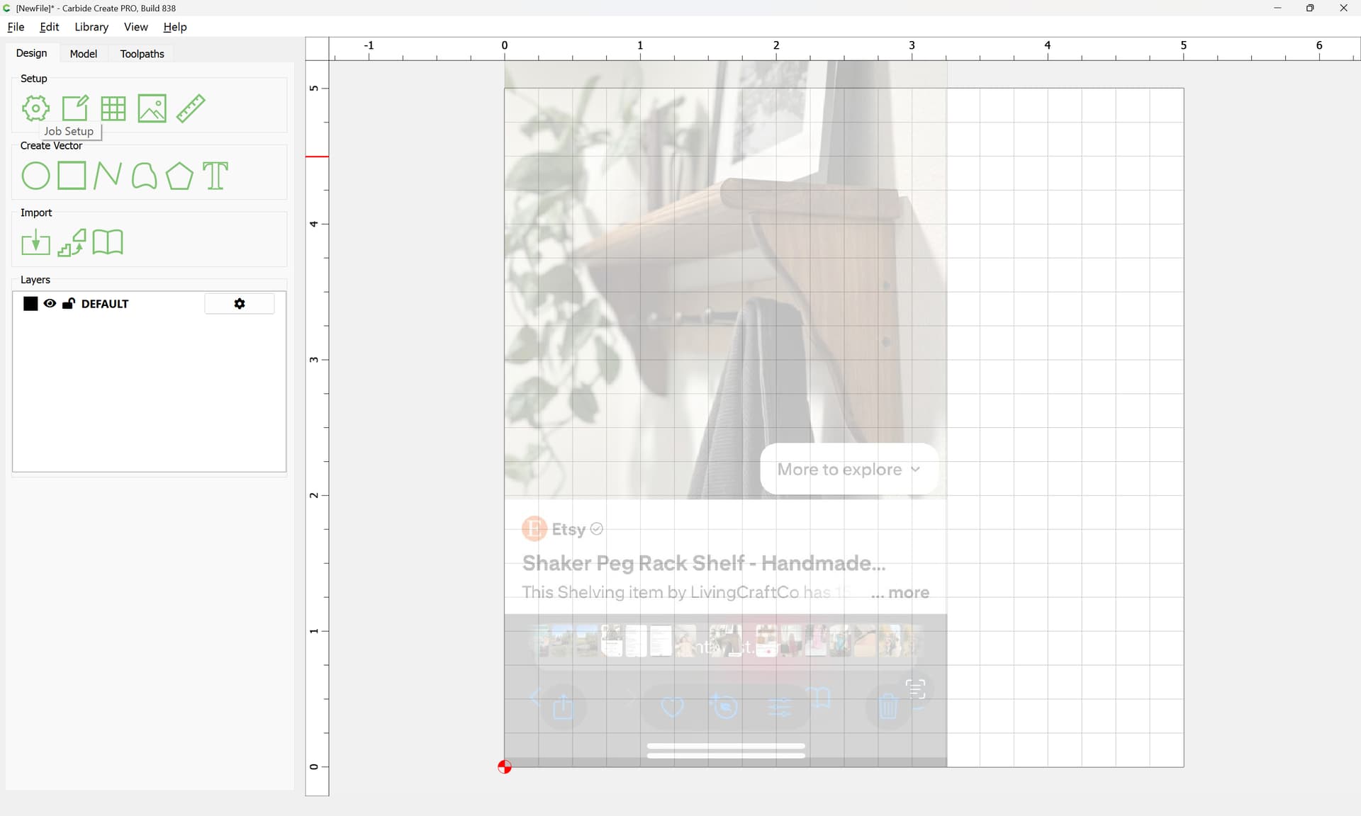

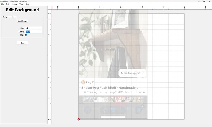

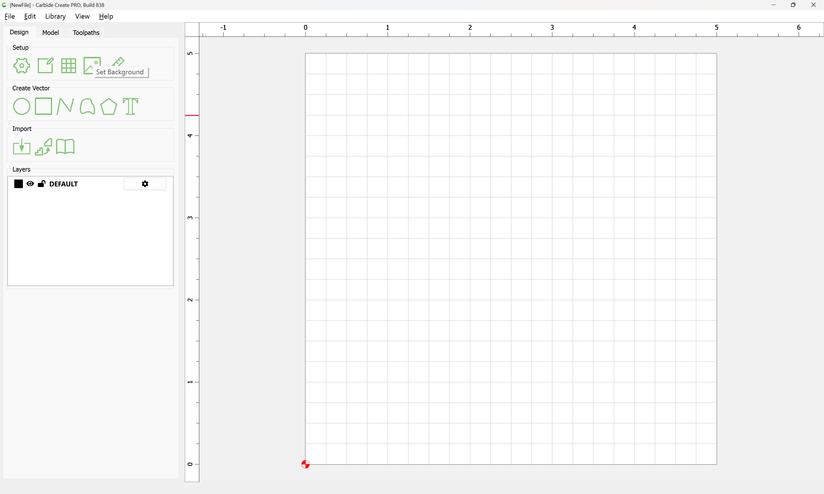

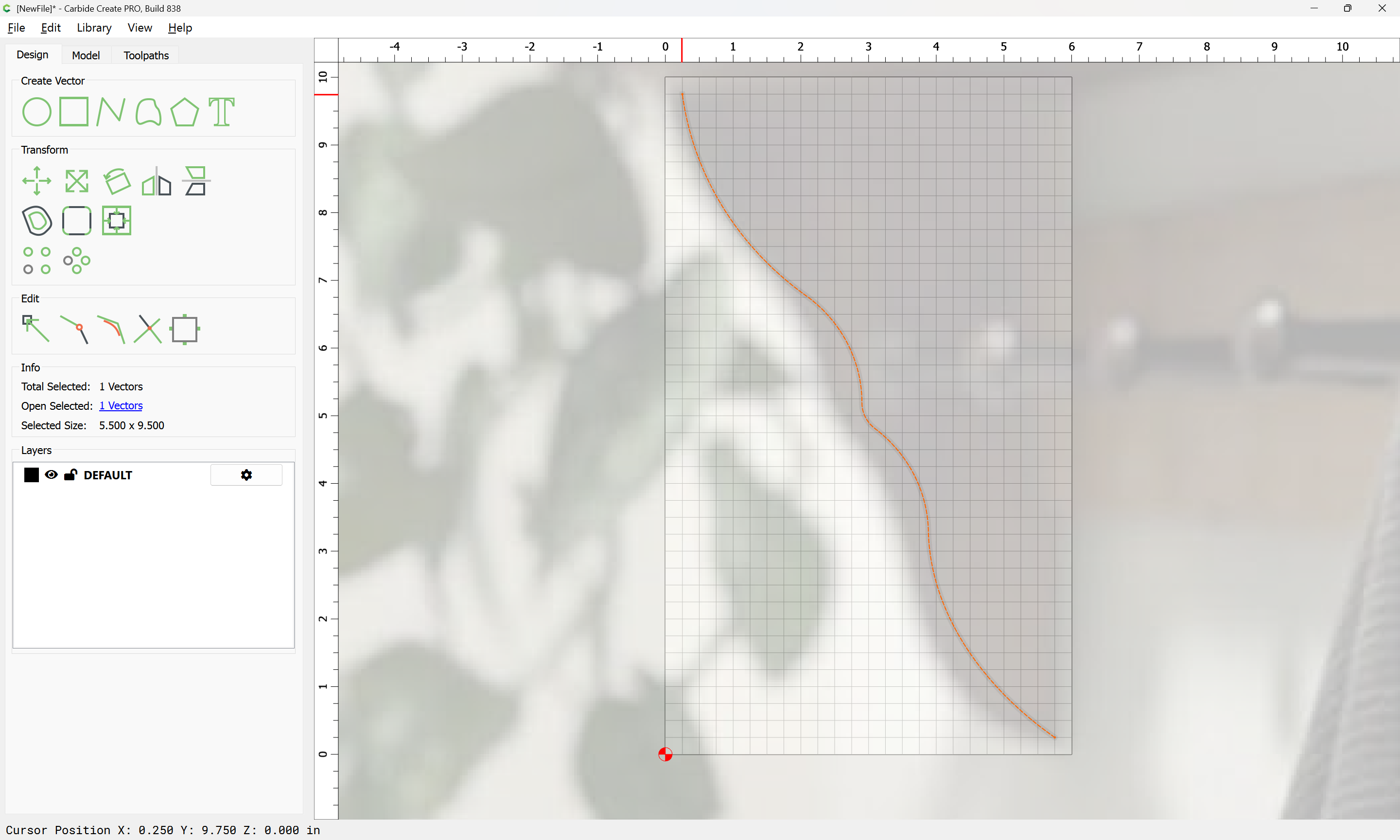

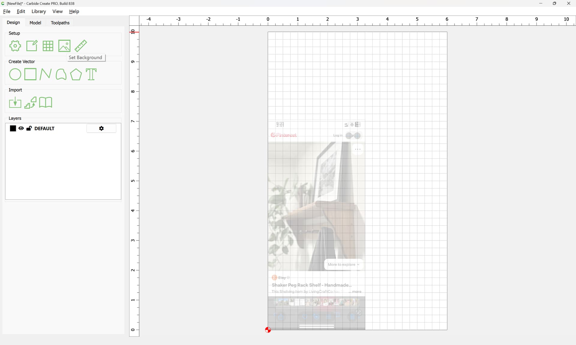

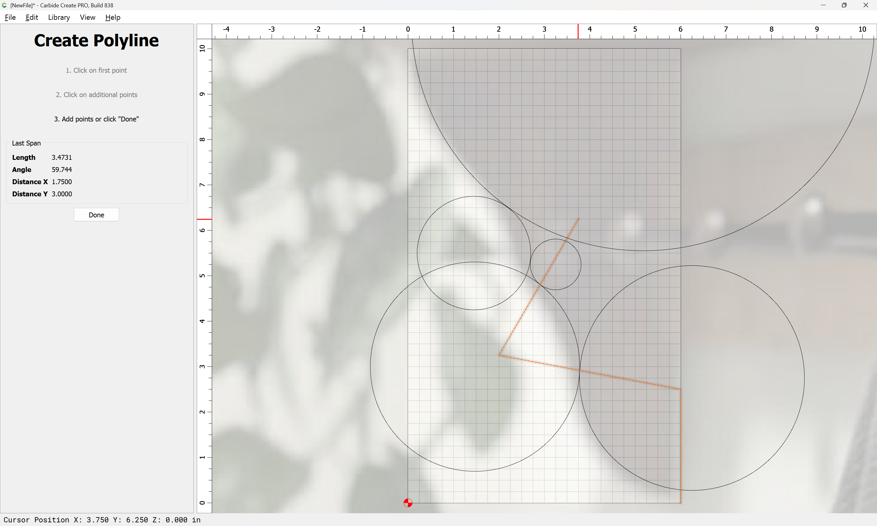

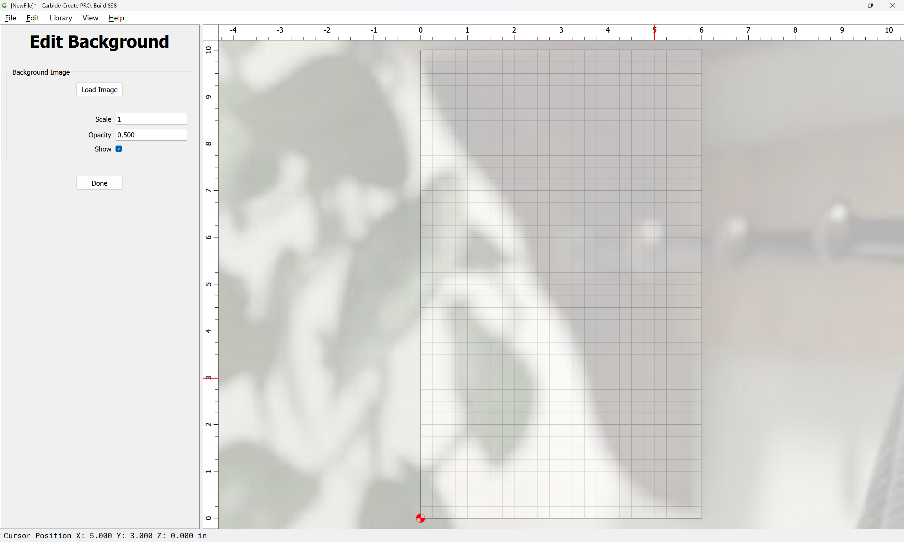

Start by importing the pixel image:

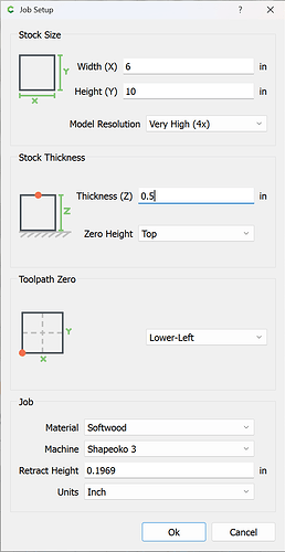

Guesstimate a six inch deep shelf, and roughly nine or 10 inches high:
Adjust the image:

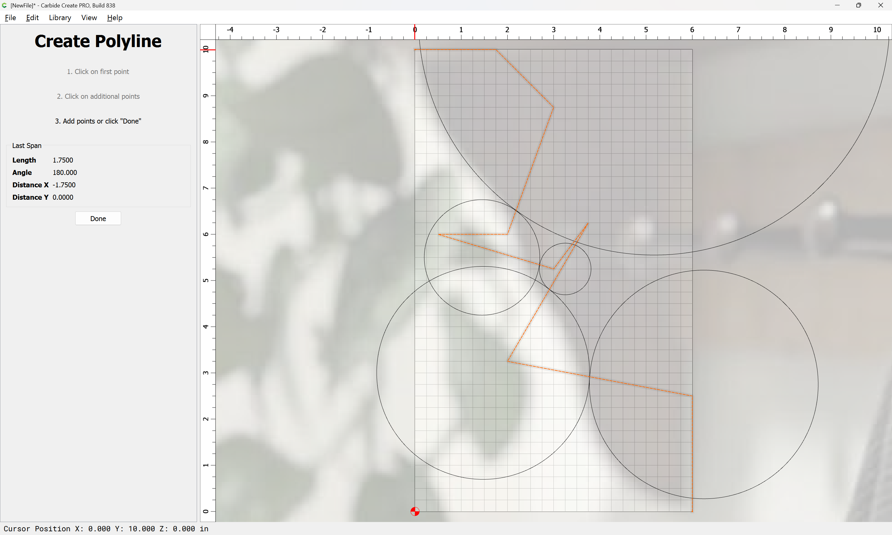

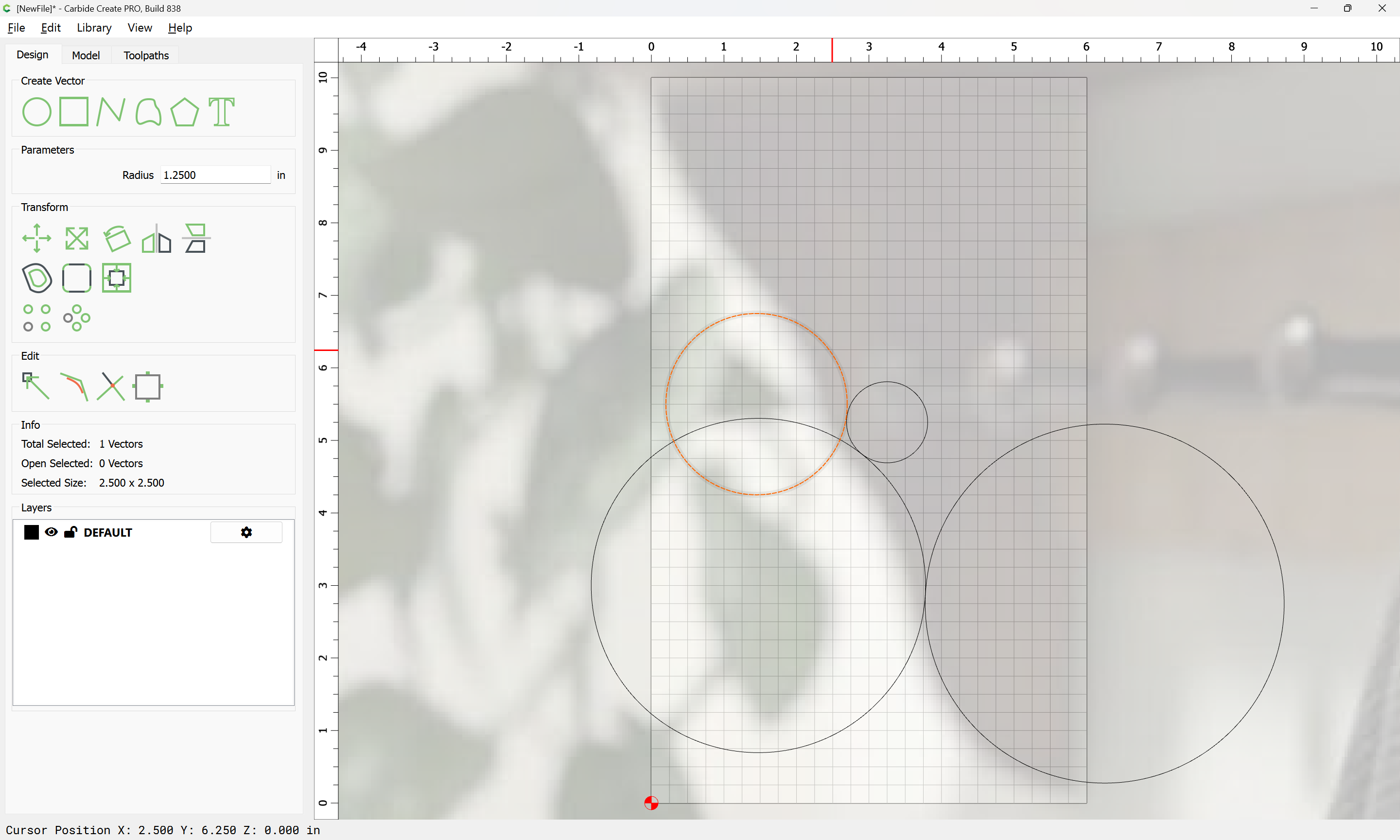

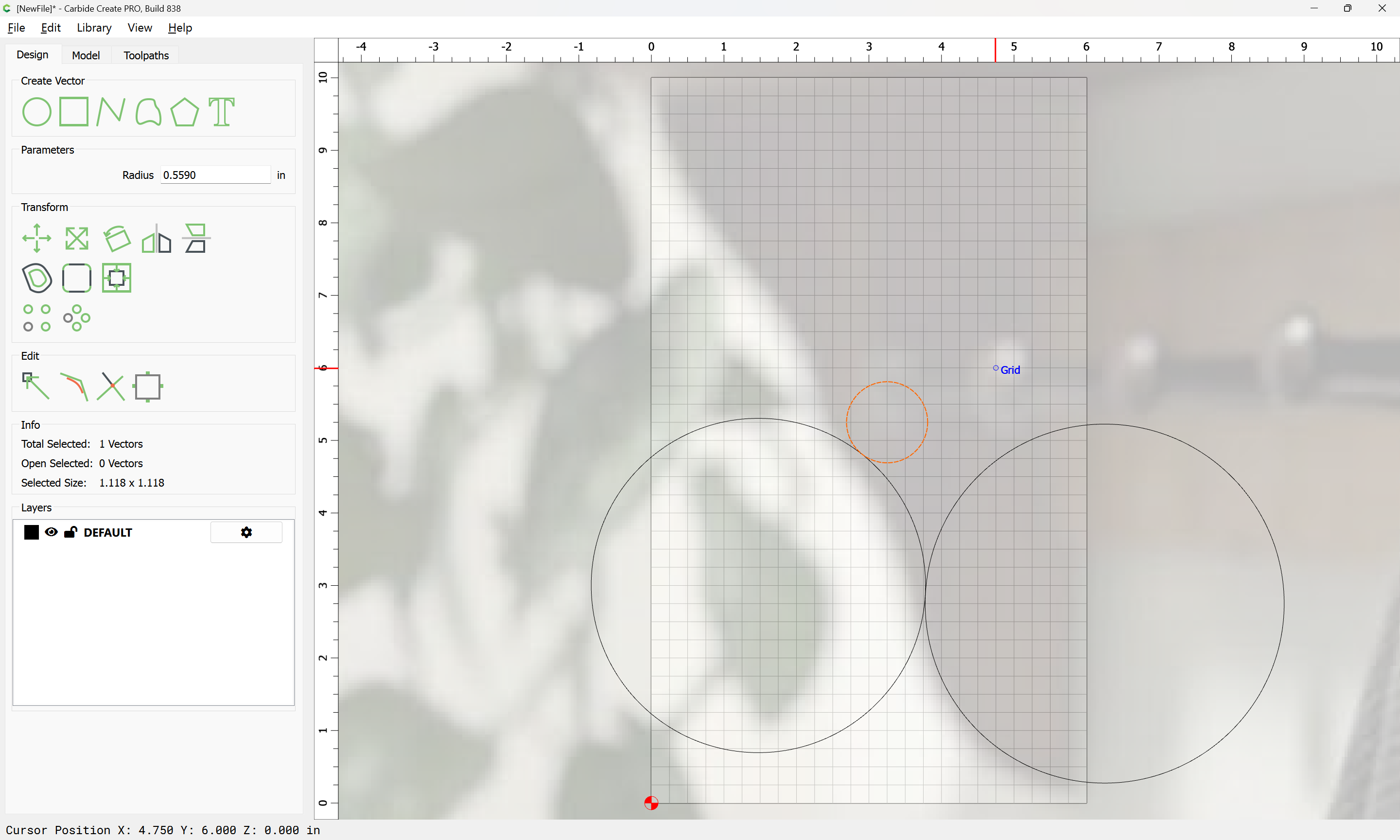

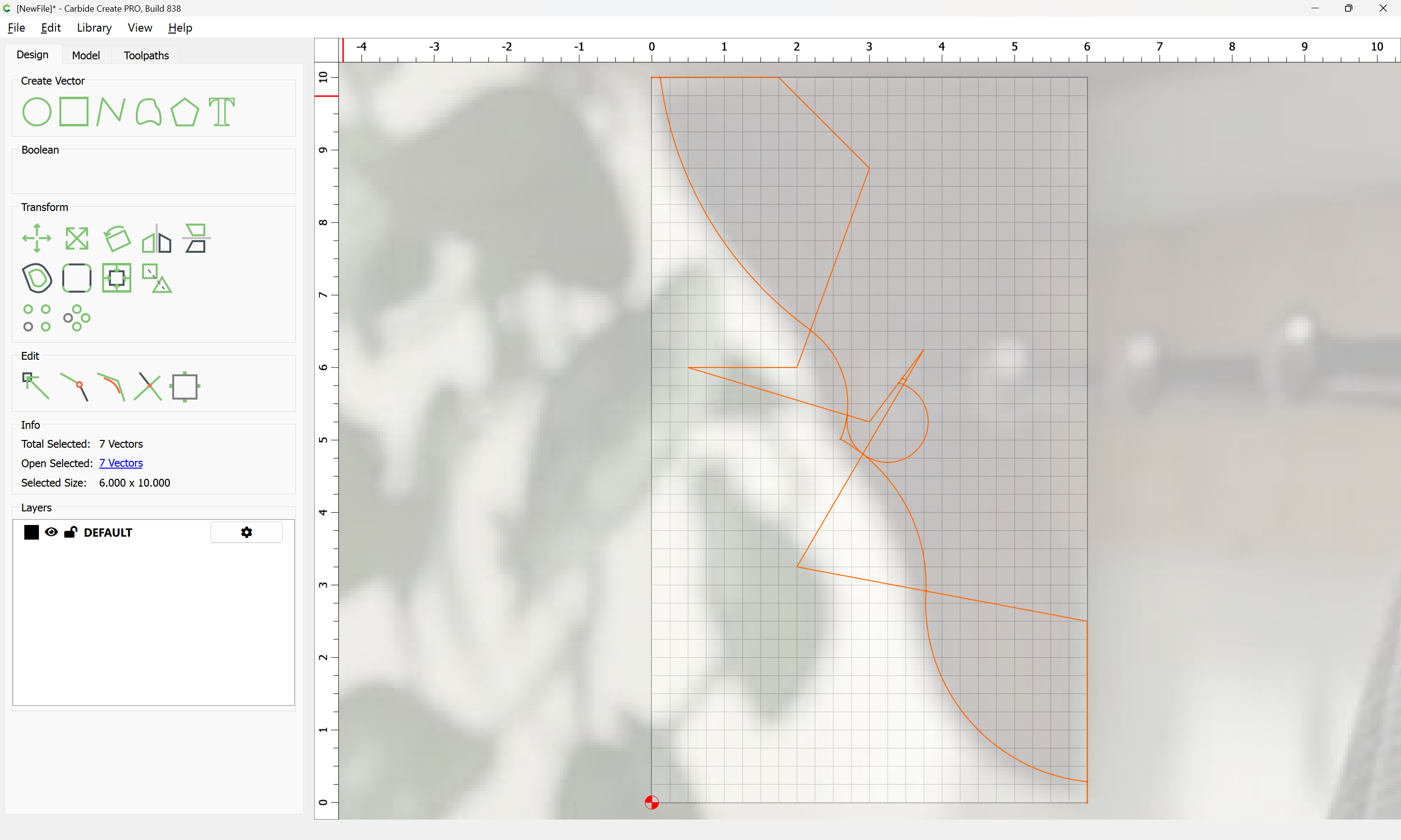

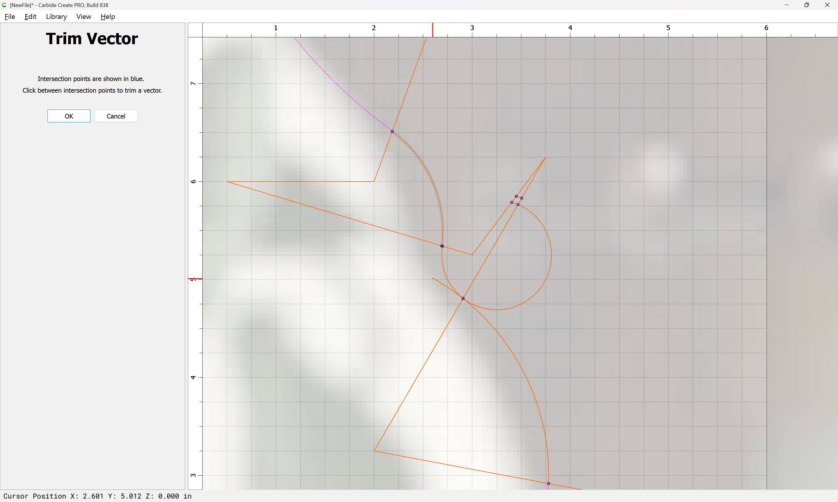

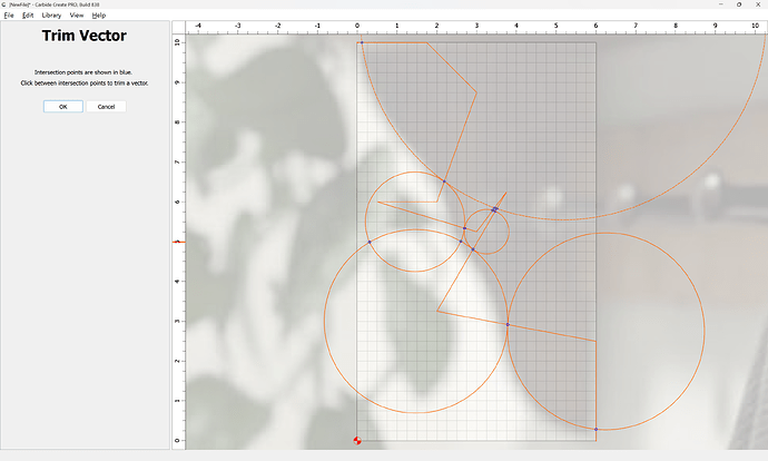

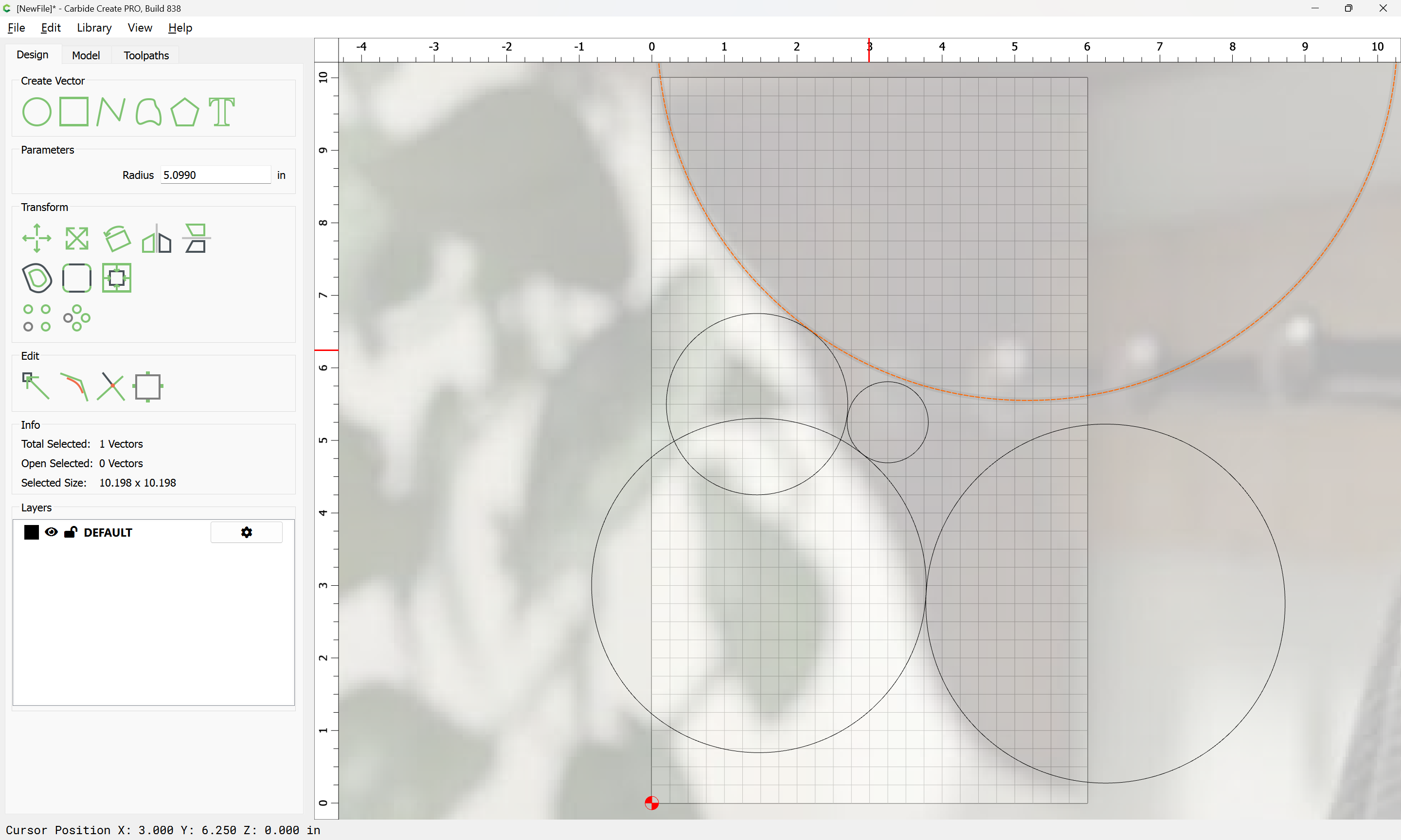

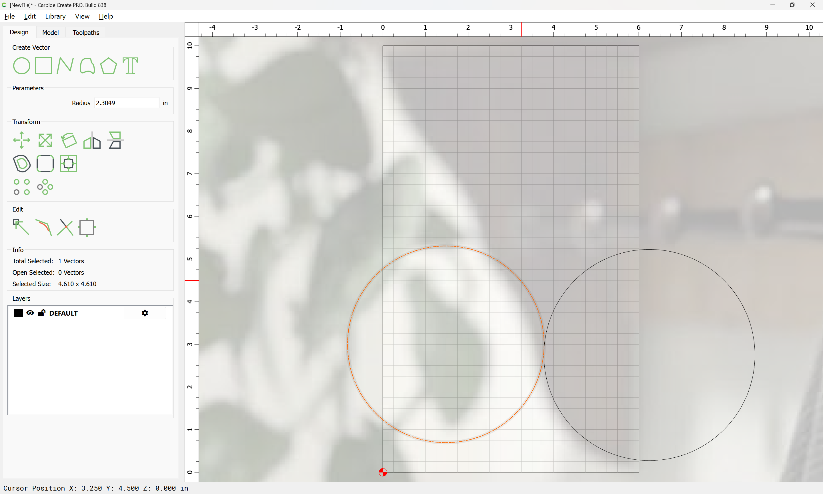

Then draw some circles:

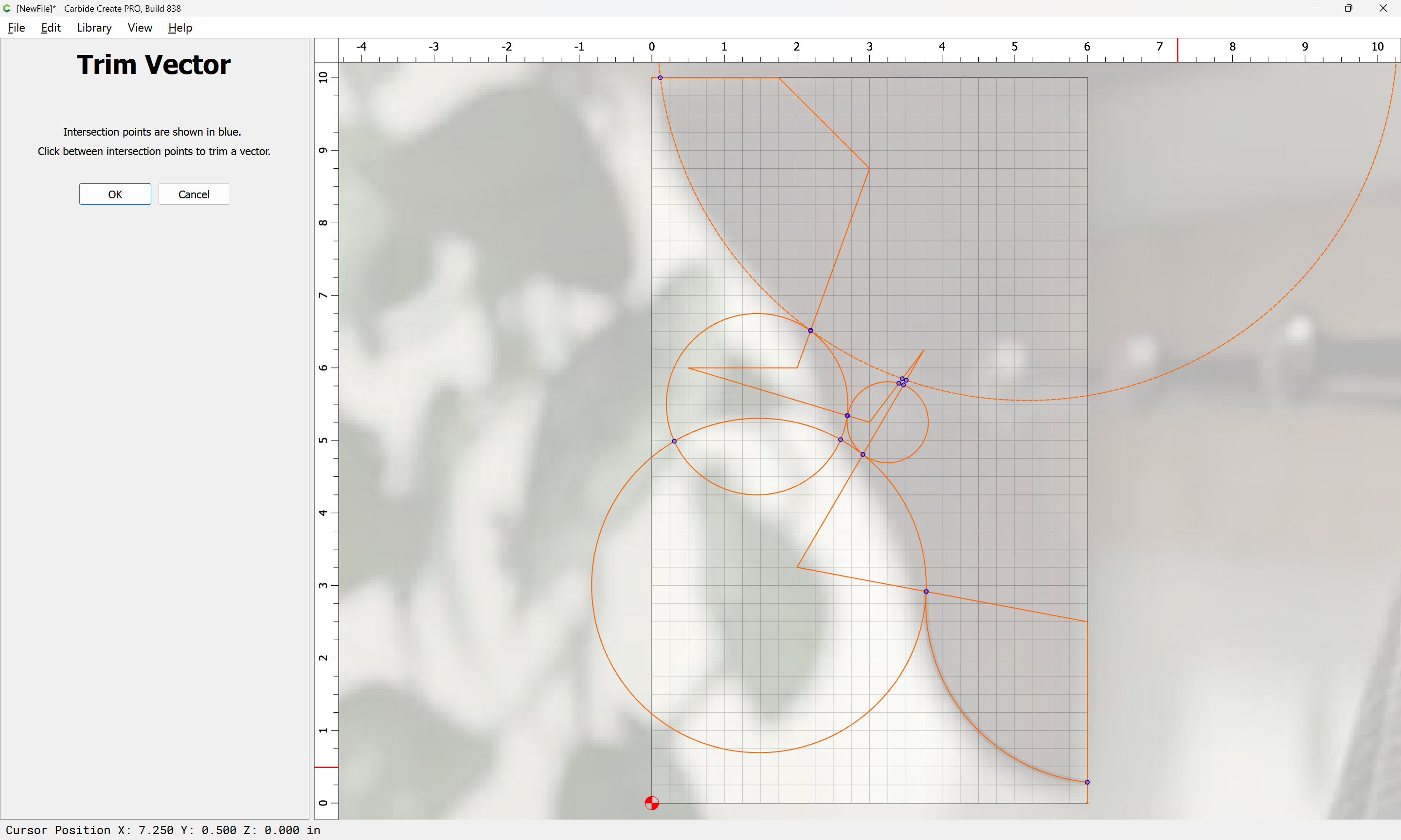

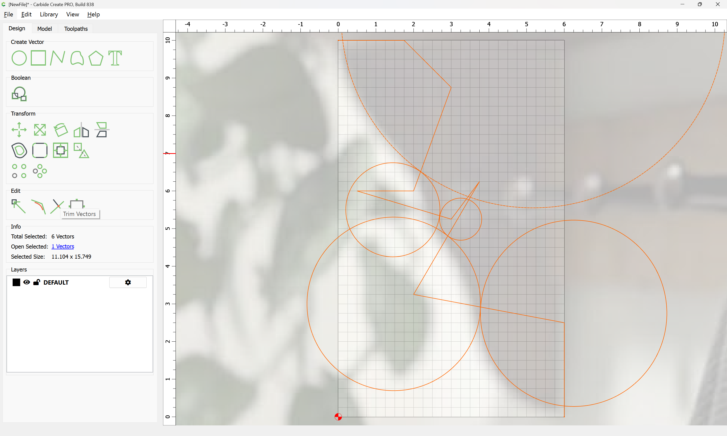

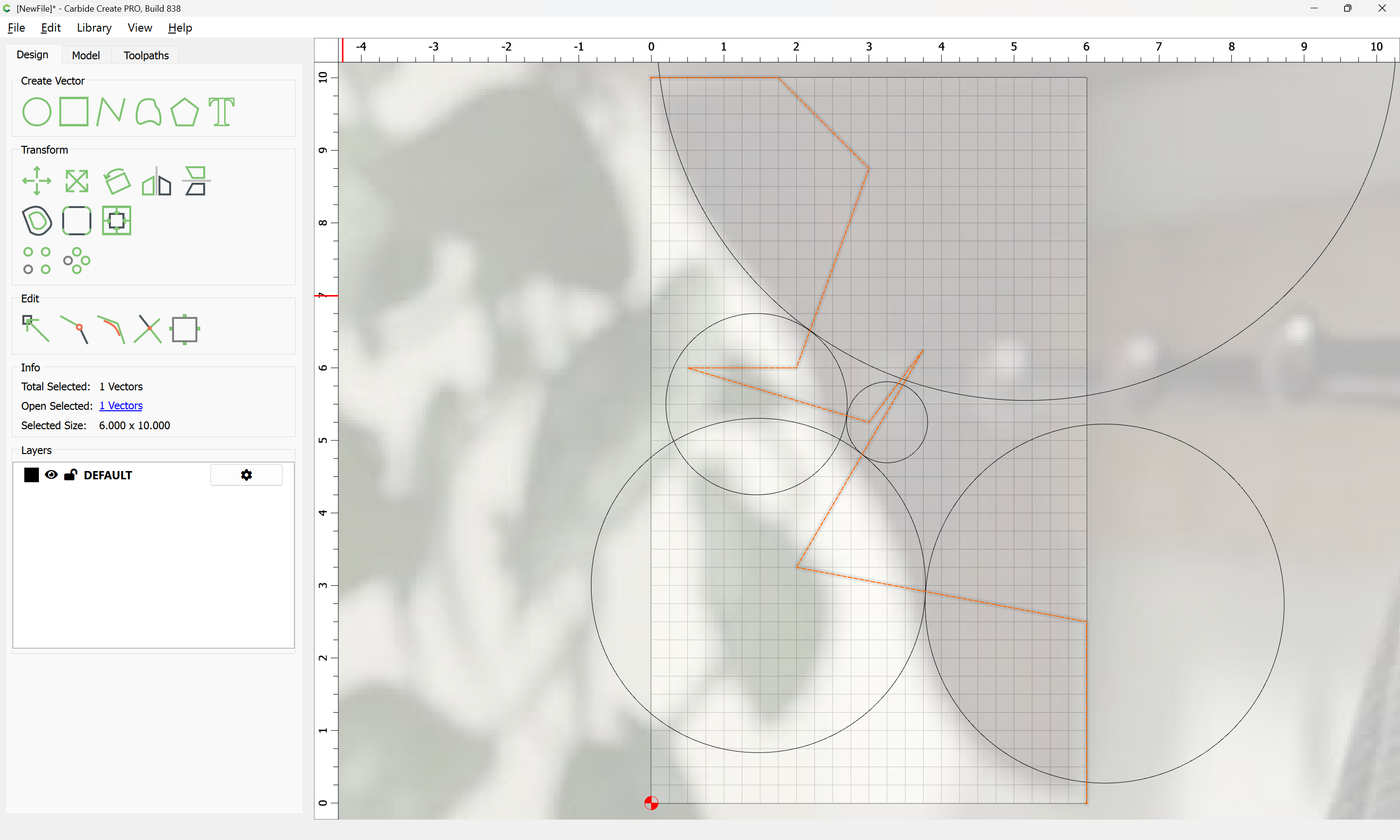

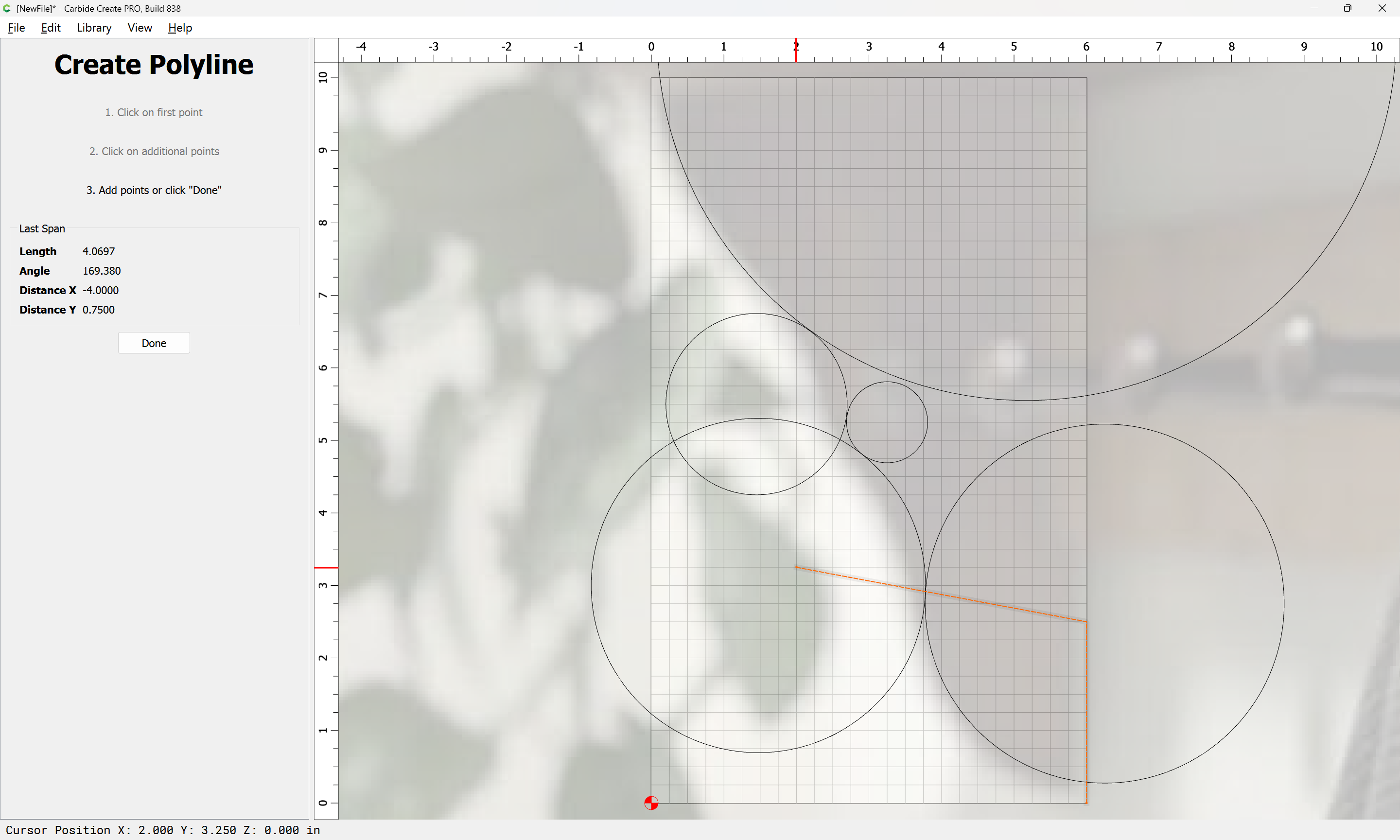

Then draw in some lines to divide things using Trim Vectors:
Done

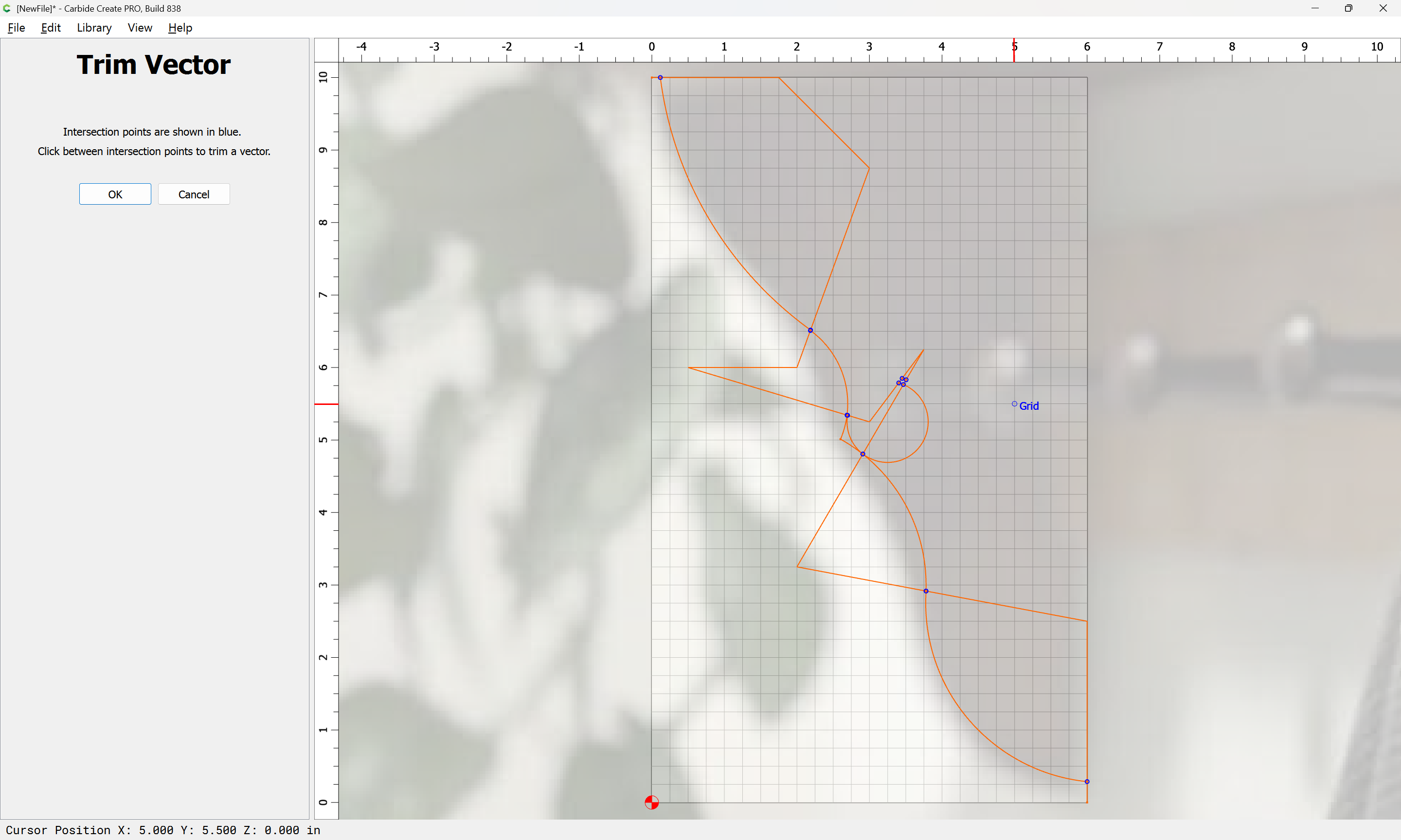

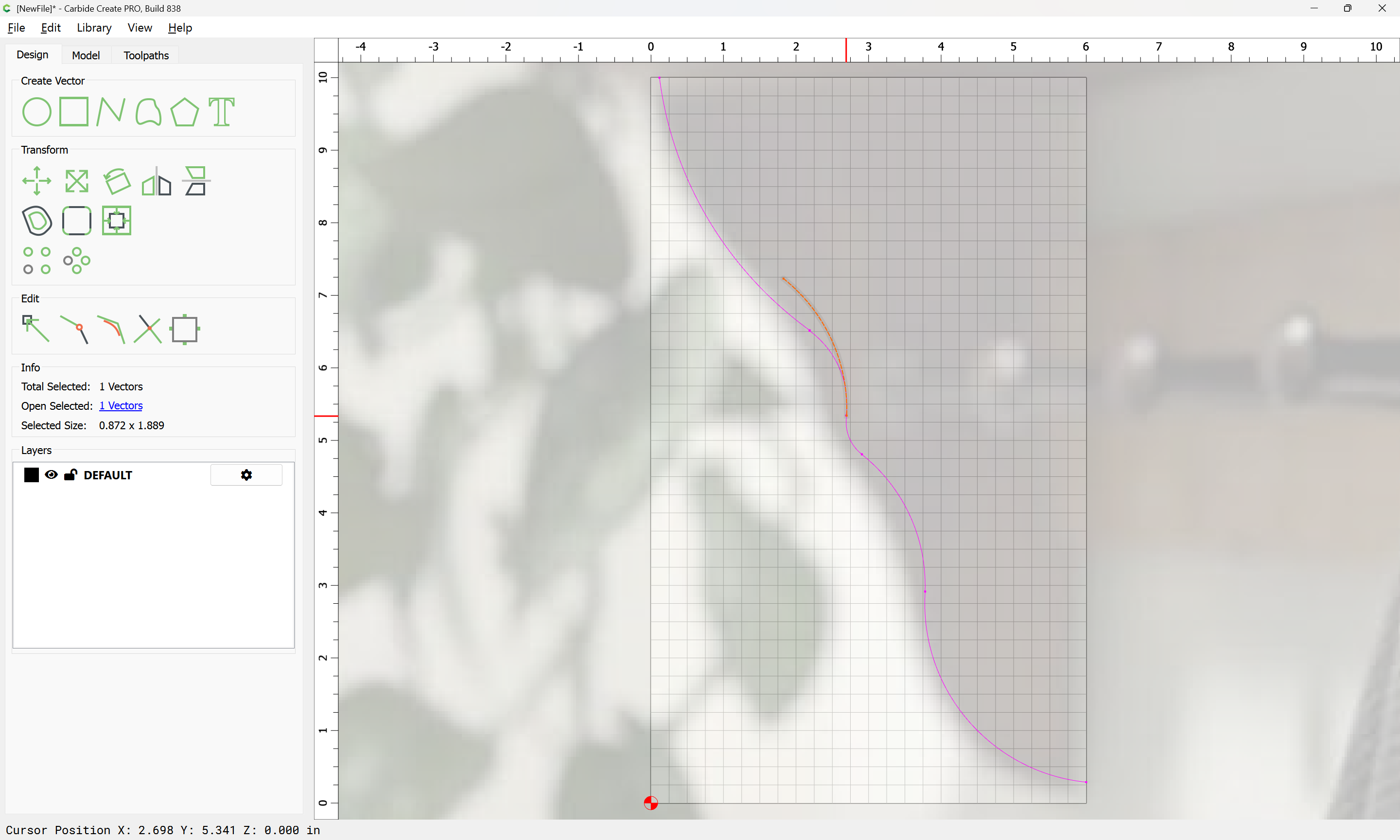

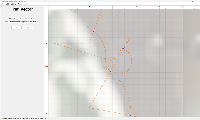

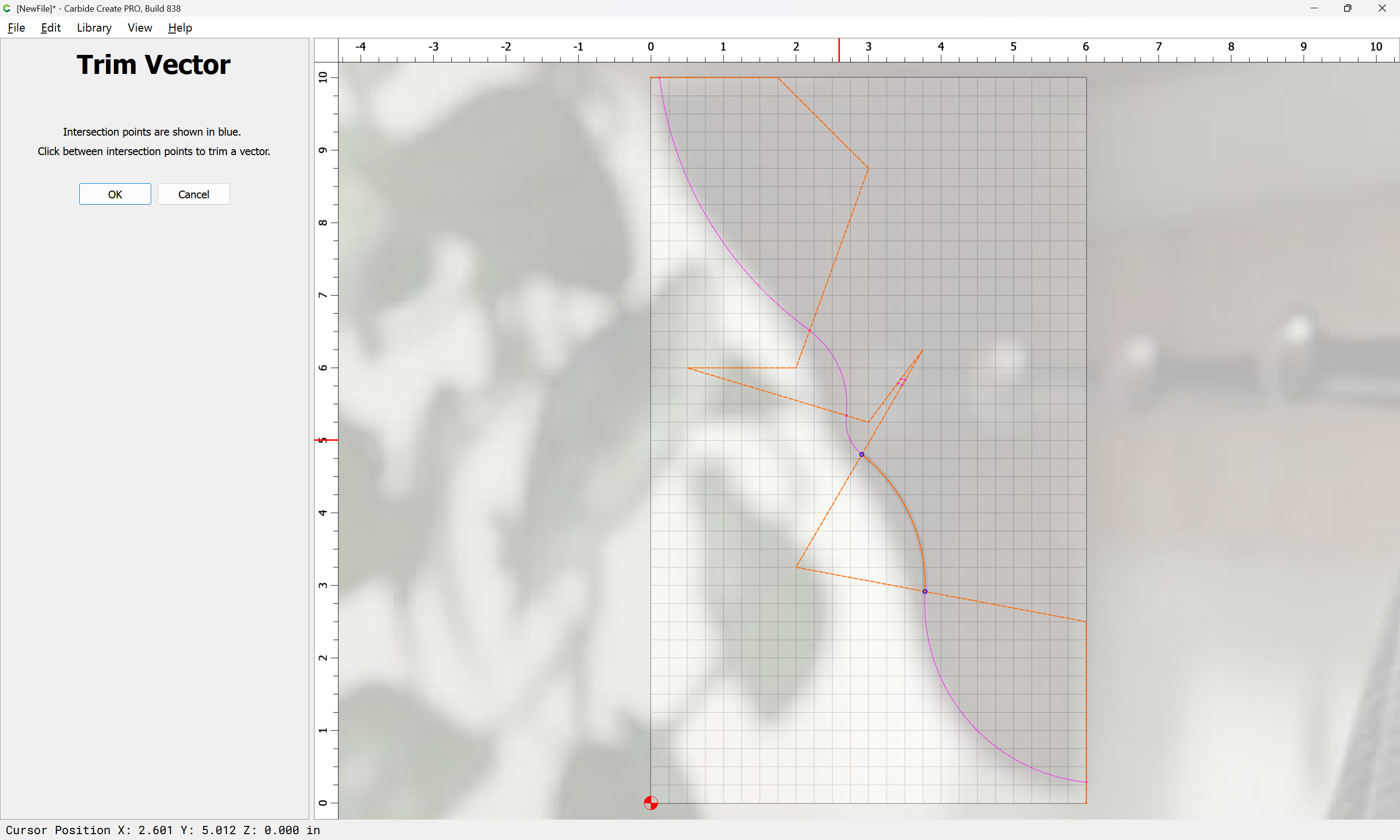

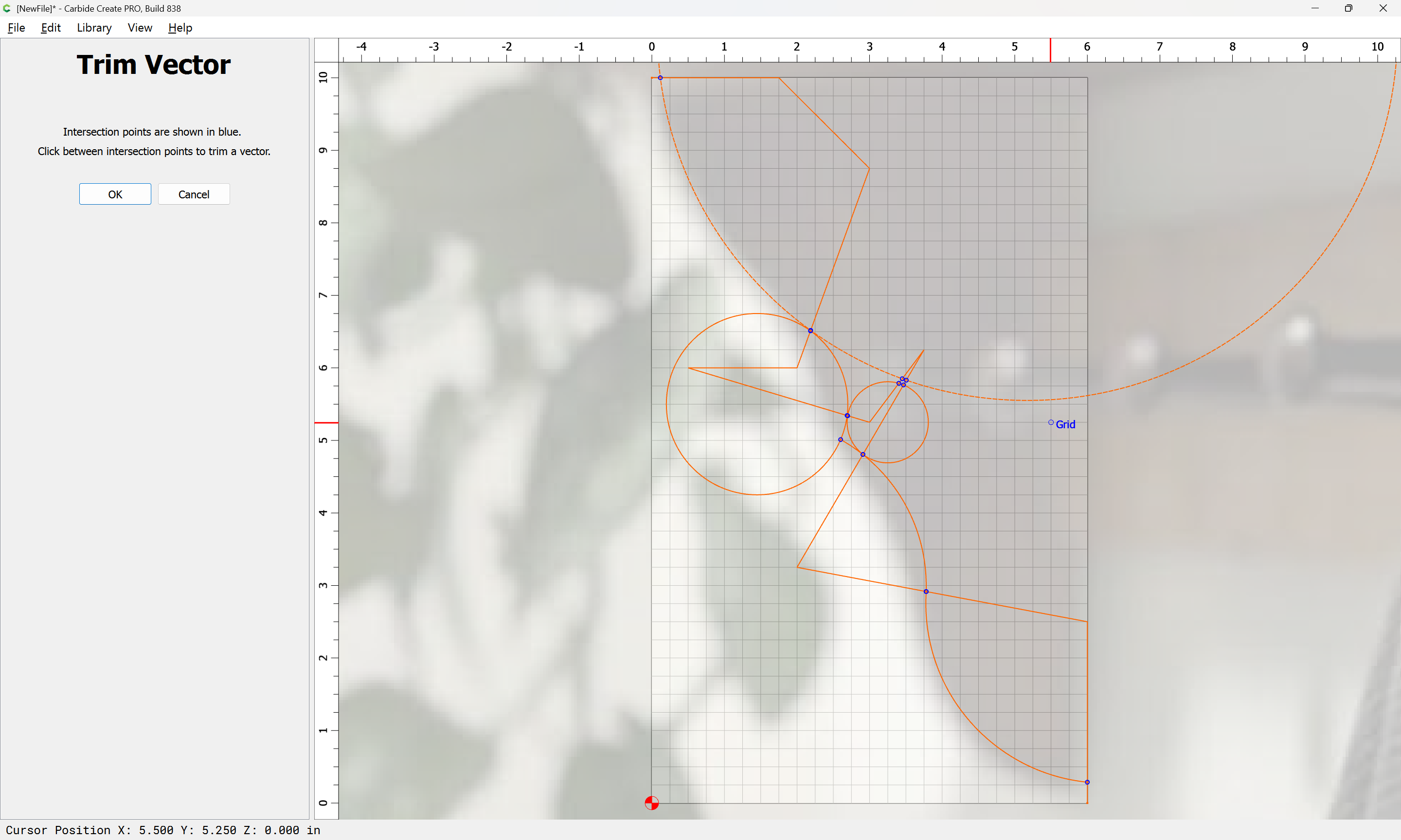

Then select everything and use Trim Vectors to remove what is not wanted:
If need be, OK

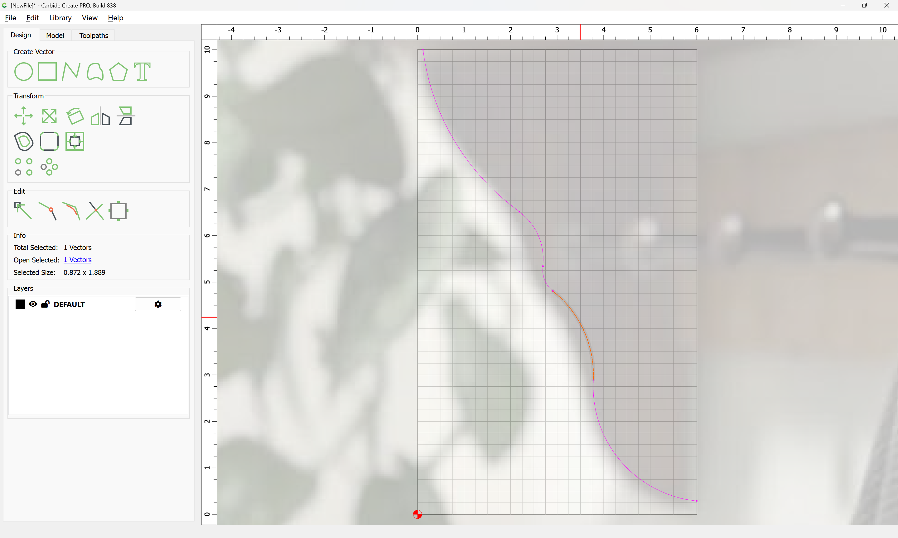

Deselect what is compleat:
and try again:

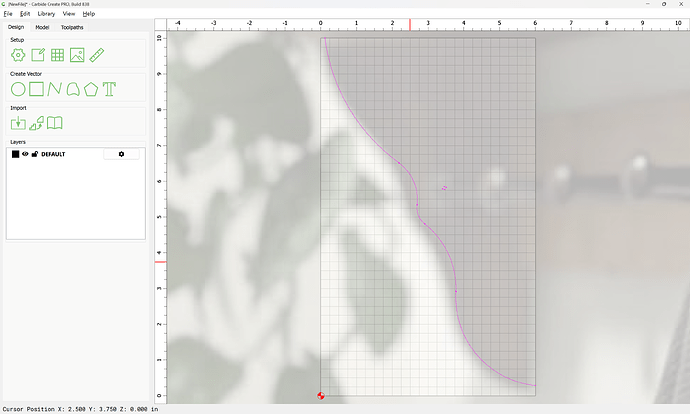

until one arrives at:
Delete the construction lines:
and if desired, re-use and adjust elements:

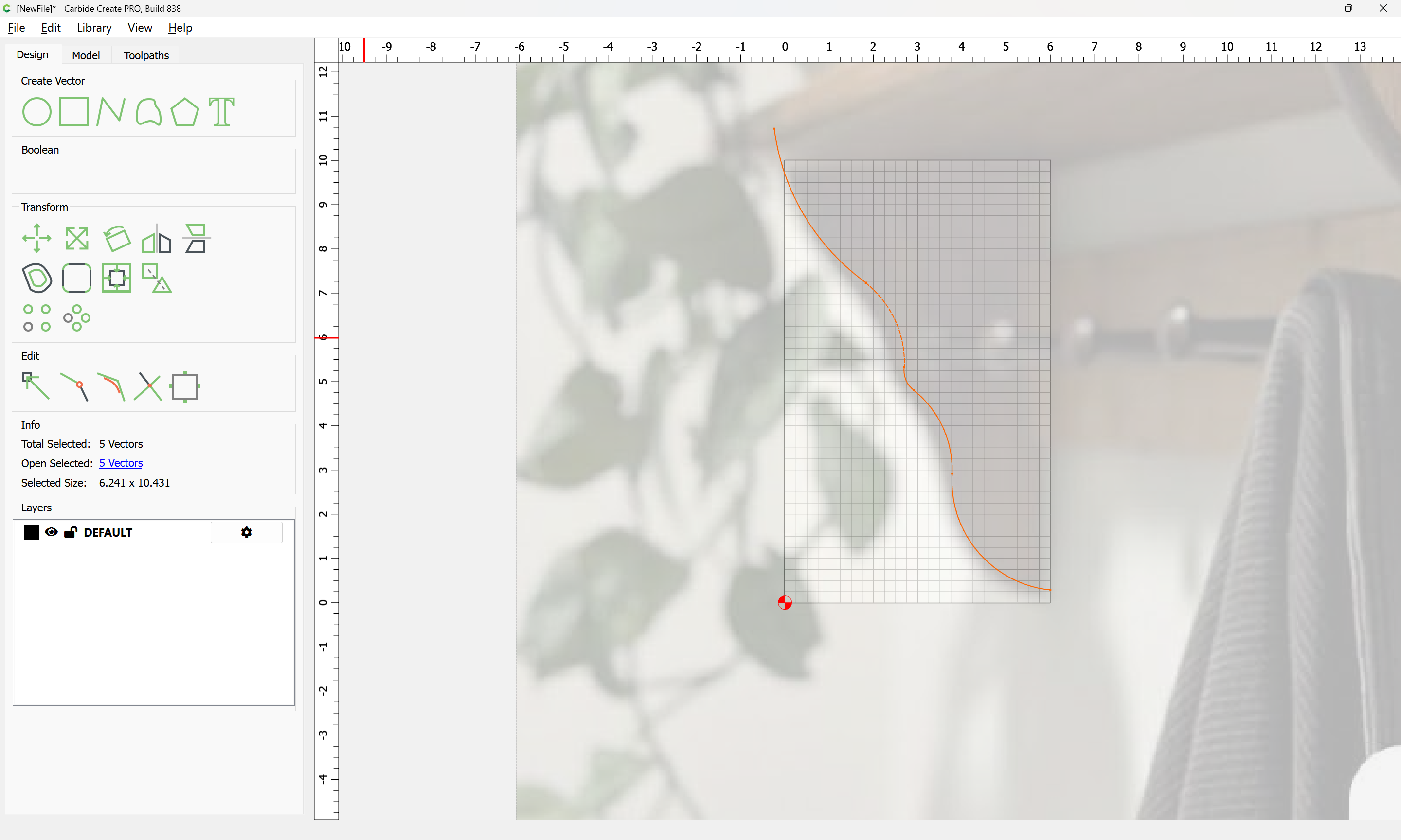

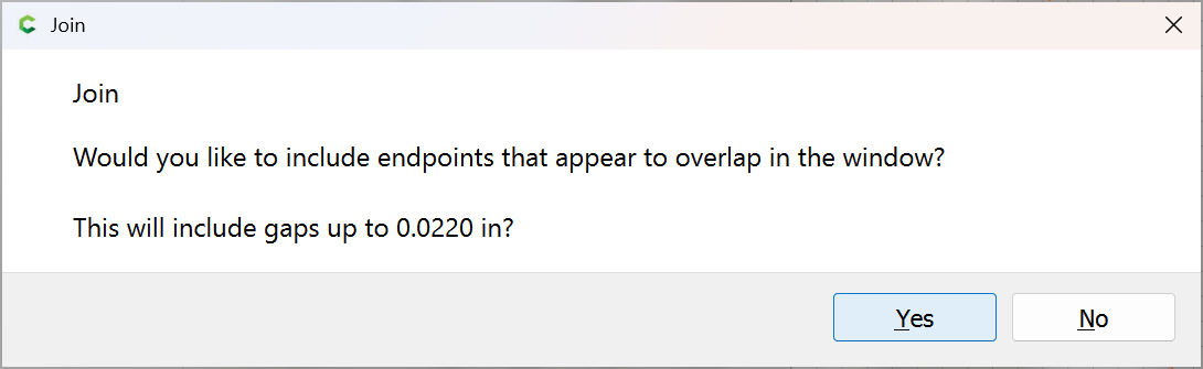

Select all:

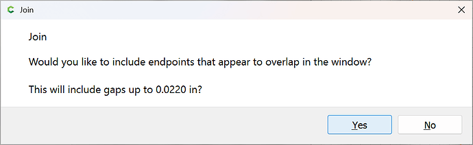

Join Vectors
Yes

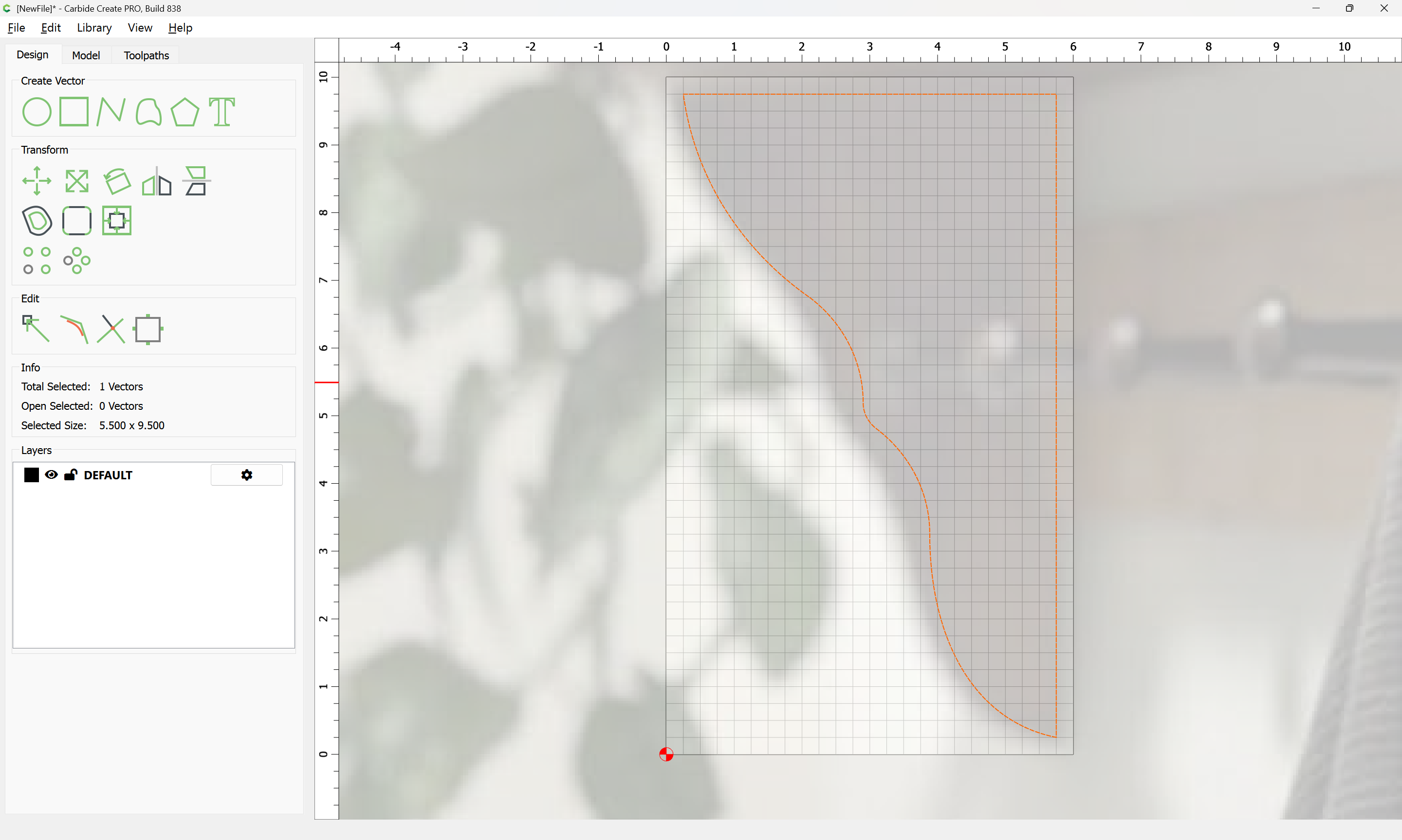

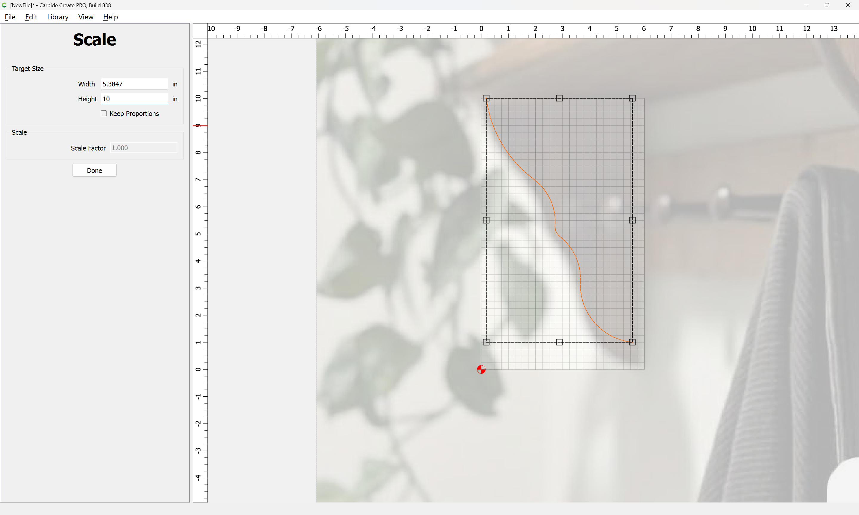

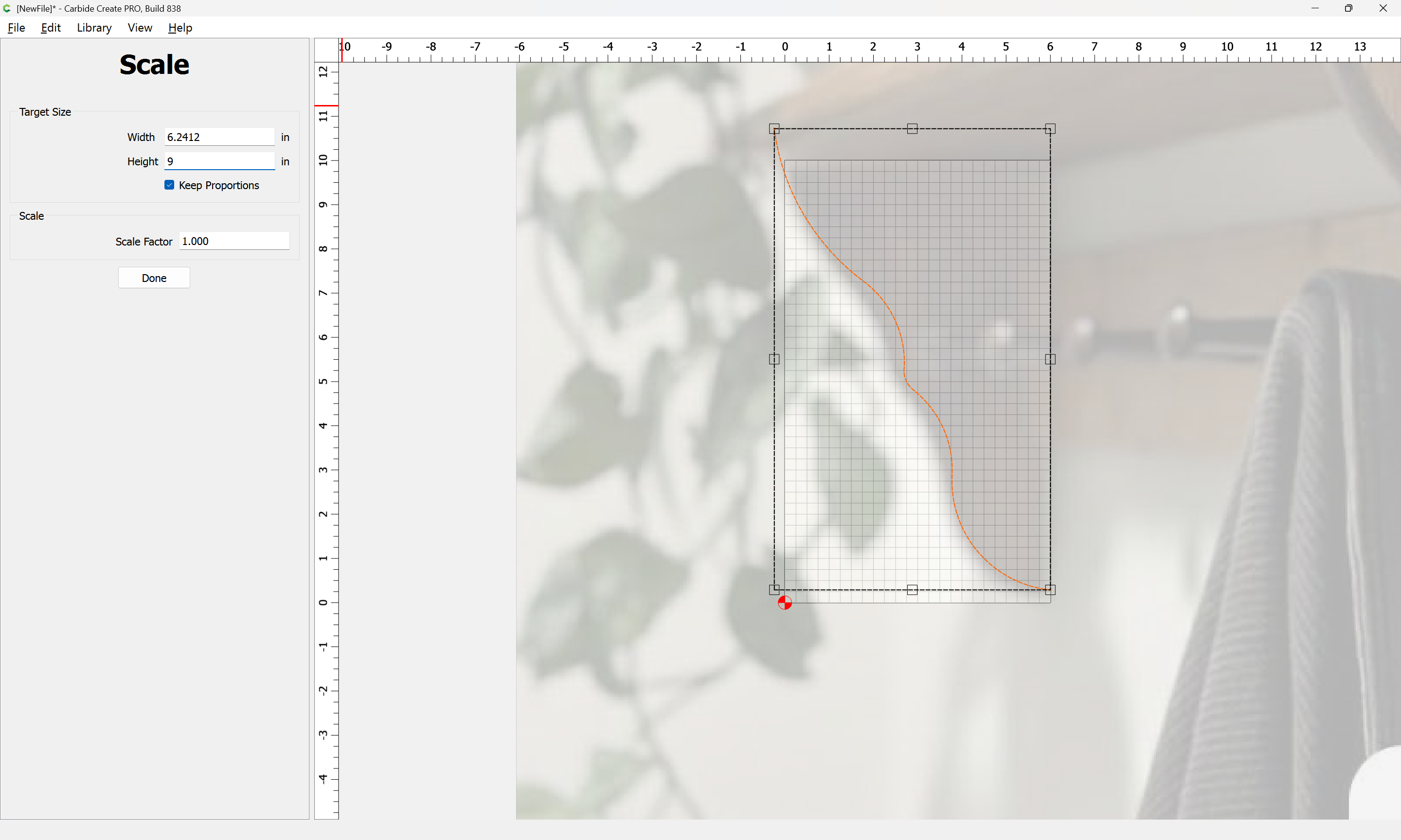

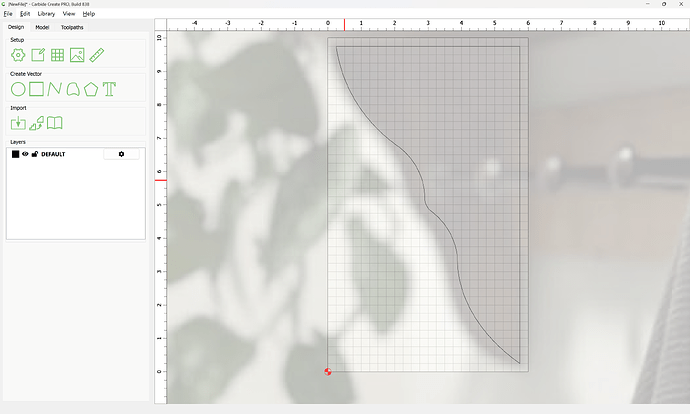

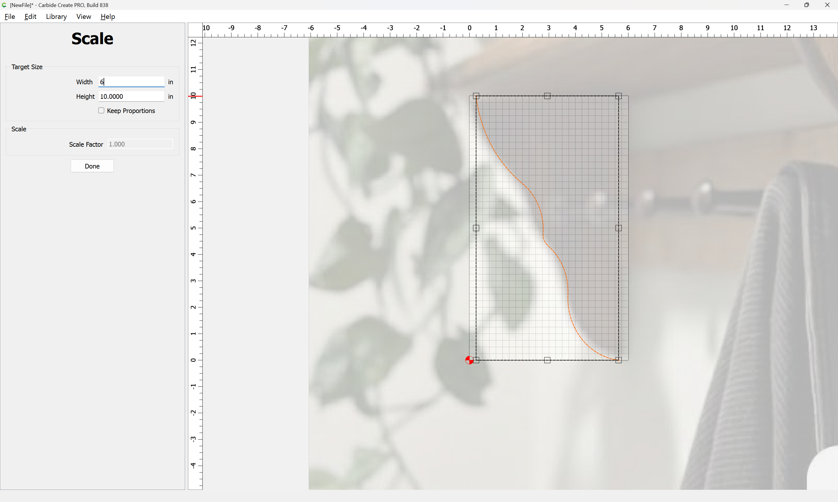

Adjust the scale:

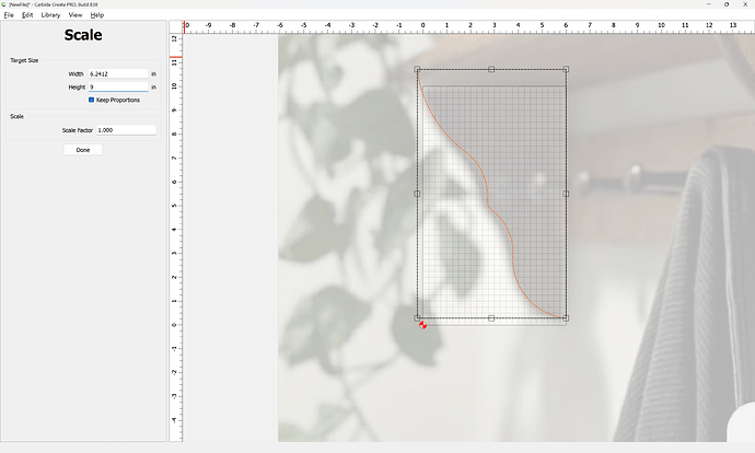

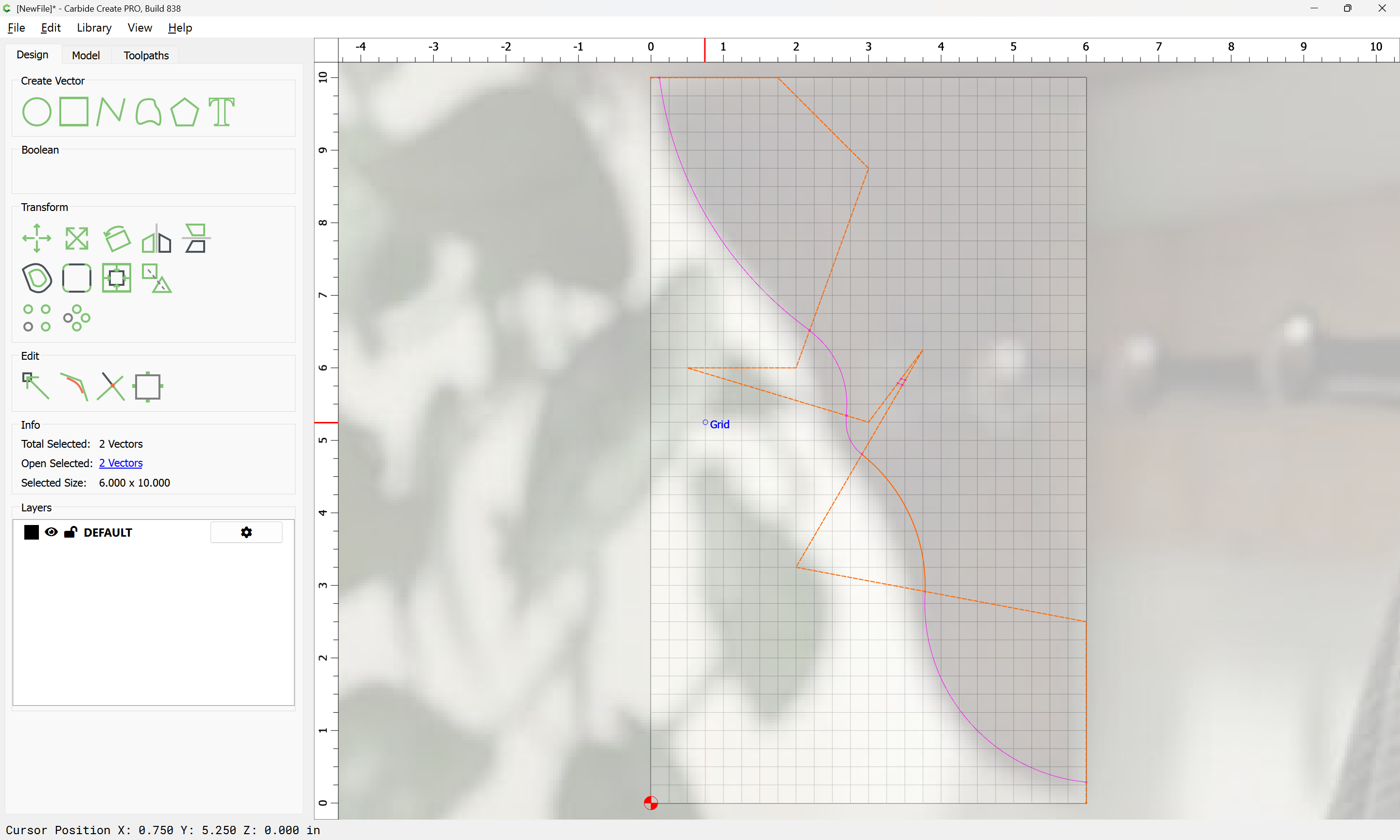

Adjust until one arrives at something pleasing:

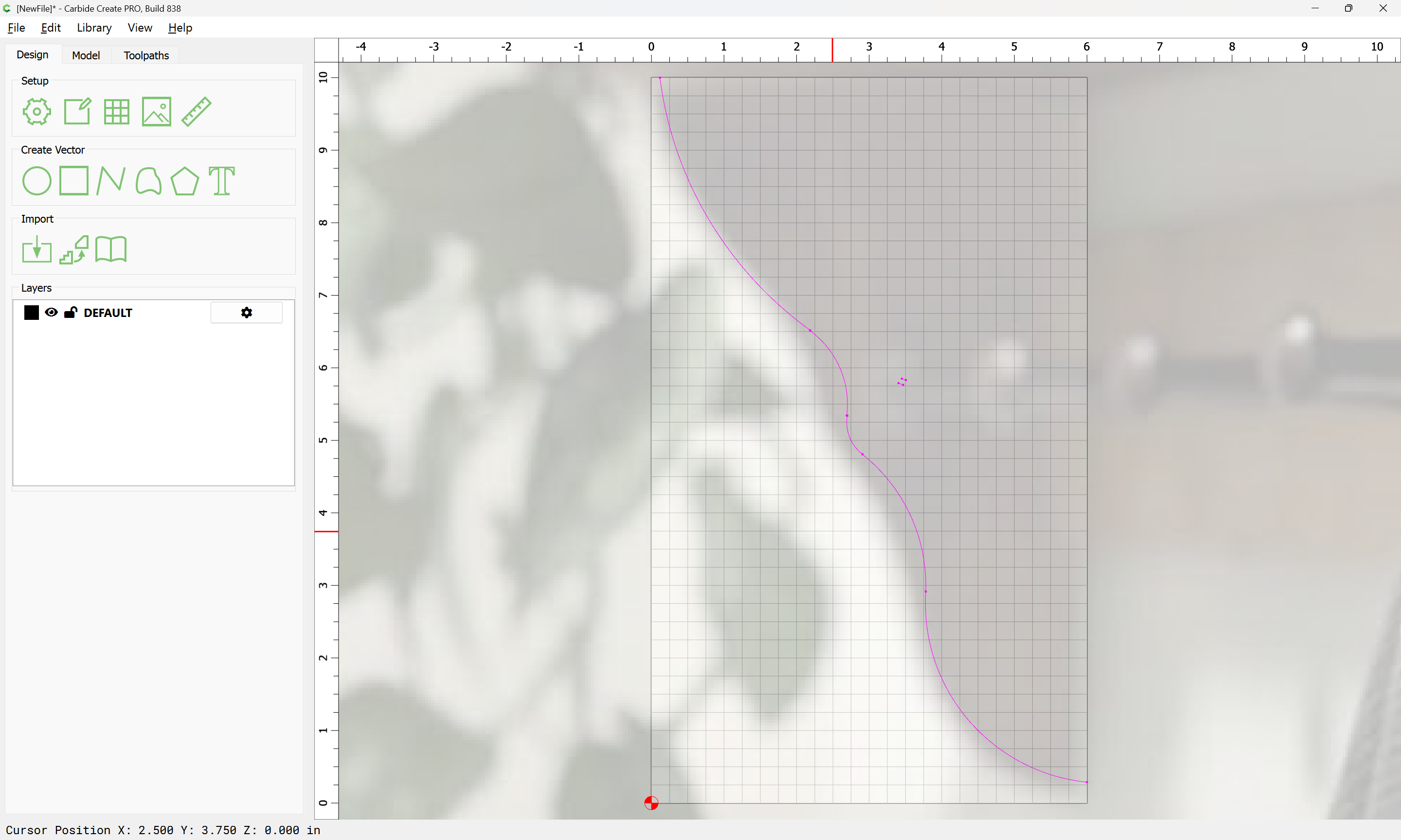

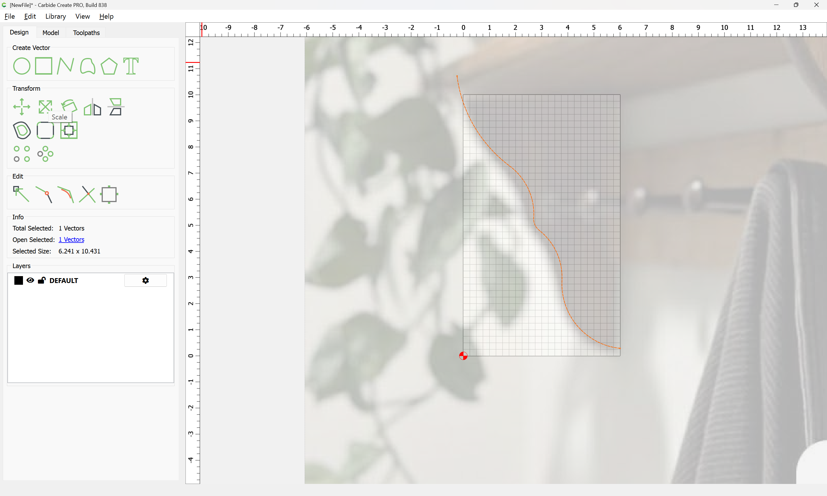

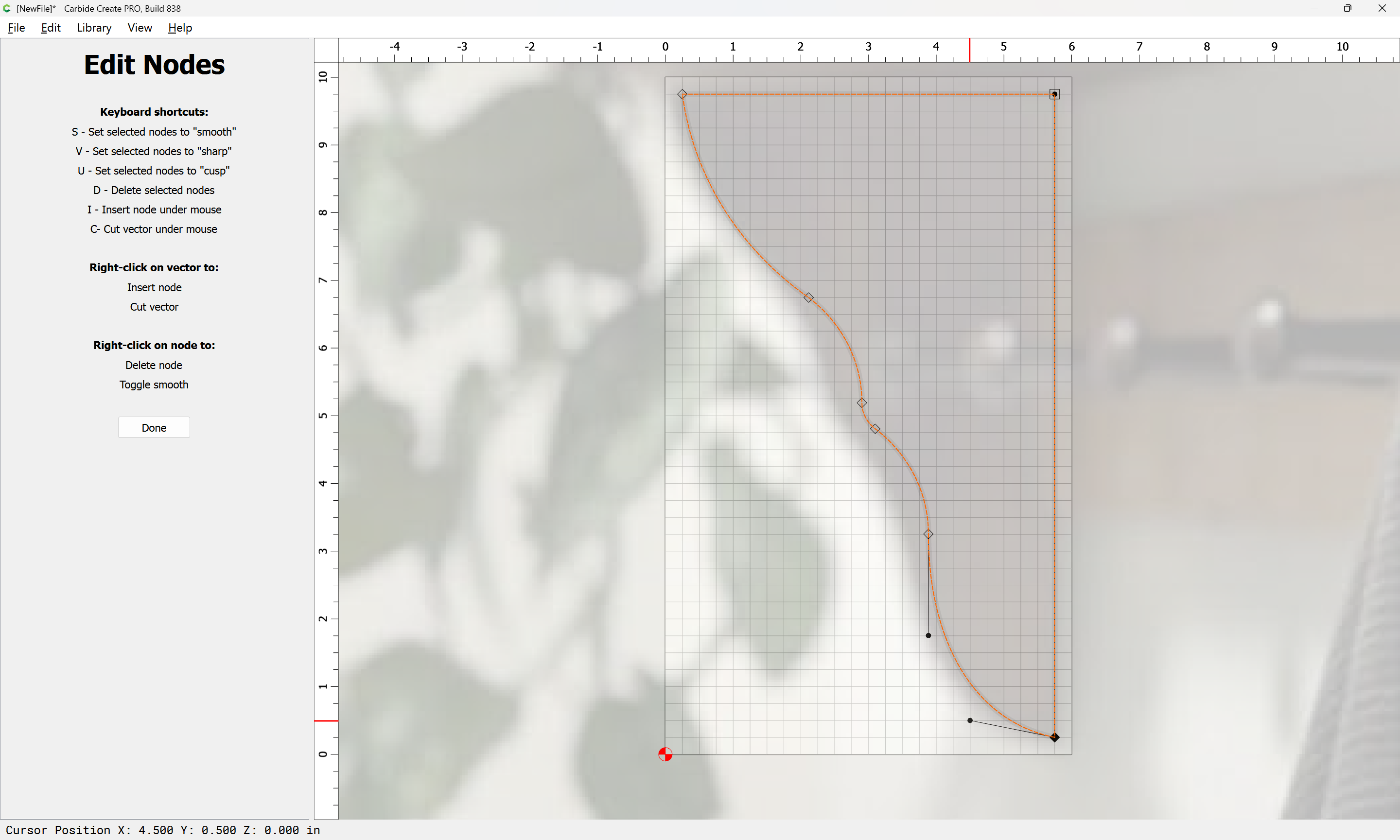

Then draw in the edges:

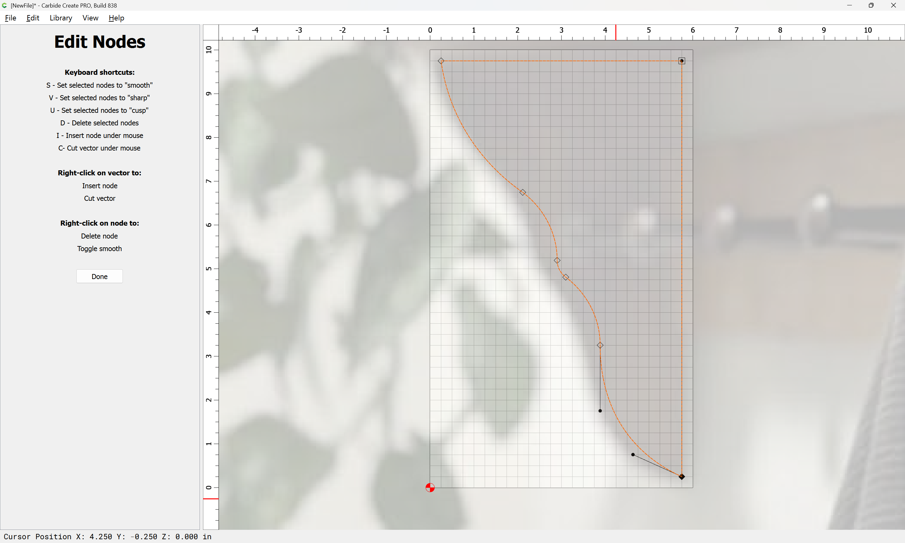

and Join Vectors, and if desired, further adjust using Node Editing:
Attached as a v8 file.
