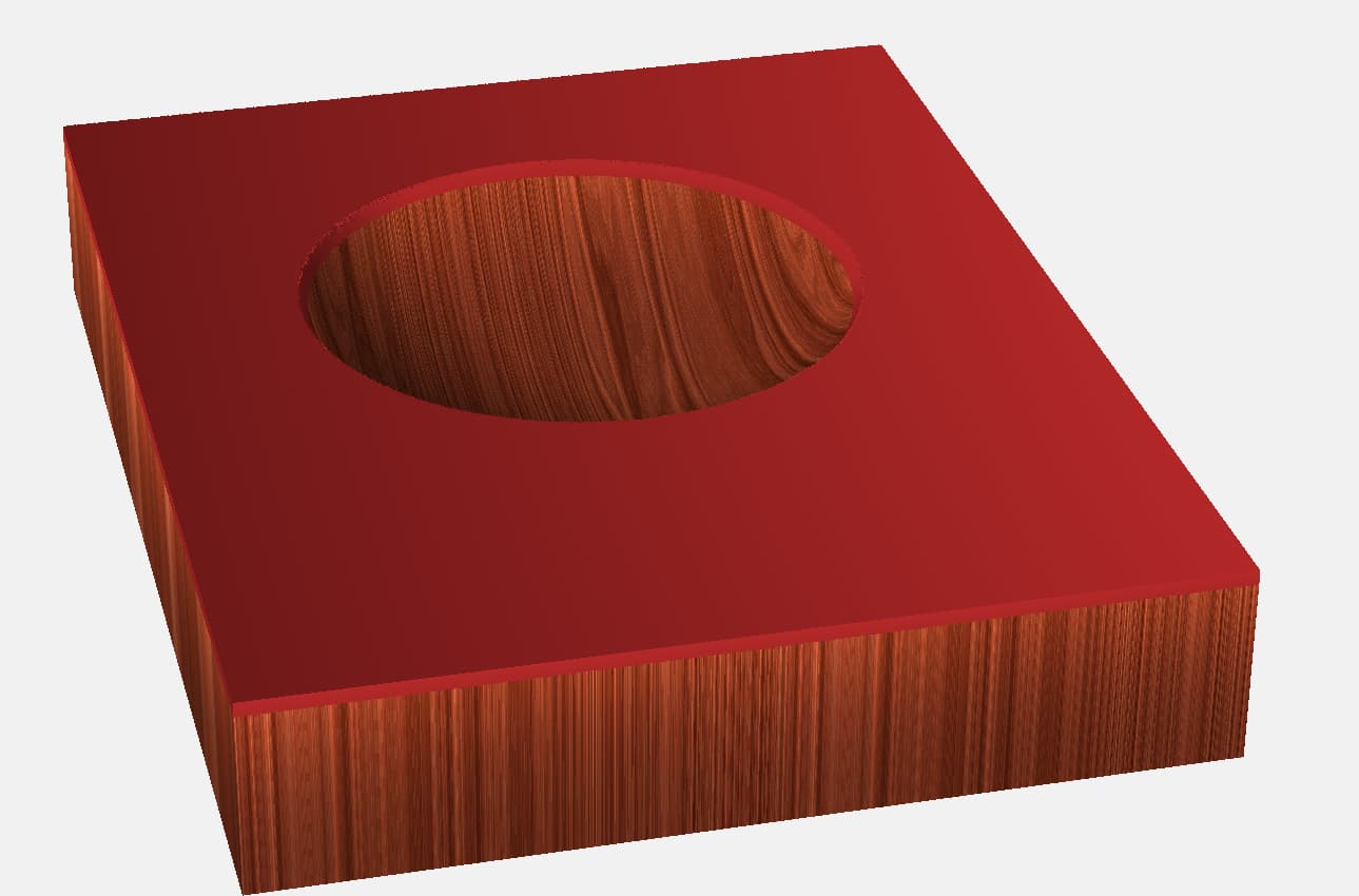

Red layer in 3d view (Carbide Create Pro)
I am trying to design a 3D model in Pro and am getting this red layer on top. What is causing it and how do I correct it
This is intended as a warning that the 3D model has been made higher than the stock thickness.
They are the same though. It did not seem to interfere with the cut though so I guess it is fine. Thanks Will
The depression is probably less
Deep than you expect by the thickness of the red layer.
