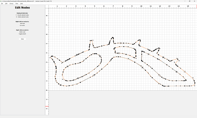

Select everything and go into Node Edit mode:
Select all of the nodes:
and choose “Smooth”
Where necessary, re-select and smooth again:
Then, adjust nodes and their placement so as to arrive at the desired shape:
if need be, right-click to add a node:
Continue this for all other shapes until one arrives at:
