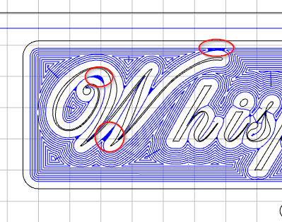

Still relatively new…Here is file with a pocketing operation at the top. Using 1/16 seems to get better detail but takes along time. I started with 1/8 but concerned with detail. Any thoughts?
Wisper Louise v3.c2d (592 KB)
i know i could change the font but trying to match to original. And my board size is fixed.
I’d go back to the 1/8" & set the depth per cut to 0.095. Instead of 10 levels at 0.020, you will have 3 levels at 0.095, 0.190, and 0.200 (The last taking only 0.010 for a finish cut).
As long as you have enabled the clearing bit, the vee bit will clear out the corners that the end mill couldn’t get to. So you’re not sacrificing any detail either way.
When you zoom out, the darker blue areas are where the vee-bit is doing the clearing.

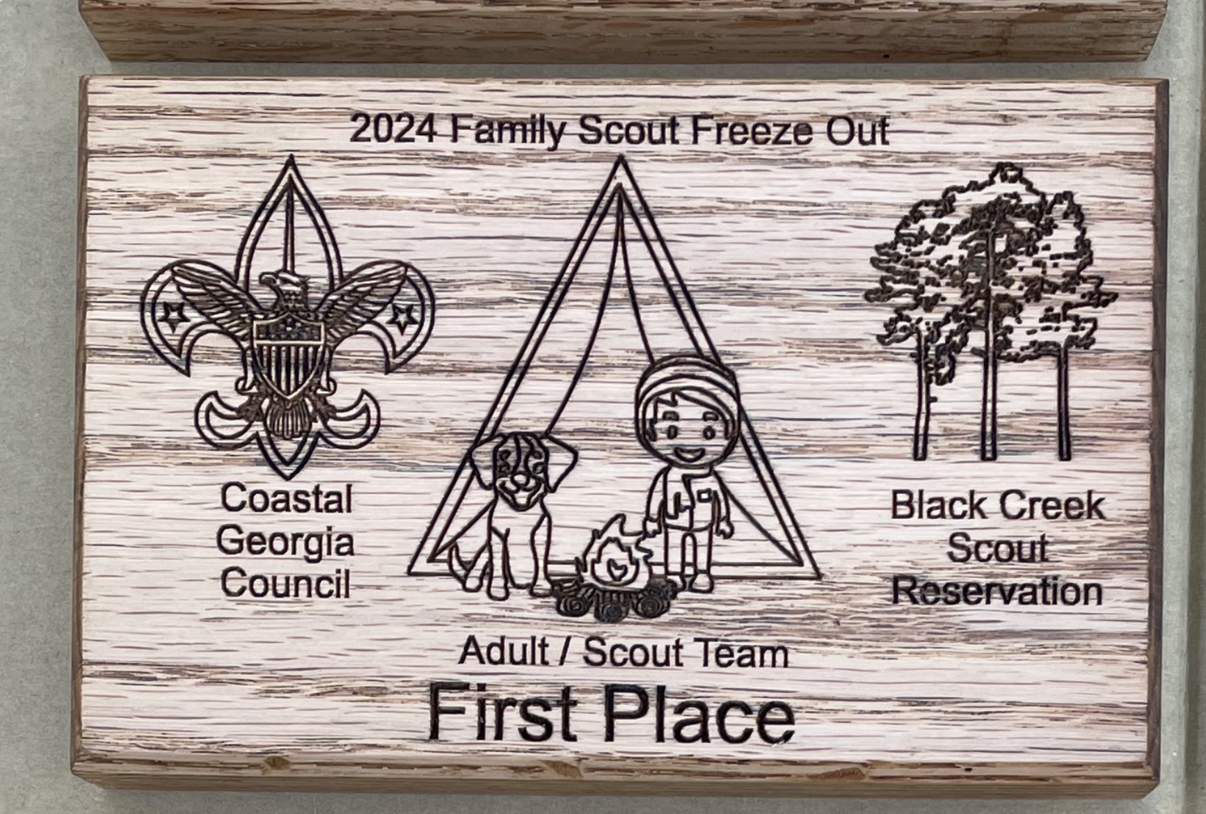

I tried a sample cut in red oak over the weekend to see how some of the elements would work. Of course they liked the more detailed eagle which takes 50% of the time. Here I used black CA rather than epoxy just so I could get it dried and sanded more quickly.

Well, the Boyscout camp provided the wood. I think it is white oak, but could be red. Unfortunately they “helped” by cutting all the pieces, but not very straight so I had to clean them all up and lost some size. Finished size was 5x7.75.

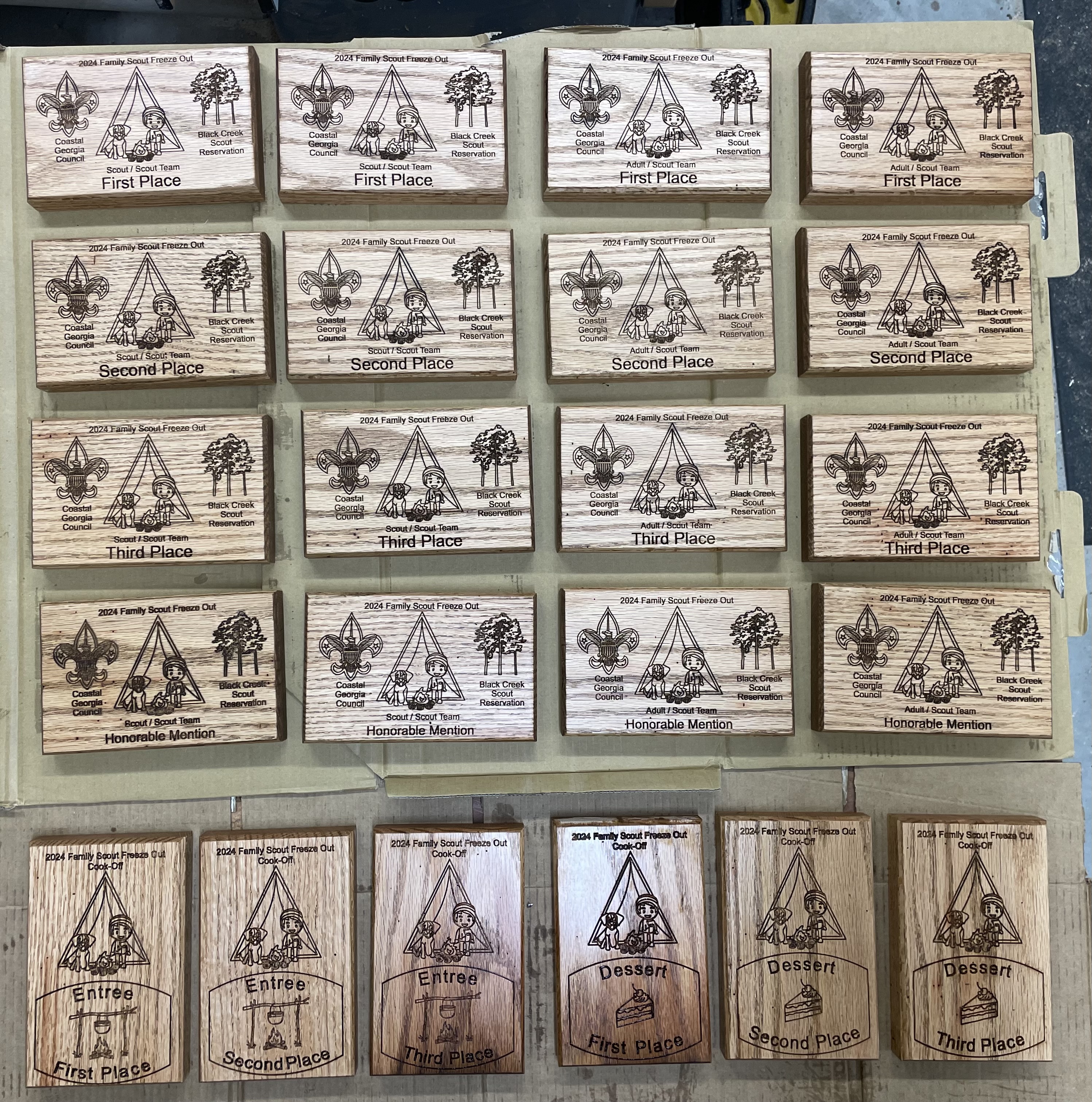

I had a busy weekend making 26 of these. Complete with a slight chamfer and keyhole slots on the back. They are coated in Danish Oil. I am not sure if will topcoat them or not.
Since it is oak and the graphics are detailed and small I lost some pieces here or there like the stars in the crest on the eagle. I originally planned to fill with epoxy and flatten but the “customer” liked the carved look instead.
The tent with the boy and dog is the logo for the event. They are giving patches to all the participants with that design. The pine trees are the logo for the camp.
The random dark spots on some are worm holes. Some had quite a few. Not ideal but since the wood came from the camp it tells a story.
To save time changing bits I cut the design in all of them, changed and cut the chamfer,
Changed and cut the keyholes.
