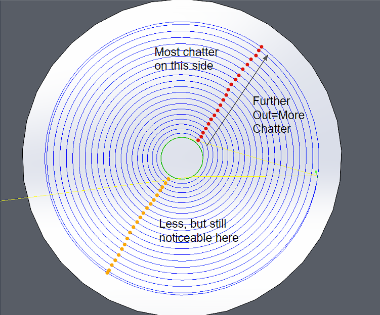

What could be causing me to get chatter while adaptive clearing on my Shapeoko 3 happening always on the same spot in aluminum (Dots on the picture show where it happens. Same spot every time and more significant on the red side than on the orange)? It gets worse with higher DOC but doesn’t really seem to go away. Wondering if there’s an easy fix because I feel like it’s the main thing preventing me from speeding up roughing more. Everywhere else along the cutting path it is completely smooth. I haven’t had chatter problems with other toolpaths and the problem persists across a range of tool sizes and flute counts, with a variety of feeds, speeds, and depths. One problem I know that I haven’t been able to test yet is my surface speed is a little low (550-650 sfm) but I’m not confident going up to 800+ sfm could fix this rather weird issue. Any advice?
This pattern is where the Y axis is moving more. Since an SO3 check your v-wheels on x and y. Power off Shapeoko and wiggle side plates on sides of gantry. Slowly push gantry forward and back slowly and side to check for mechanical issues. Move project to another location to see if problem persists. Likely a mechanical problem. If it is a roughing pass does this happen on finishing pass?
I get the exact same thing on my SO3 (original). I get the same when profiling the outside of a part as well. I’ve tightened belts and v-wheels as much as I can, but yeah my wheels still are not as tight as I would like, I think adequate though. But I wasnt ready to take it down and file the holes yet. I do agree that there must be some “loosness” in the system some where. But it is a plastic v-wheel machine so that is a given.

I would challenge that this is where the Y is moving more. Y would be moving more from 3:00 (or 9:00) to this position, and X would be moving more from this position to 12:00 (or 6:00). This position is where they are moving exactly the same velocity for a split second (and the farther out you go the longer this overlap is, hence more chatter). That sounds like a perfect opportunity to set up a resonance and amplify the “loosness” mentioned above for that split second. But why then not at 10:30 and 4:30 positions which have the same situation? I can only imagine cutting forces and tool rotation are the other variables that are at play here.

I’ve already tightened my v wheels but I could probably spend some time to get it more perfect. Yes this is a roughing pass, it doesn’t happen on my finishing pass which is just a contour that takes of the .005” radial stock to leave—not enough stress on the machine to cause any of this chatter. I should definitely try to go as far away from where I typically cut as possible to see if that helps. Is there any chance switching from climb to conventional milling could help? A random thought I had

Update: After doing some cleaning of my v wheels, rails, and the inside of the collet holder, the problem is (mostly) gone. Messing around with settings did not seem to remove the problem, but I am now running about 2.5x higher MRR with little chatter, which is good enough for me for now.
