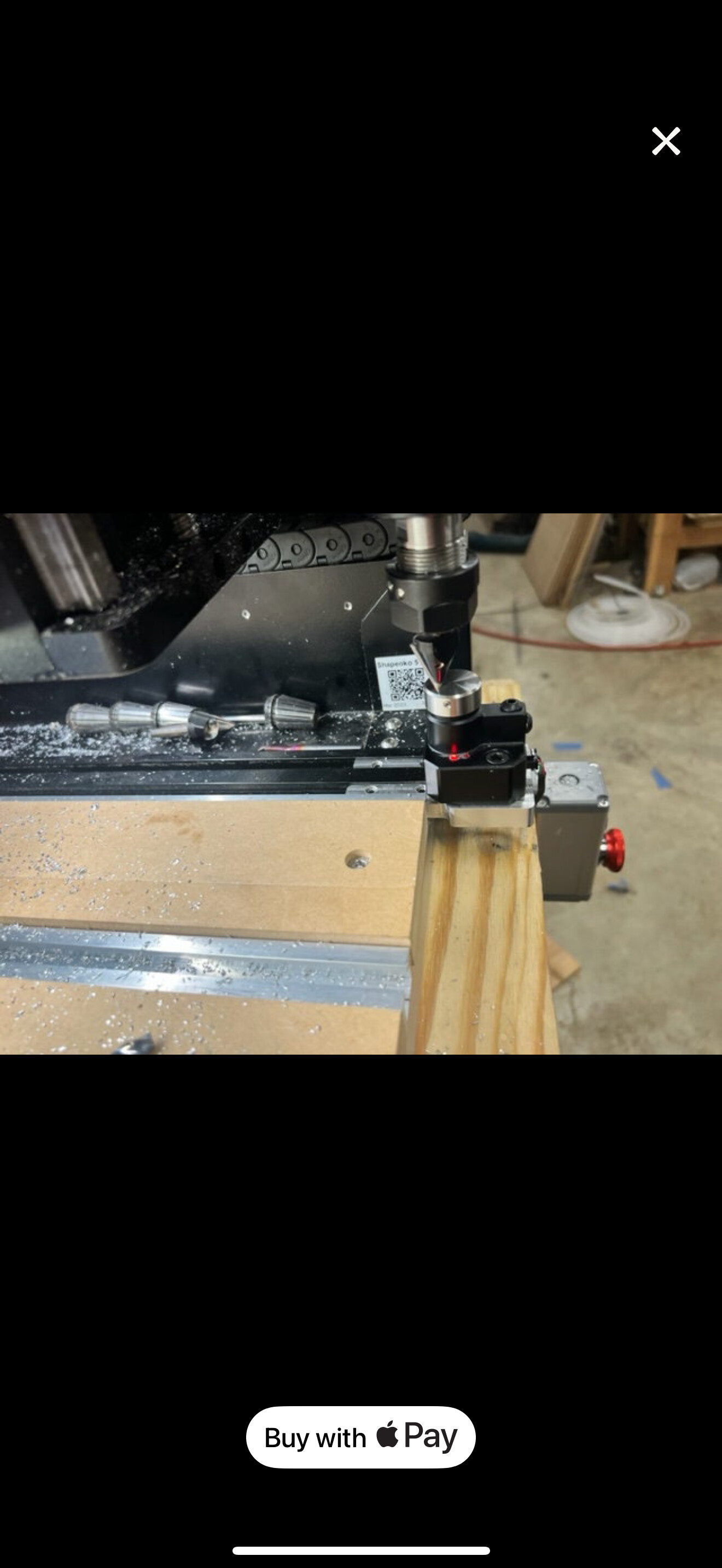

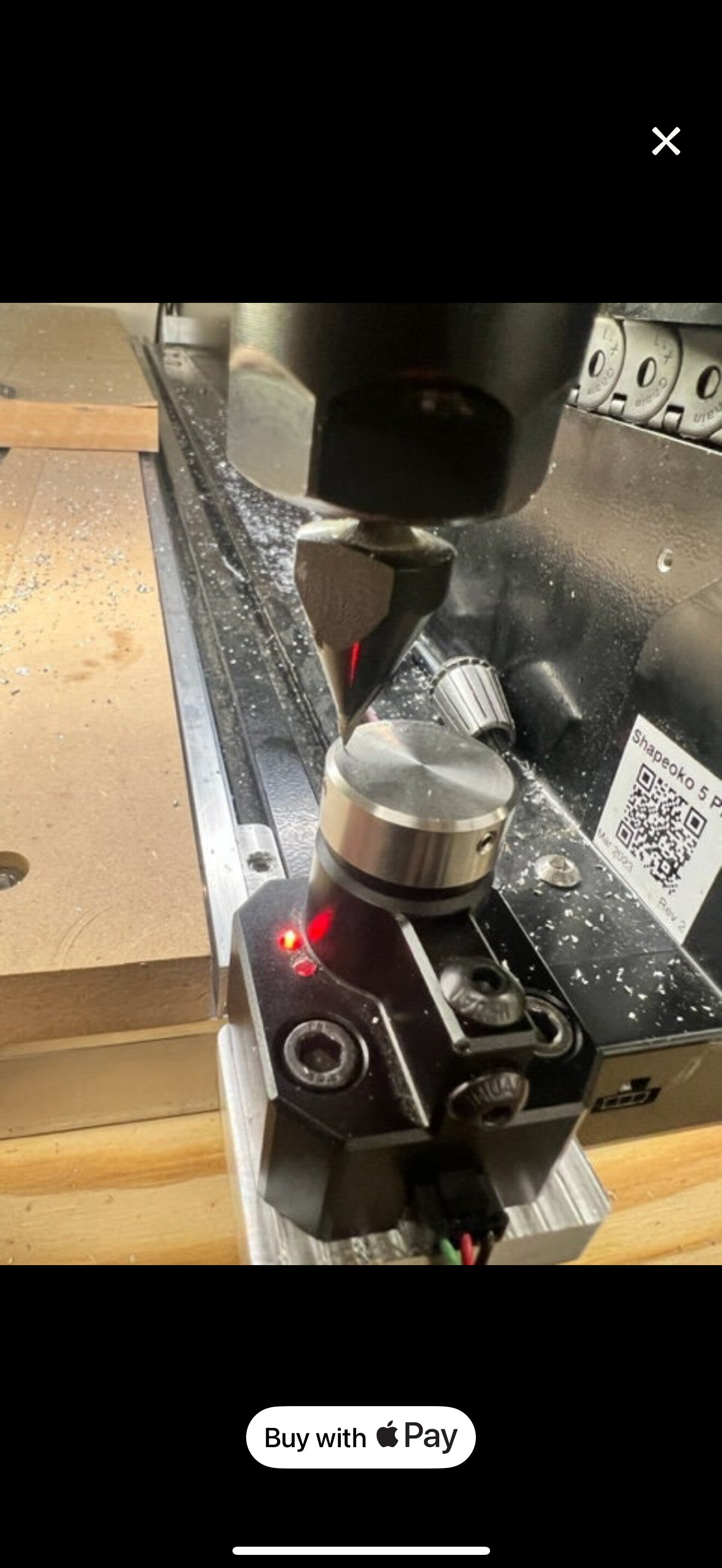

Hi all, i am setting up my Shapeoko 5 4x4 for sheetwork. I love the bitsetter but find it in the way. I have to program around it so the sweeoy does not collide with it, not to mention i lose 3 to 5 inches of useable workspace. Has anyone done a relocation of the bitsetter and how would i accomplish this task?
Suggestion is usually disconnect BitSetter after the tool is measured. There is no where to move it fully outside the cutting area because it has be to within the gantry’s travel.

I had sketched out a box about 2X by 6Y in from the front right corner on the spoilboard. The spindle/bit center has to avoid to have no collision.

Short term for one operation I removed and set it back between carves to measure the bit. I have been tinkering with designing a “swing arm” type adapter that allows it to swing out of the way and then back when needed. I have also thought about mounting thru the table somewhat like the Nomad design is. I would rather not go that route yet.
Like most things in life, it’s a trade-off — if one implements “Gantry Shift”:
then one loses ~3.2" of travel at the back (I machined the MDF down flush w/ the Hybrid T-track) but gains the ability to relocate the BitSetter forward by that dimension.
The one time I needed to work with a full sheet of plywood I planned out the parts so that there were unused areas at each tile position corresponding to the BitSetter position, marked that out on the plywood before cutting and notched out openings for the BitSetter w/ a jigsaw before machining.
Like @Redlander I’ve been contemplating some sort of swing or sliding mechanism, but I worry about the tolerance stacking of a mechanism.
Thanks, I am also coming to the swing arm conclusion and looking into ways to automate it. To automate it google is saying i would have to use a different controller. Have you come up with a sturdy/ precise swing arm idea yet?

How about the bracket to move the bitsetter forward but then a removeable cap/arm that can be placed on top and reached back to the normal bitsetter location so you don’t need the gantry shift.
If im picking up what you are putting down, you are thinking of a sliding mechanism? If so i think whichever mechanism/slide used would mean having to alter/cut into the t track to allow for the height of thr mechanism, which i wouldnt have an issue with. Finding a mechanism with proper tolerances is the main thing
@Oderusone
In your second photo that shows your collets in the background, I was thinking of fabricating an arm that the Bitsetter would mount close to the vertical of the right Y axis rail that in turn would swing the bitsetter back into position that would allow measurement and then swing back out of the way.
Edit: Sorry, not your second photo but the one Quicky06 posted.
