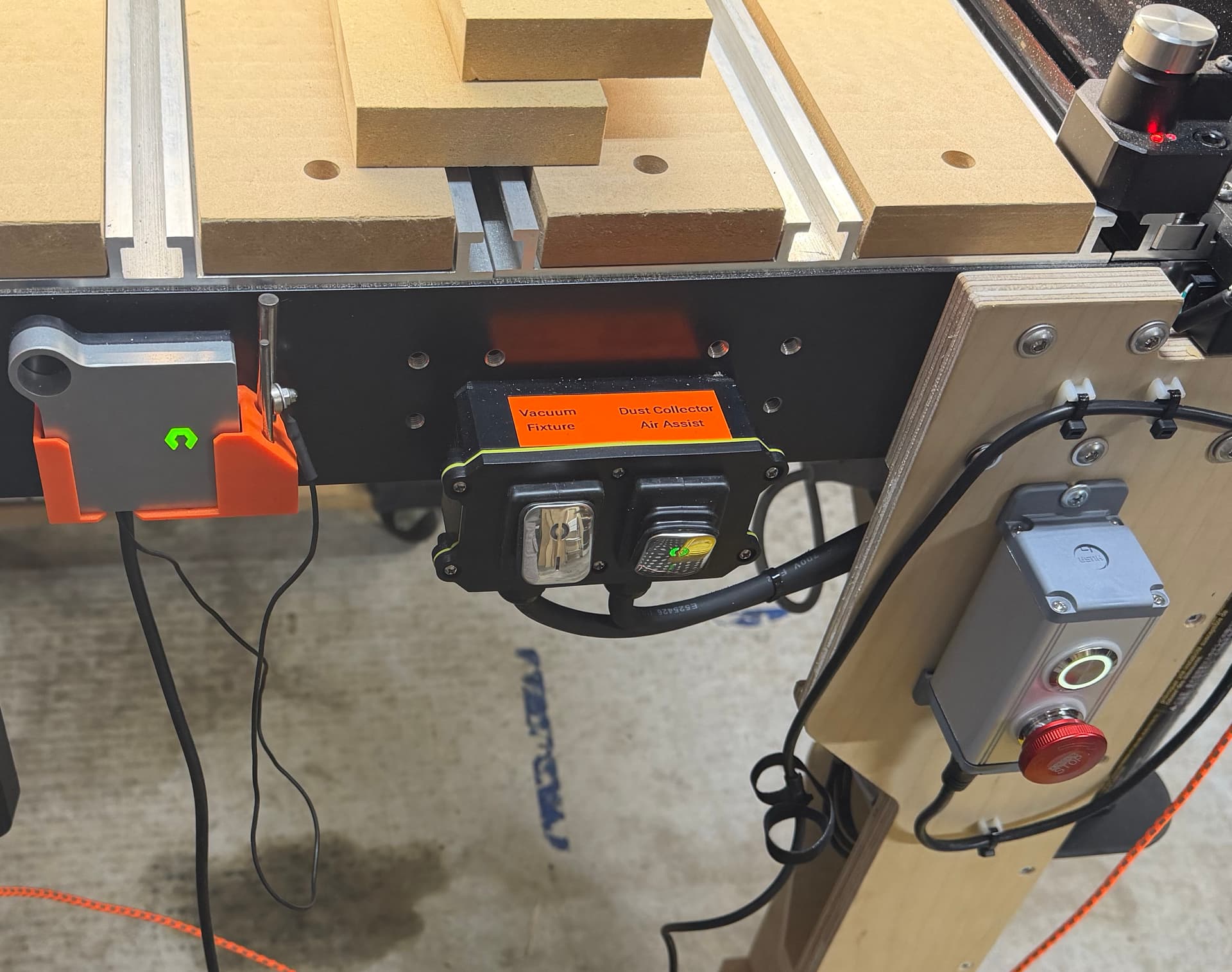

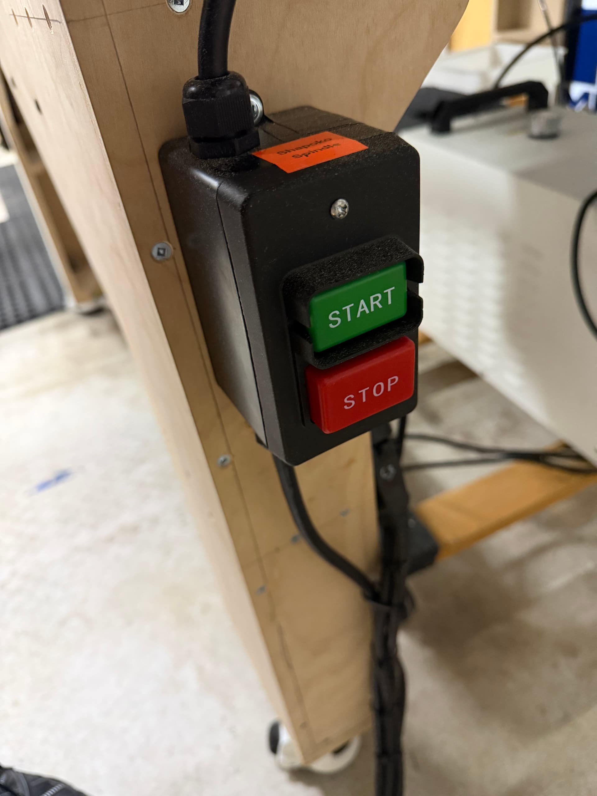

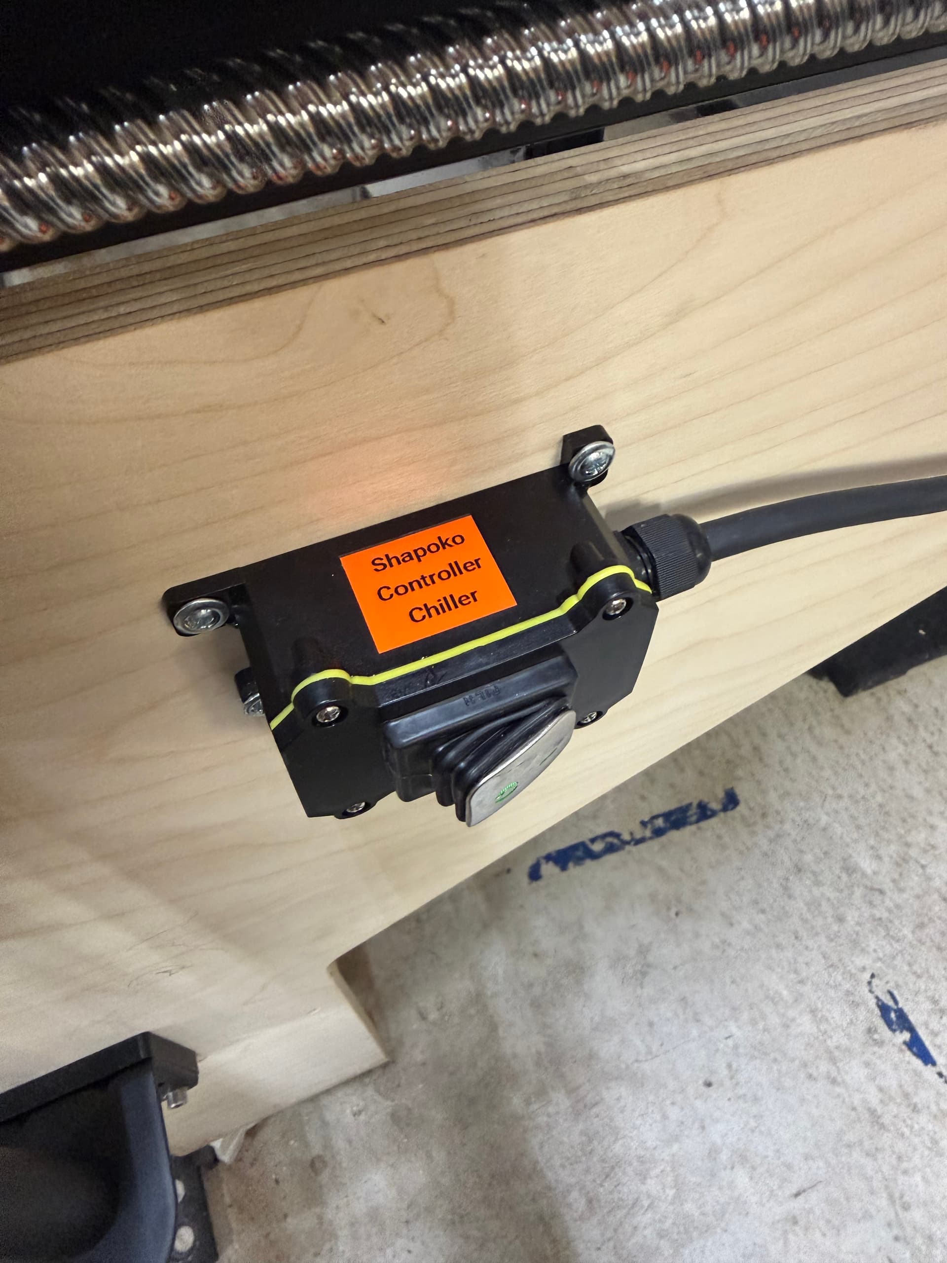

Remote control for 80mm VFD Spindle 220V
I ended up wiring 4 switches.
  • I wired the spindle cord into a switch and extended it. I mounted the switch in back on the right side as it is easy to get to.
  • Wired remote switch that controls an outlet for the chiller, and controller
  • Wired a remote switch that controls the dust collector, and a chip blower.
  • Wired a remote switch that controls the vacuum pump.
It works well for me. For those of you that don’t want to physically wire switches they make premade ones that plug in between a power strip, and the wall. Search for piggyback plug.
I have a Dustright 1250 CFM dust collector, that I pulled the remote board on, and put in a manual toggle switch.

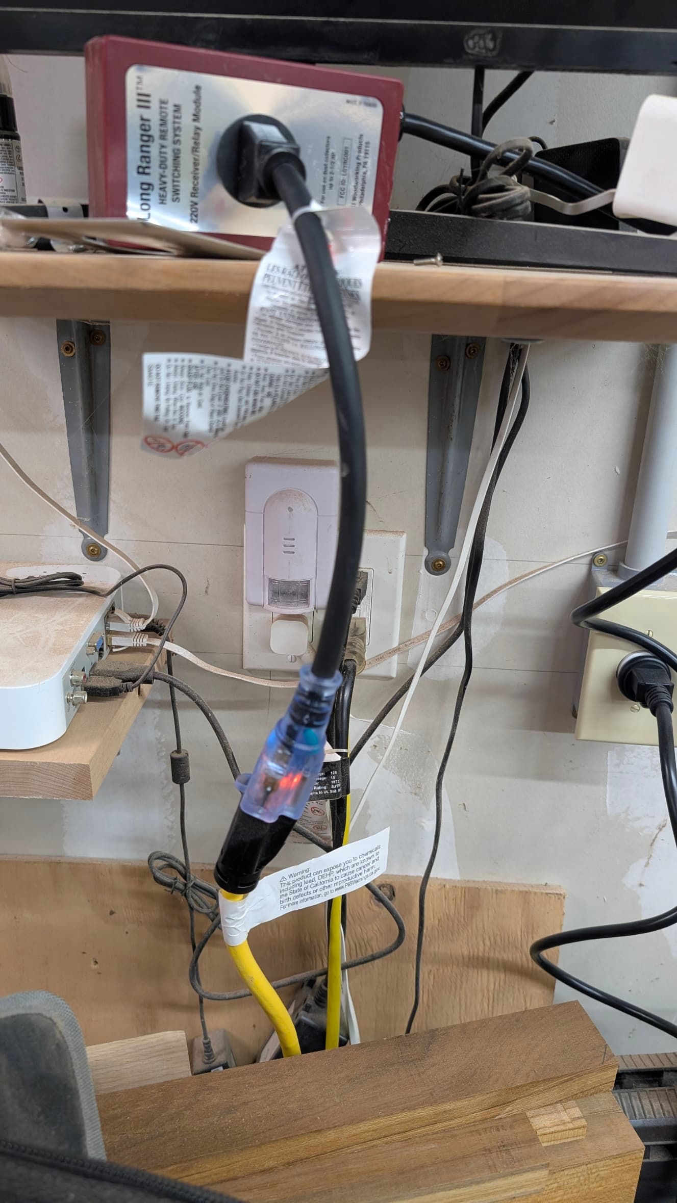

Hi Gary,
I received my remote today from Penn State and experimented with it and the VFD. So far, it’s doing what it’s supposed to do. My only wish is that they would have put some kind of indicator light on the box to serve as a visual aid if power is off or not. A couple of times, it didn’t turn off for me, but I may not have been within a line of sight and/or just too much interference between me and the control box. A visual indicator would let you know quickly if you indeed turned the unit off.
Thanks again for your suggestion!
Roy
The VFD Controller power indication scheme is NUTS. Terrible, really. Or maybe I’m inept. The lights are on at times when the unit is off… It’s very confusing. I also think it stays lit for a period of time after the power is off - and there’s something about it knowing if the Carbide controller is on also…lights are not indicative of just “on/off”. Or so it seems.
You could put an indication light in parallel with the VFD Controller and hang both off of the remote plug. I’ve thought about doing that, but haven’t gotten around to it.
Anyway, I’m glad it’s working for you. As I said, I’ve had it for a while now and haven’t encountered any glitches — but yes, it was initially confusing.
BTW: I believe the switch is not line of sight dependent…it’s an RF connection - it will work through walls. I’m not sure why you turned it off and it didn’t turn off…unless it’s that light that stays on after the unit is powered down?
You got me thinking about this … and I realize that I do still wonder when I push the button. Most times it works…but you really can’t tell. So I set out to fix it… :slight_smile:
I just ordered this from Amazon…I’ll be able to try it out in the shop on Monday. I’ll hang it straight from the Long Ranger receptacle and before the adapter to the VFD. The Long Ranger receptacle is in a place where I should be able to see the indicator light that’s built into the cord - and should only be lit when the Long Ranger is powering the unit.
I’ll let you know how it works out.
  • Gary
@scienceguyroy OK…Got the new cable and tried it out - it works GREAT. Plug it between the LongRanger and the adapter for the plug…I got a 1 foot cable, so it’s visible right next to the Long Ranger receptacle. You know it’s on when the clear plug glows red…
Thanks, Gary! I went ahead and got one, too. Seems like it’s what I needed (although, I’ve only used it one day).
