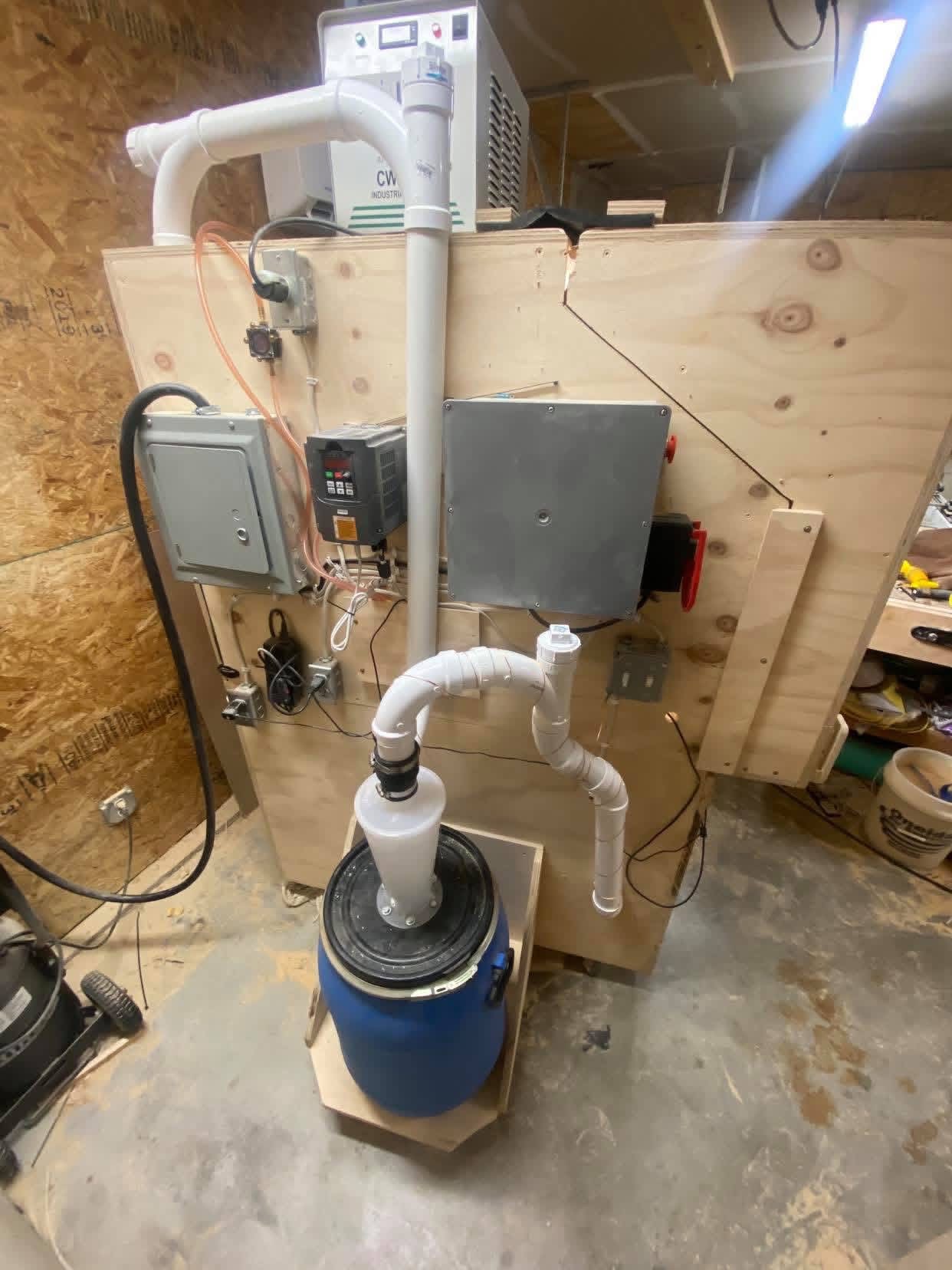

I don’t currently use the setup. But. I had a rockler switch that controlled a 4 pile relay with a 110vac control coil. So if the rockler switch supplied power to the relay it was on. I used two polls for my 2 hot legs of the 220v. This is for the spindle and the chiller. I always match chiller voltage and spindle vfd voltage so they can be on the same switch and I don’t have to remember to turn the chiller on.
I used m the other two legs for separate 110v circuits. One was dedicated to the the cnc controller the other had the built in shop vac/ dust collector on it, lighting in my enclosure , and a solenoid valve that turned air on and off to the enclosure.
One switch. Everything activates.
I had a small sub panel I put in the enclosure to power it all that plugged into a 240v 50a outlet I had in the garage shop for a welder. It was all built this way because I knew I was moving. I unplugged it, disconnected air and rolled outt the garage door onto a trailer and set it up at the new house the same way for a while.
It was a nice setup.

It was a nice enclosure for the smaller xxl especially in a subdivision having to regulate noise. Now that I’m in the middle of nowhere with. Shop 4x the size I much prefer no enclosure and I can walk around it to get to things.
