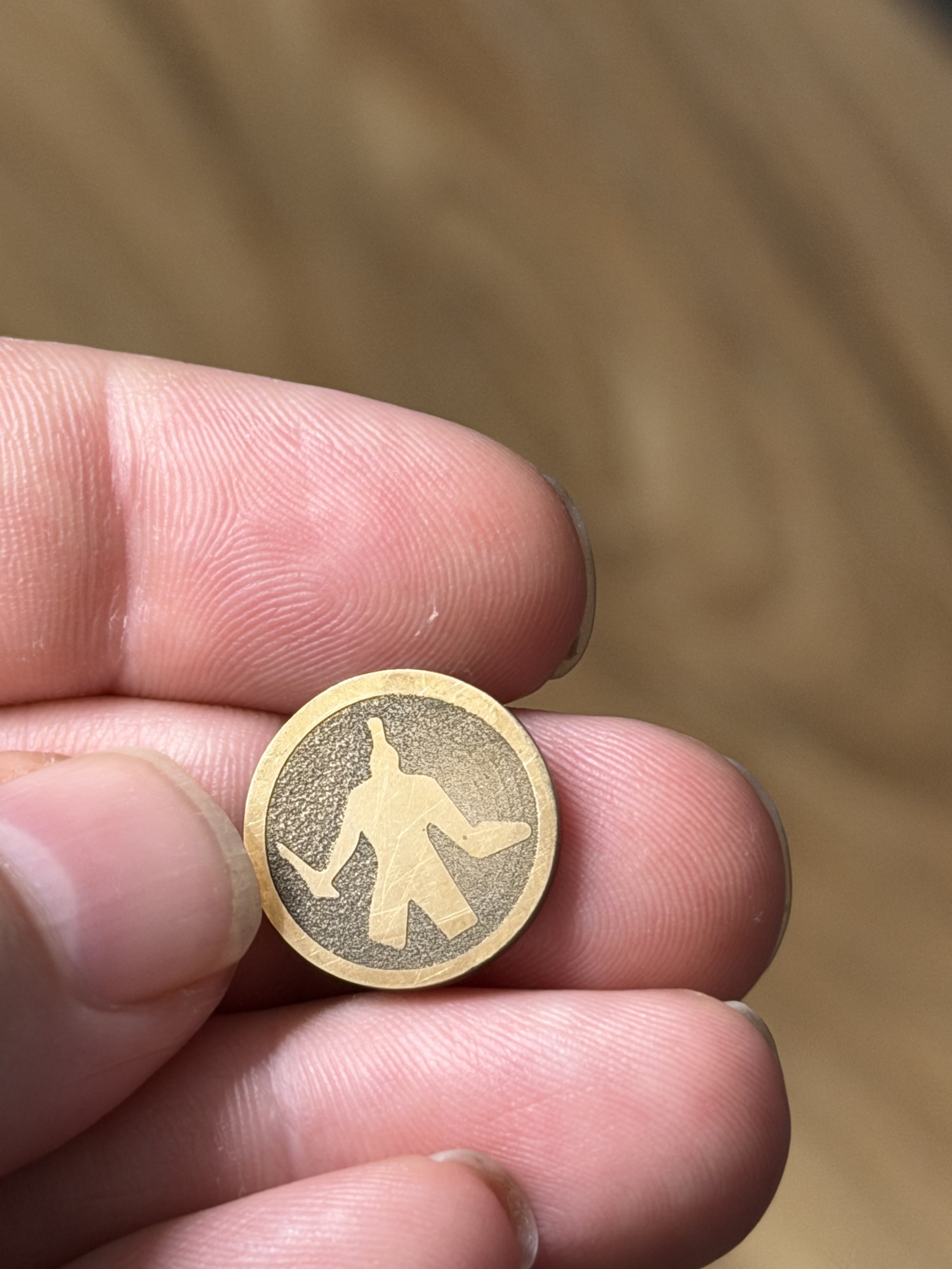

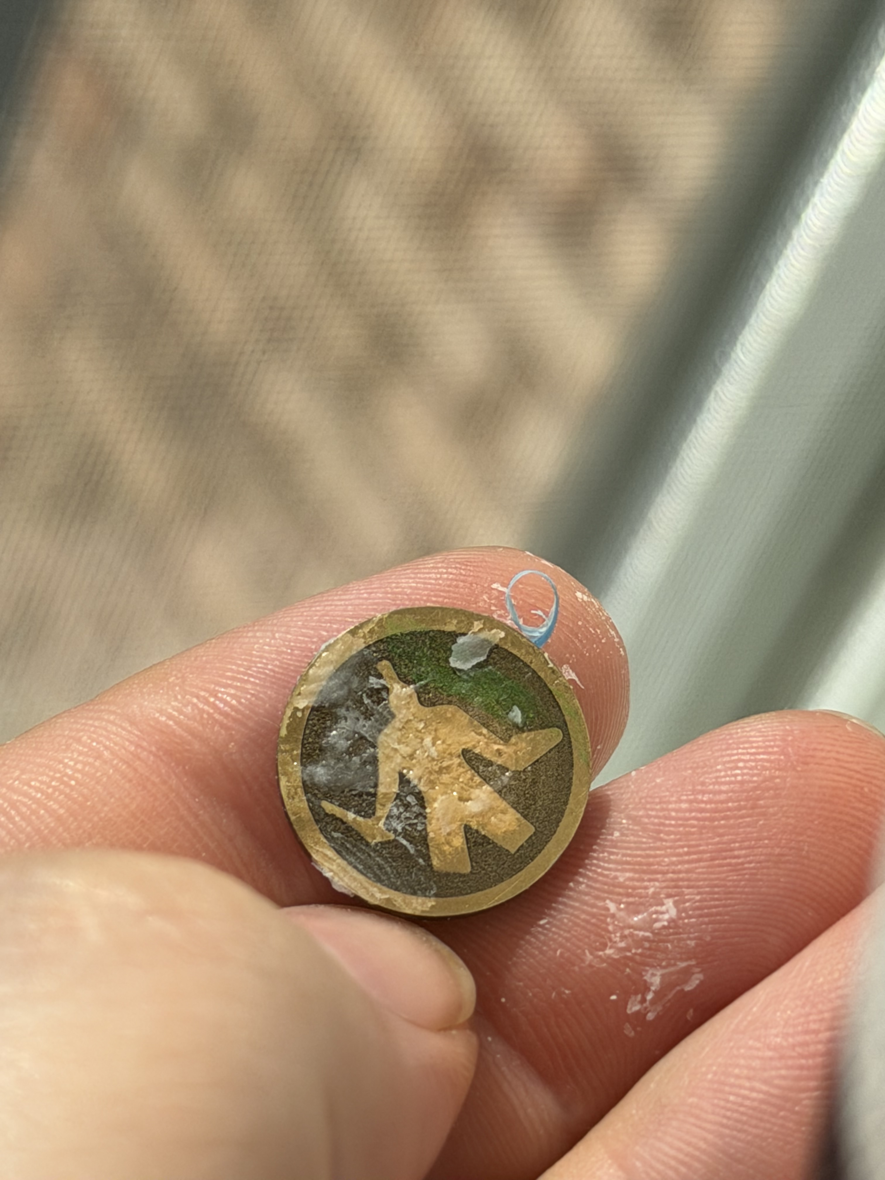

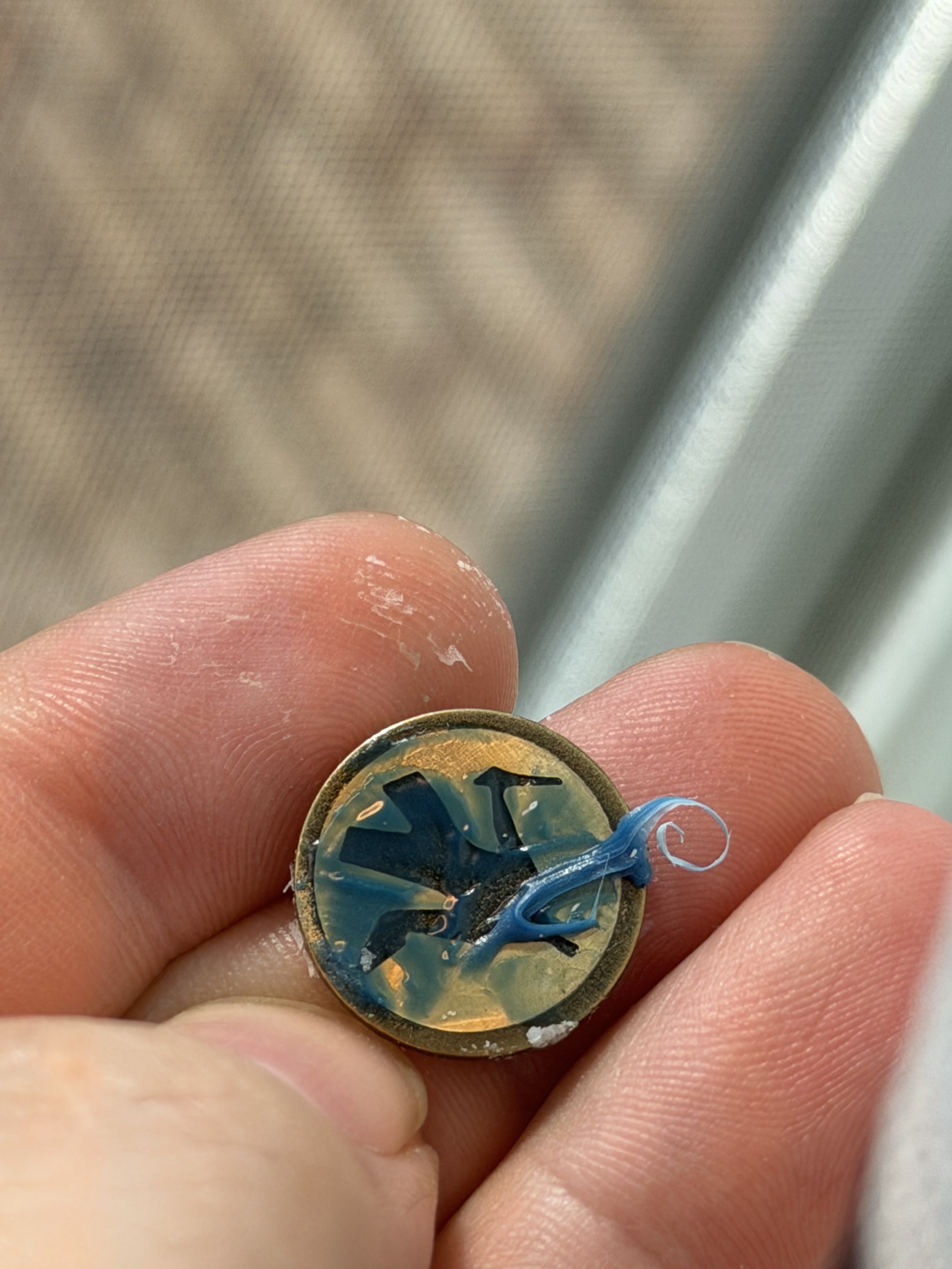

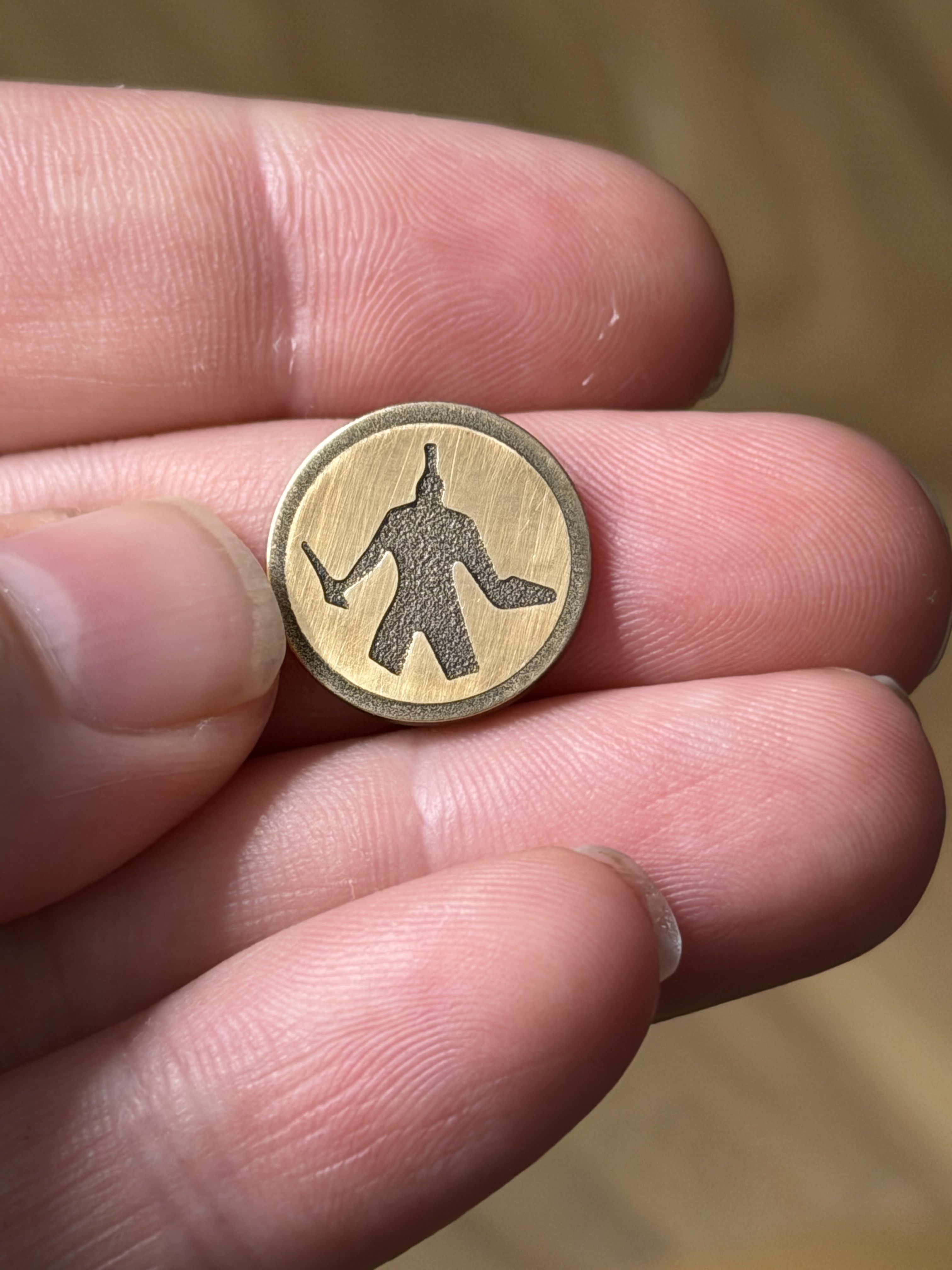

Got distracted for a day but can confirm, the wax remover works well on the carbide blue and white wax. I just globbed some of each on a piece of scrap, let it harden, and dropped it in the remover at room temp for a day (goes much faster in a heated ultrasonic)
Before:
After:
Cleaner than when it went in :+1:
