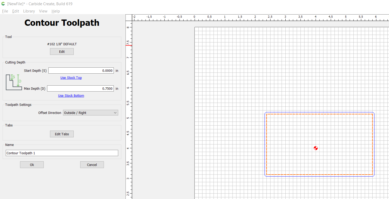

However: I’m noticing that with the current version (and possibly some v6 prior), the tabs are not visible on the diagram after the Edit Tabs dialog closes.
On V6:
Click OK:
Tabs are no longer visible.
On V5:
Press OK:
Tabs persist in the diagram. In fact, even after the Edit Toolpaths dialog is closed:
Tabs are visible.
Bug in v6?
Seems like it, I suspect it’s been in V6 from the start. Let me take a look.
EDIT: Found it. It’ll be fixed in 620.
