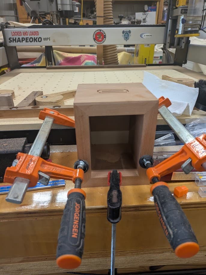

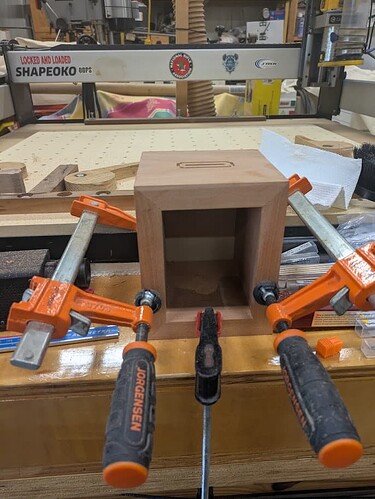

Like @Ed.E I removed my feet. I have an XXL and they tend to sag in the center. By placing a piece of rigid foam under my SO3 XXL my machine stays flat. Additionally I have a torsion box under my SO3 but that is not necessary if you have a solid platform for the SO3 to sit on.
Here I am cutting off the front of the machine. You can see my torsion box. On the top of the torsion box is a piece of foam from Lowes and the SO3 feet are removed.
If you have a standard or XL it is likely you dont need the foam but an XL is the same width as an XXL so it could sag. I think it reduces vibration and gives a solid base for the machine to sit on.
