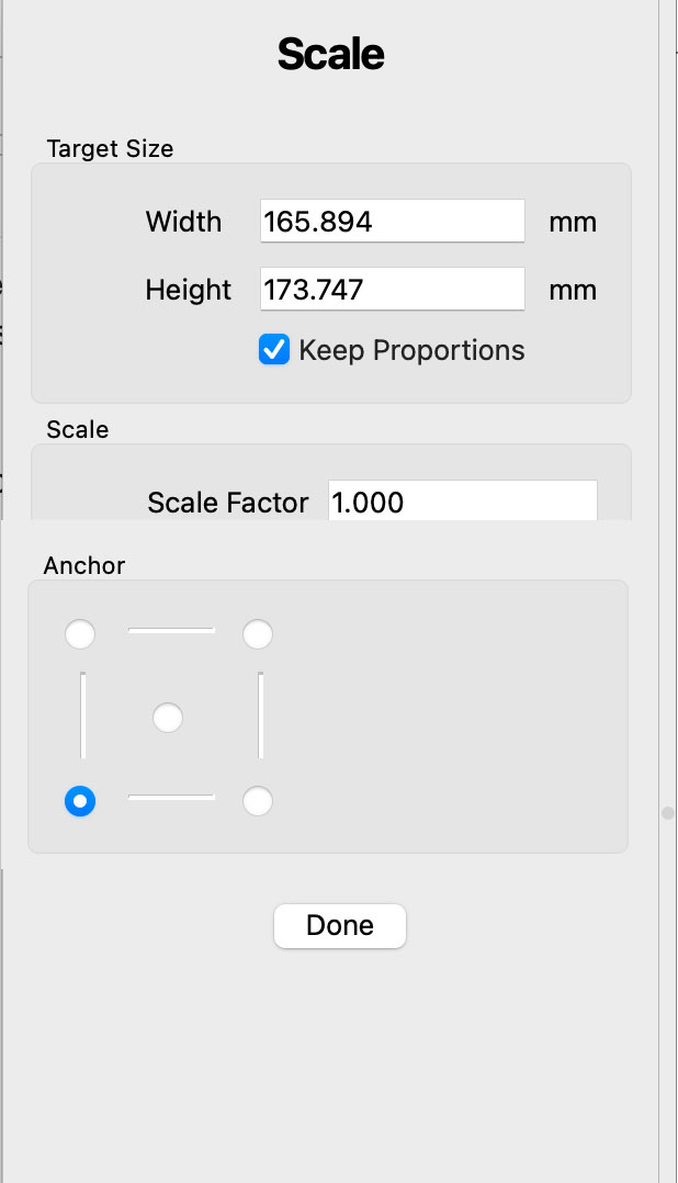

When resizing or scaling, the object size always changes about the center of the object.
No matter what point you pick, it will work for some scenarios and not others. Center is at least easy to explain and makes the most sense for circles, at least.

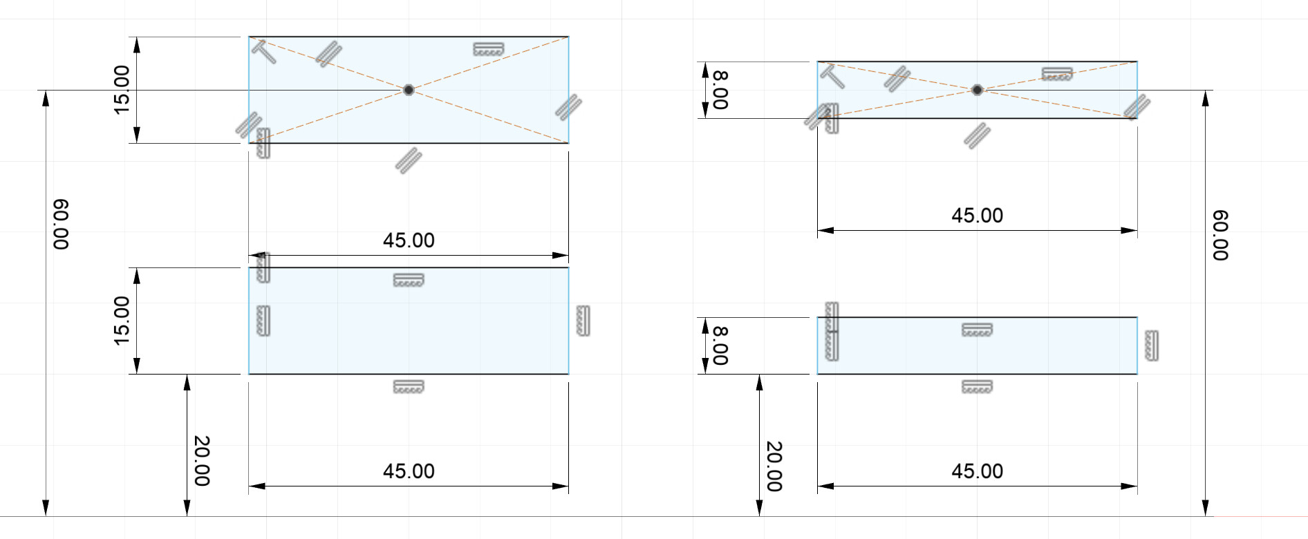

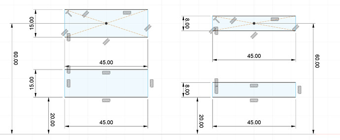

That may be how Carbide Create does it, but it’s not intuitive nor as practical. Here’s how Fusion360 does it:
Two identically-sized rectangles. When you change the dimensions (NOT scale), you see what stays put. And the nice thing is you can dimension whatever you want and whatever you dimension stays dimensioned. So you can even fix the lower left of the center-created rectangle, if that’s what you want. But, with CC, I’m stuck with center definition even when I don’t actually know where the center is, and especially don’t want that maintained when resized.

Carbide Create started out with everything being done from the center and this apparently is a legacy of that — it may be that it will change in a future version — if you want that, put it in as a suggestion at:
OK, decided to file the request. Here:
