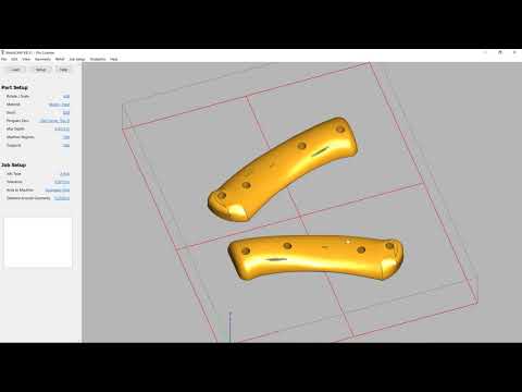

Note that MeshCAM is now available bundled w/ Atom 3D as “Workshop”:
which is now bundled w/ the Nomad.
