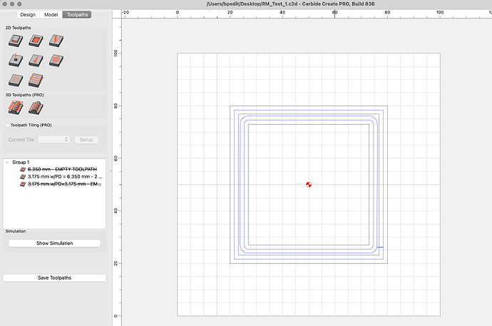

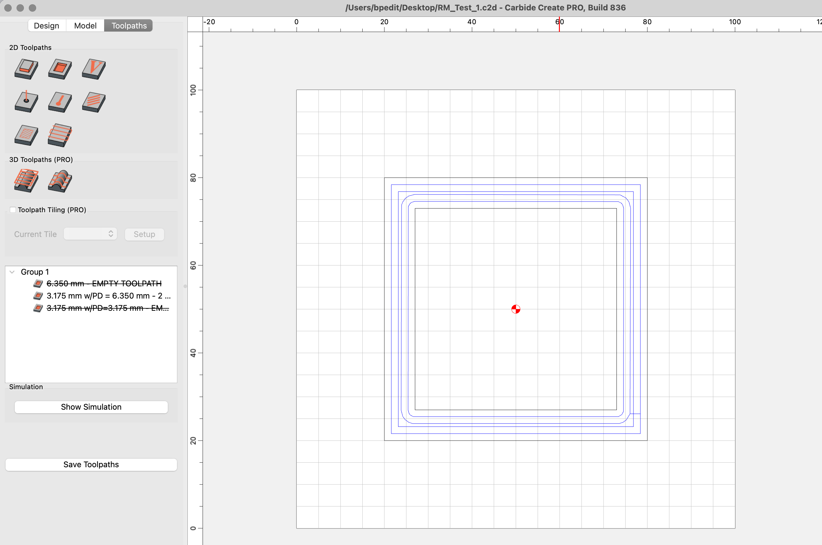

If you pocket a square and want to sharpen the corners, Rest Machining (RM) appears to work as advertised. But with more complex shapes that’s not true. In those cases you set the Previous Diameter to the diameter of the bit you are currently using.
Check it out:
RM_Test_1.c2d (44 KB)
If your version of CC acts like mine you will see the active toolpath, using the actual Previous Diameter, cut the entire pocket versus just the corners.
Disable that and Enable the bottom toolpath which uses the smaller bit as the previous diameter. This one cuts only the corners as it should.
I saw no mention of this being remedied in the version logs. Perhaps I missed it, let me know how this file looks in your version of CC.

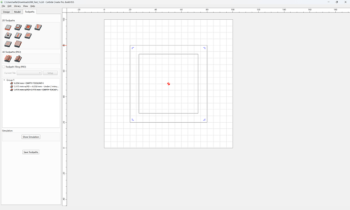

The bit -size problem for Rest Machining appears to have been fixed. No anomalies using build 843.

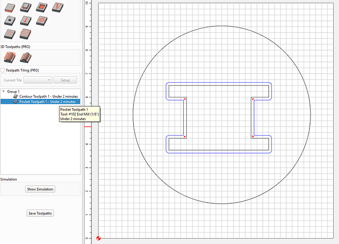

You can use a pocket with rest machining after a contour. If it’s a outside contour, just add a vector around the geometry that won’t get rest machined…
Where rest machining would be a big improvement is V-Carve, and maybe 3D

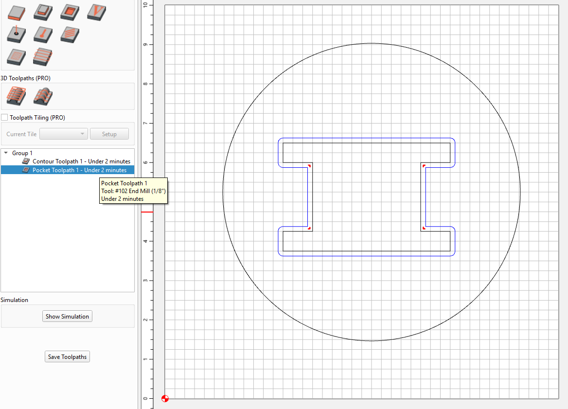

I believe this is what you wish to see?
Yes. Here is how it appears to me:
So I guess that was fixed. I had looked for that in the version logs but must have missed it. I gather you’e running the latest stable version?

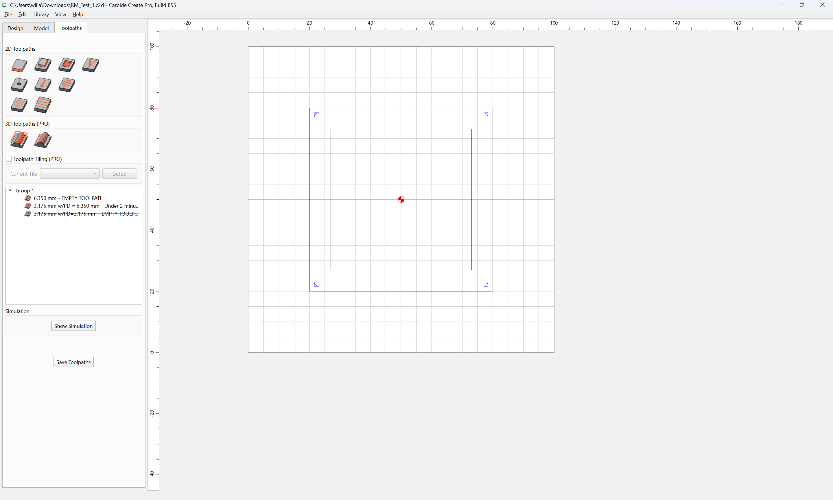

Current beta, 855:
(on my Windows machine, still need to replace my Mac so I can be up-to-date on it)
