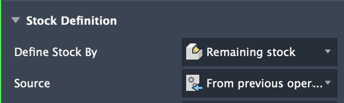

I could run the 3D Adaptive twice. The first time with Stock To Leave and the second time with:
If proper Optimal Load, max DOC, etc. could this be considered a finishing path?
I suppose another question is what other toolpaths have this “Define Stock By Remaining Stock” and “From previous operation(s)” option? Seems like any of those could be potential finishing toolpath candidates, right?

Well, to answer my own question: The 2D versions of the Pocket and Contour toolpaths do not have the REST option to be based on prior toolpaths, but the 3D versions do. From watching some more videos (and the NYC CNC “Fusion Friday” ones are pretty good), what I’ve learned is that the 2D toolpaths are not just for 2D profiles (floors and walls), but that the 2D toolpaths require you to choose what to be milled. The 3D toolpaths, by default, determine on their own what to mill, and then you can remove areas/walls. The 3D process re-constructs your model as a whole bunch of tiny triangles and builds the toolpaths off those triangle (hence the tolerance and smoothness options), AND it’s that triangle building that enables these 3D toolpaths to also perfom the “from previous operation(s)” REST machining.
TL;DR - Using 3D toolpaths gives me the Adaptive followed by Pocket and Contour toolpaths without air cutting that I want.

The sequence I’m going to try today is:
  1. 3D Adaptive, with some Stock To Leave both radially and axially
  2. 3D Contour, REST on, Stock To Leave only for axial (to not touch the floor)
  3. 3D Flat, REST on, Stock to Leave only for radial (to not touch the sides)
I expect this to leave the slightest of fillets where the sides meet the floor. The size of the fillets will be the Stock To Leave amounts.
