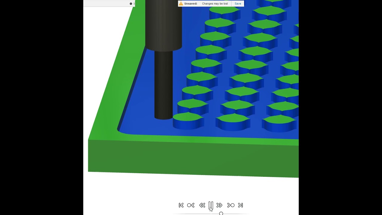

Now I’m not quite sure what the problem you see while running the file is, since the toolpath does do a contour toolpath around the stud,
After shaving off the perimeter of the stud, the tool cuts a small depth into the floor around the stud:
is this the problem you are referring to, or do you see something different happening when actually running this on the machine ?
That. Imagine the cut your just animated being 3mm to the left with the rightmost of the contour cut going about 1mm into the stud. You can see the sheer here.
