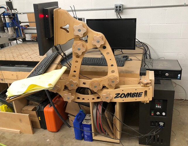

May I ask you to post some pictures of your upgrades?
This is the Closed-Loop kit that I have.
These are the only pics I have on my phone of my machine. They were from back when I was puting it together. I’ll get some more tomorrow.
I modified what @DanStory did and upgraded it to ball screws.
After seeing what @CNCInspiration did with his machines I changed my design again.
I’ve got all the extrusions, new closed loop steppers, and the ATP5 plate for the end brackets. I just don’t have the time to do it.
The control box that took me forever to build.
Just to compare a nema23 to a 34.
Not much different that the assembly picture. I’ll get around to the drag chains and cable management some day. But for now this works.
