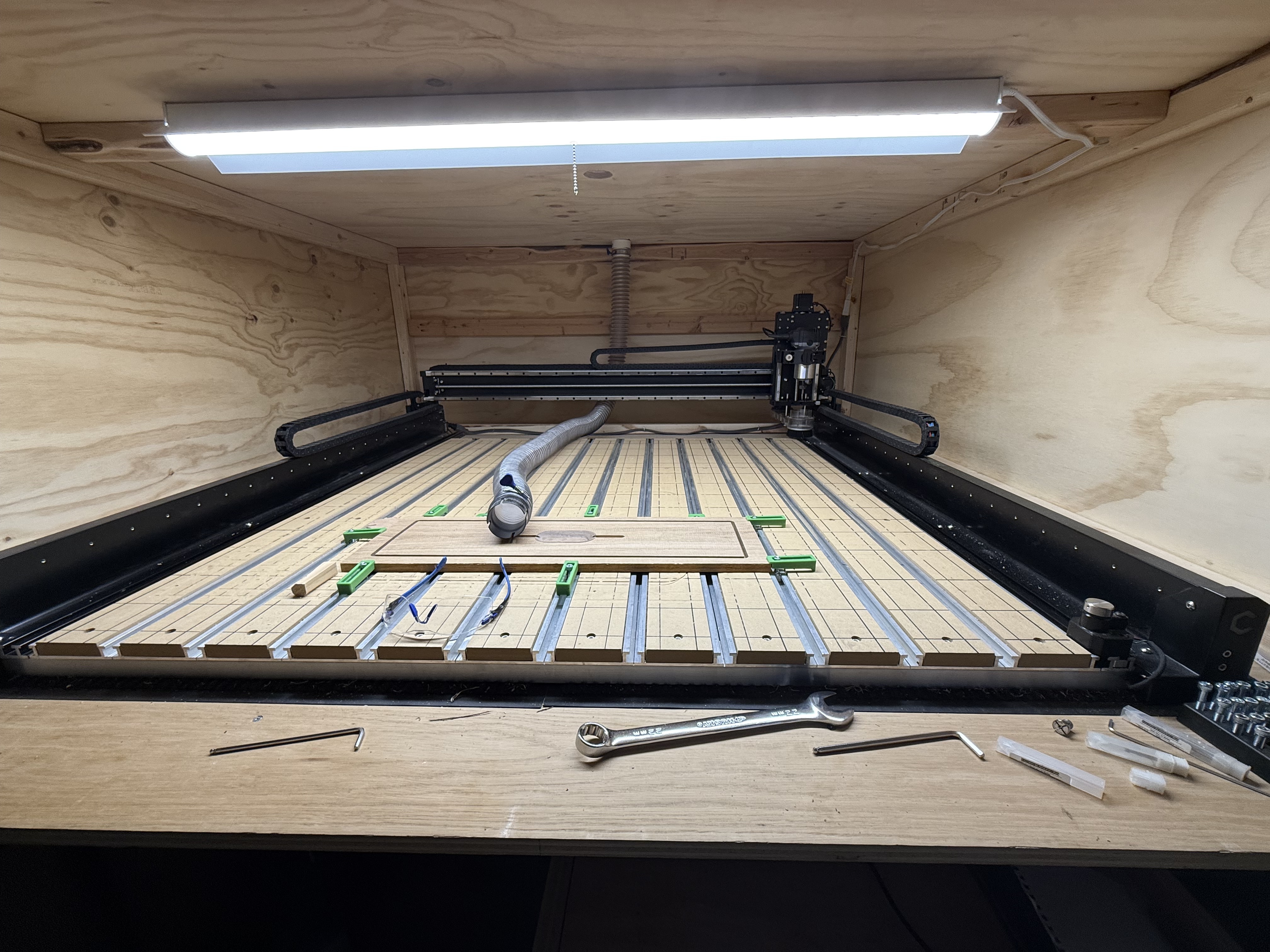

I failed to mention that the other issue is that because of my limited space that the vacuum hose on the sweepy pro will often get jammed up behind the machine and cause it to crash. And it usually will jam in such a way that it is not possible to reset the machine as it gets stuck between the gantry and the NE corner of the machine.
So on the prior versions of carbide motion when the cutting process stopped I could turn off the router and then remove the vacuum hose before shutting down the Shapeoko.
I know this is probably not a problem for which you can suggest a fix.
Photo of your enclosure?
Set up an arm or something similar to control the hose?

An arm cable suspension is something I’ve thought about but in terms of practical idea my engineering imagination is a somewhat limited.
So I am open to ideas
If it were me I would do what Ed.E uses or plug my router into a receptacle and turn on/off with a standard 15 amp light switch. Turn you router switch on, then plug it into a switched receptacle. Mount the switch wherever you want.
