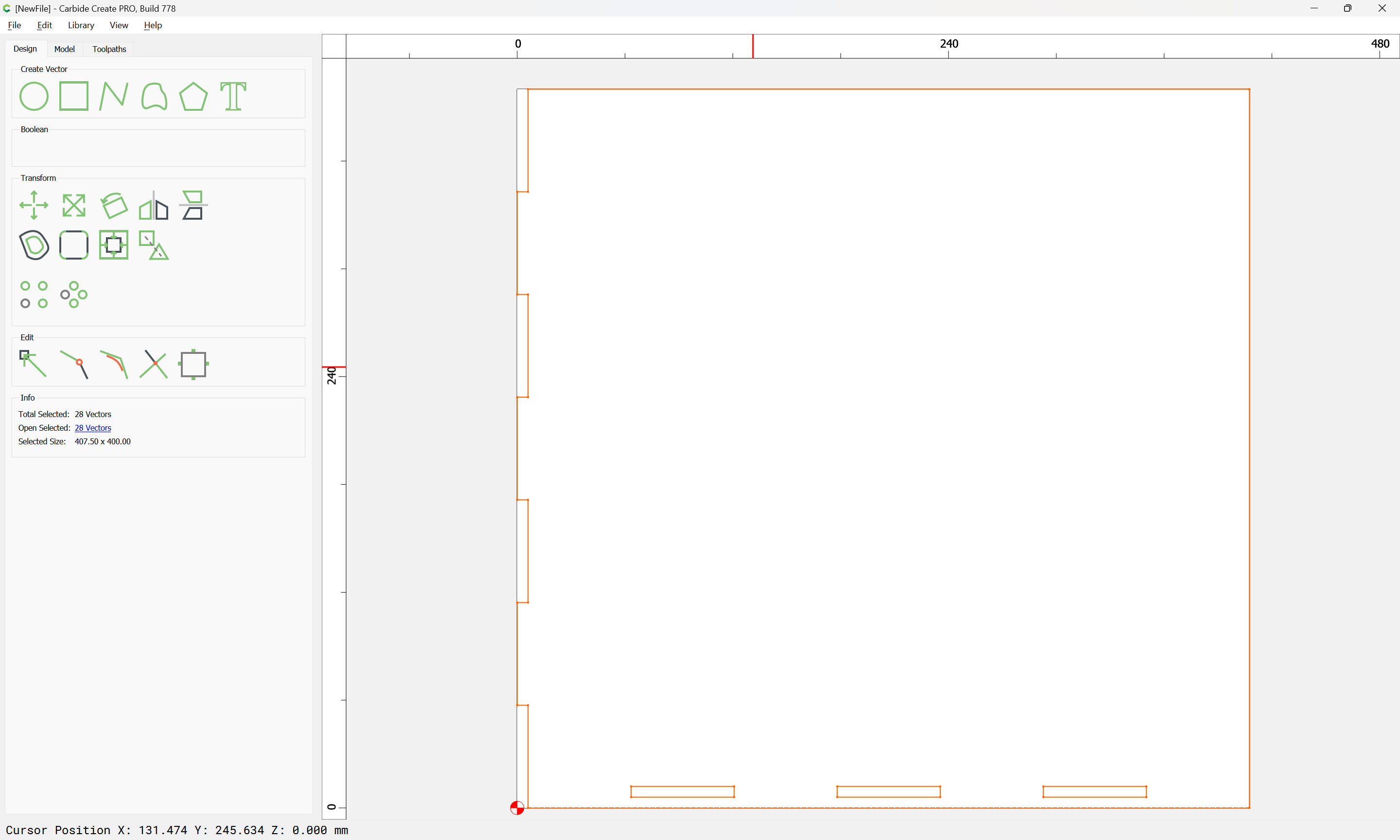

Hey Guys,
When I export my 2D drawing from Rhino 8 to Carbide Create as a DFX it imports at a tiny scale to the point where you cannot see the drawing. When I export from Rhino as an SVG file the measurements also aren’t accurate as per the original file in Rhino 8.
Does anyone have a workflow from Drawing in Rhino 8 to Milling in the Shapeoko 5 Pro?
What file type and settings should I use when exporting my drawing from Rhino?
2. 16MM MDF SIDE TABLE PROTOTYPE (LEFT).dxf (38.7 KB)
If you measure something when it first comes in to CC, and compare that to the known measurement in Rhino, is the difference 1:25.4 ? If so, you are saving the .dxf in inches, and importing it in metric (mm). Can you save the file from Rhino in metric?

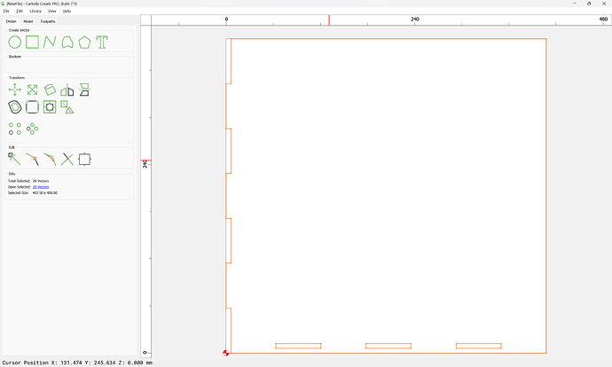

OK, the .dxf looks like it’s already in metric. But the design comes in a long way from the origin so it messes up the scale/zoom. I don’t know Rhino, but you should be able to save it with the origin in the lower left corner of the design some how.
2. 16MM MDF SIDE TABLE PROTOTYPE (LEFT) fixed.dxf (187.2 KB)

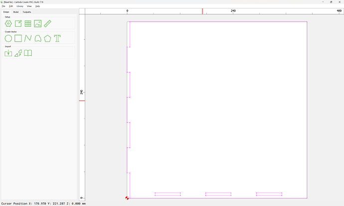

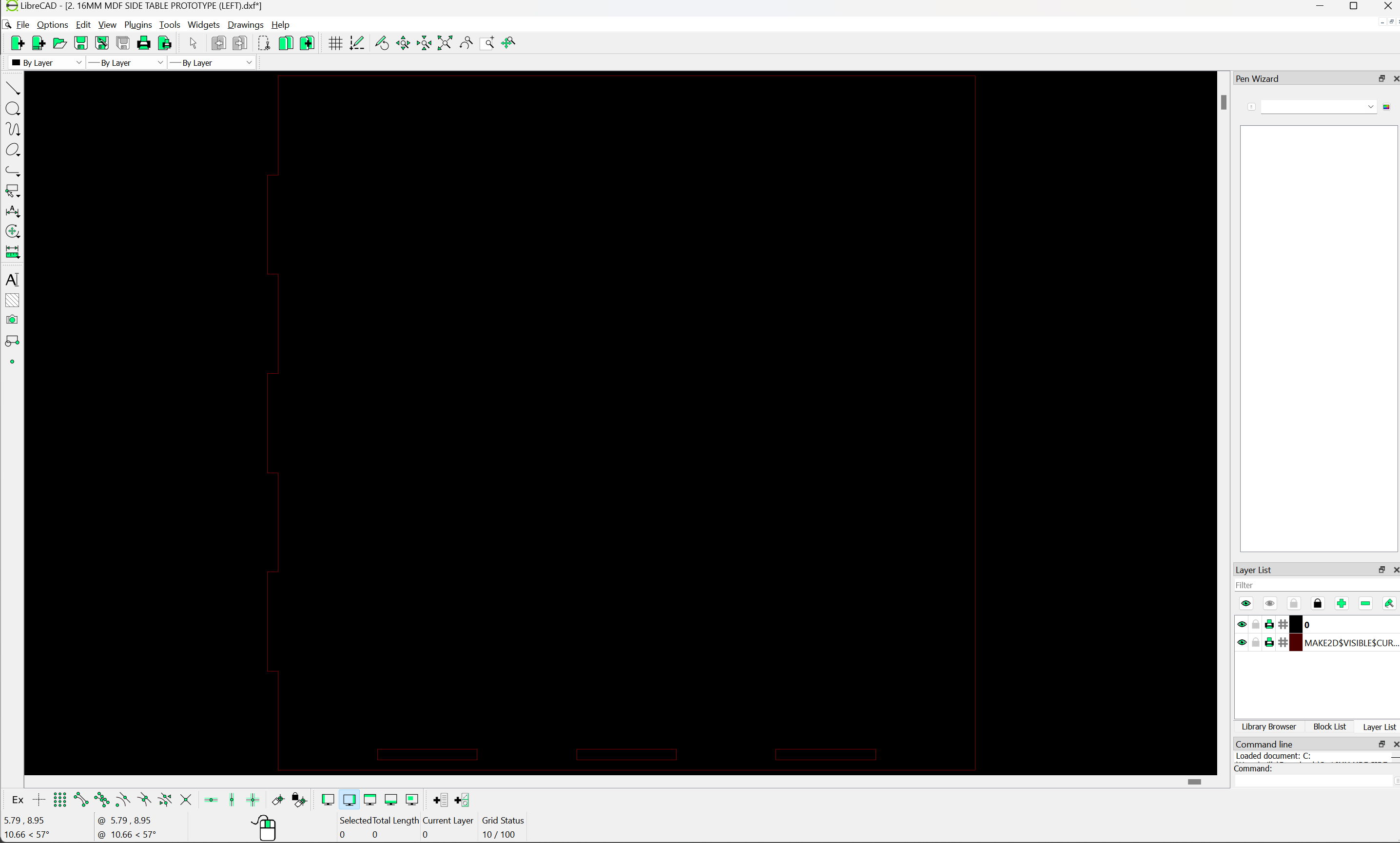

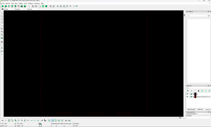

On support I’ve found that problematic DXFs can usually be made to work by opening them in LibreCAD and exporting them as SVG files:

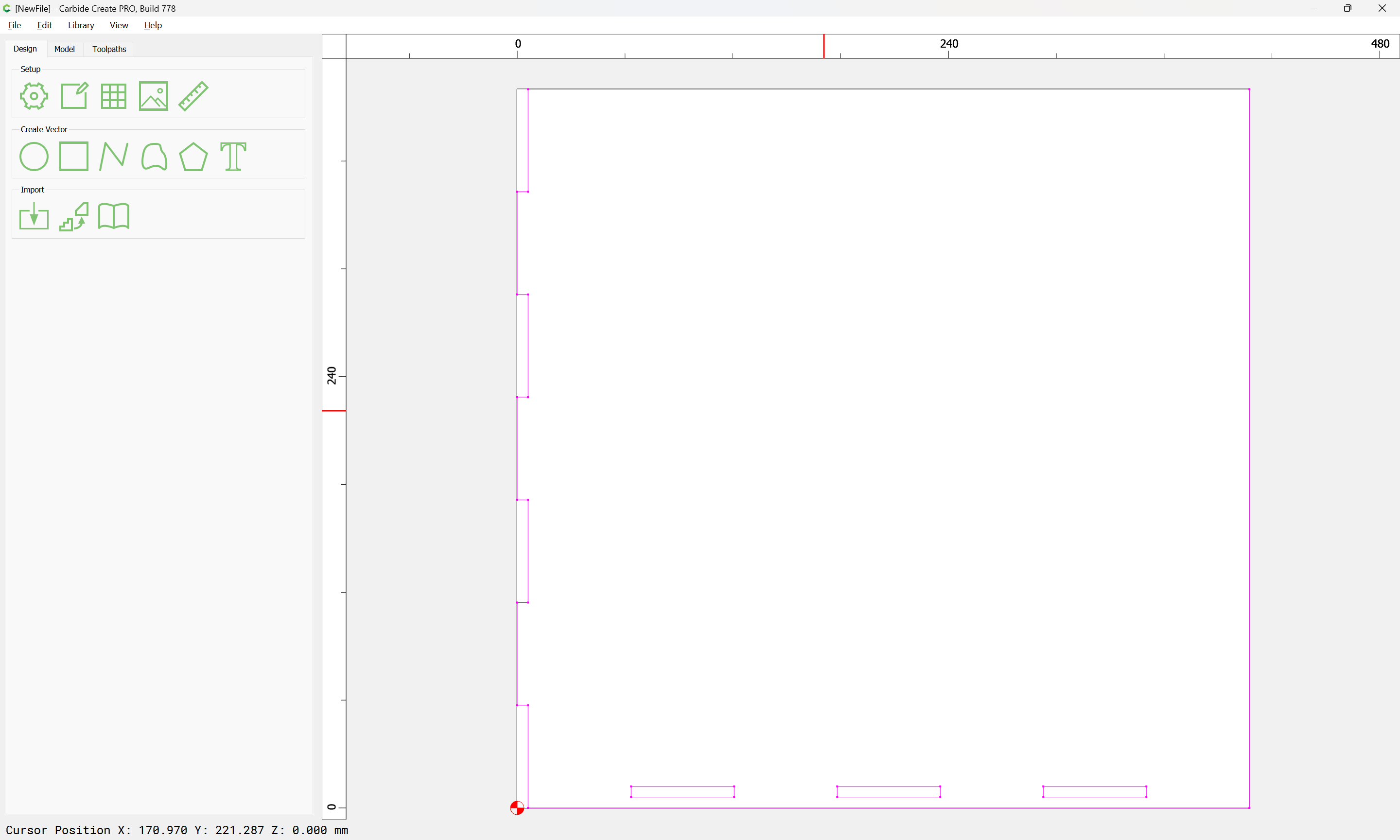

which will then import as expected:
