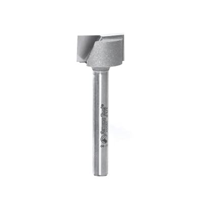

I have had similar problems. Two things I have done to completely eliminate the ridges I was getting.
- Flatten the spoilboard - I put an additional 3/4 MDF spoilboard on top of the factory spoilboard and taped it tightly to the original. Then I flattened it with a 3/4 flat bottom router bit using a pocketing patch for the machine cutting area. I had horizontal lines across every run of the process indicating the router wasnt square. Sure enough, it wasnt.
- Squared up the router to the new flat spoilboard.
- Re-ran the spoilboard flattening gcode and now it is a smooth as a baby’s but.

Thanks for sharing your experience, do you have a link to that 3/4 bit you used to surface? I’m going to work on a new spoil board soon.
Thank you for you promptness
When you surfaced the spoil board, how much did you take off with the pocket?
It really depends on how uneven you think it is. The first pass i took off .02 inches. Mark your board off with pen or pencil lines so you can see that they got removed. At this point I saw the uneven lines. So I squared my router and only took off .01 the second time. I could have actually taken off less that that but that is what I did.
What did you do to square the router? Adjust it within the aluminum holder? Or did you put paper or some other spacer in part of the holder to adjust how it sits? Thanks.
I ask partly because I’ve been frustrated with the MDF wasteboard not holding threaded inserts well, absorbing too much cutting oil, bowing, and all the general reasons that MDF is annoying. I’m considering getting the Carbide aluminum table (which I know is pricey), but naturally I wouldn’t want to then try to cut a pocket, so I’m hoping to get the router as perfectly square to that surface as I can.
Verified how it was out of square and by how much. Then I put in two brass washer shims between the router and mount to square it to the spoil board
